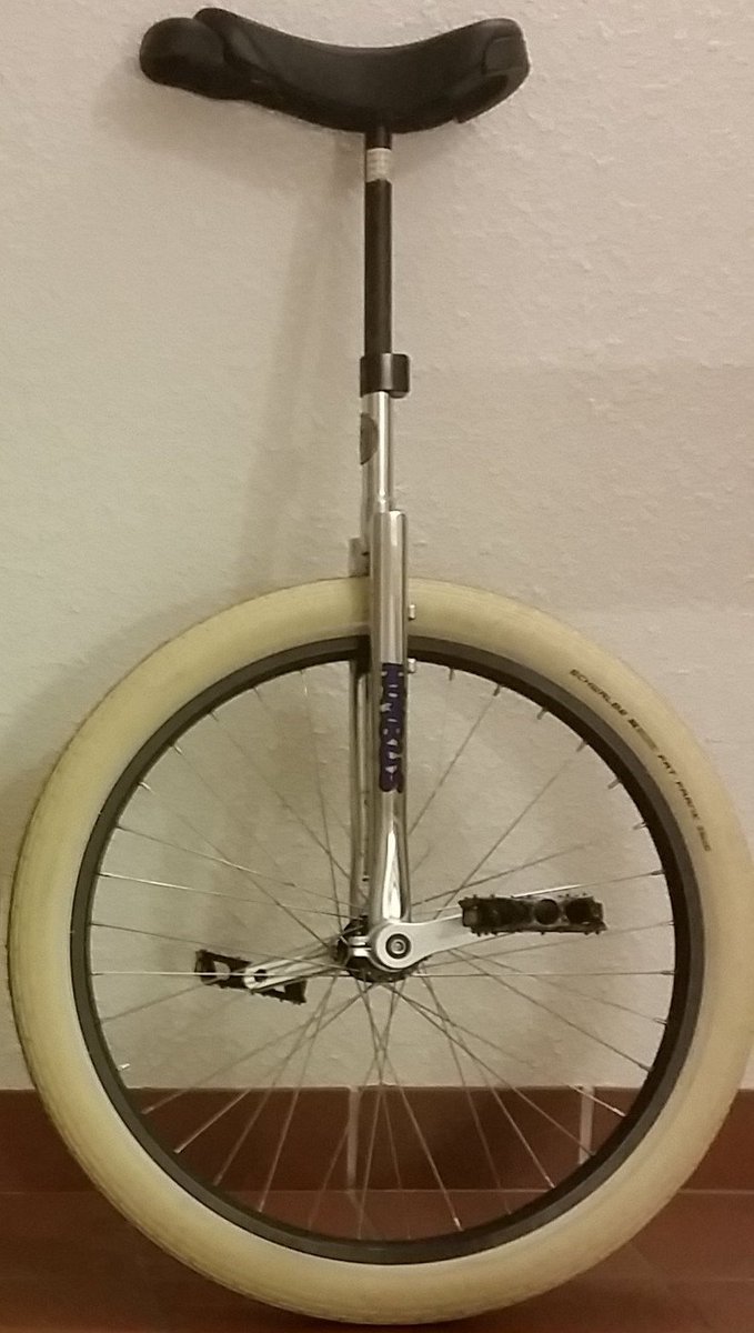

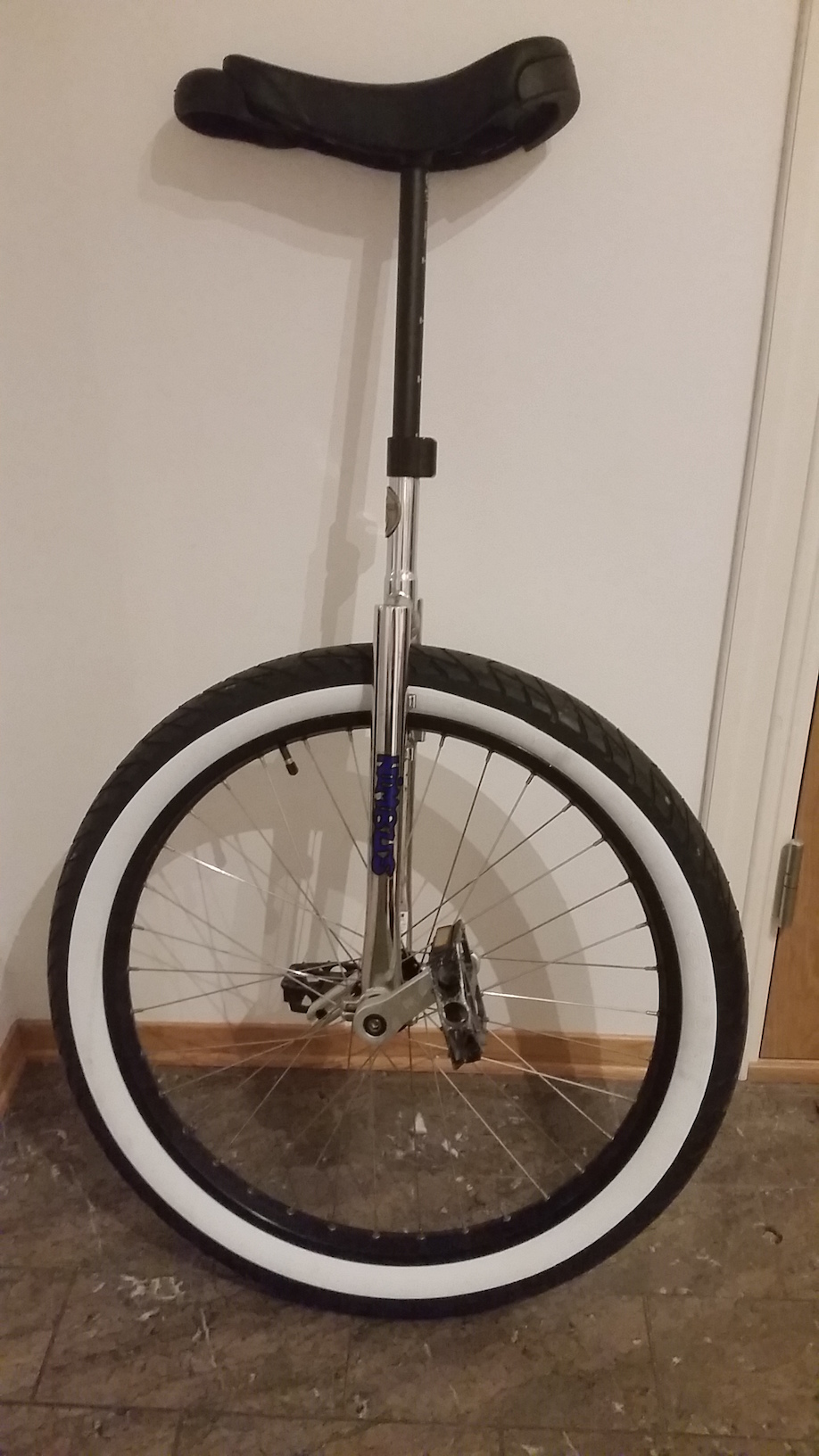

    For the sake of completion, here is how it looks
    Here is a previous photo with the Fat Frank for comparison (yes I also changed the seat post since then)
    Shame because it has a pretty nice look for sure!
