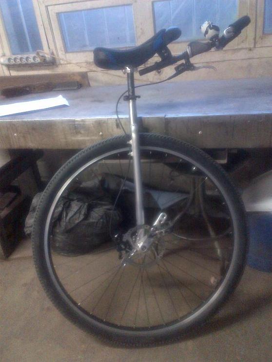

KH SPIRIT 3 holes cranks 110 / 127 / 150mm

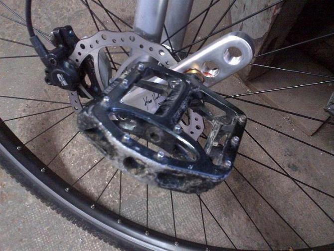

I updated my KH36 with KH disc on SPIRIT cranks and Nimbus D-Brake, but I wanted cranks with 3 holes at 110, 127 and 150mm in order to avoid crank changes as it’s not so convenient with the disc on the right crank :frowning:

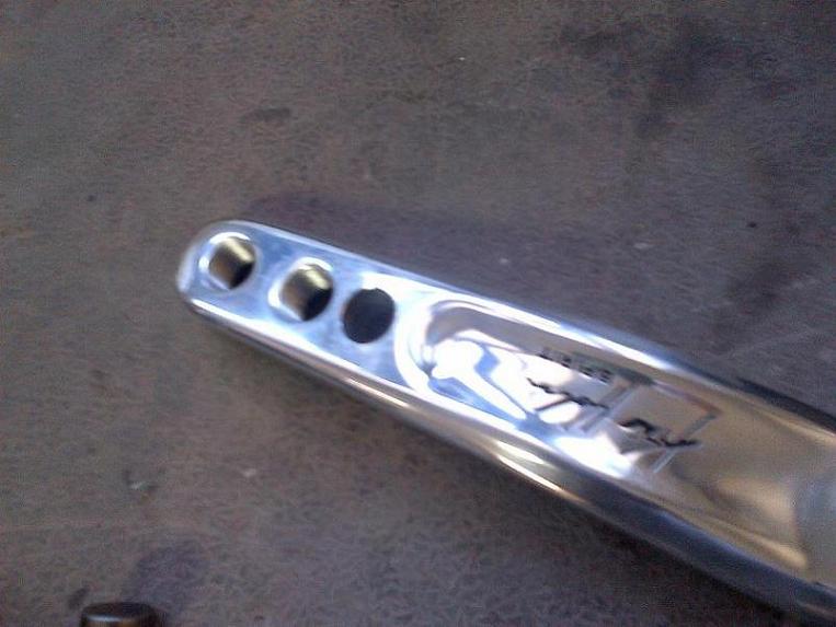

As Kris doesn’t plan to make such cranks even if no technical issue as forging tool is the same for all SPIRIT cranks, I did my own 3 holes cranks based on 127/150 SPIRIT cranks :o

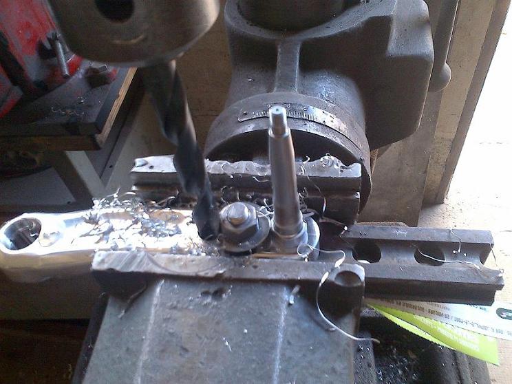

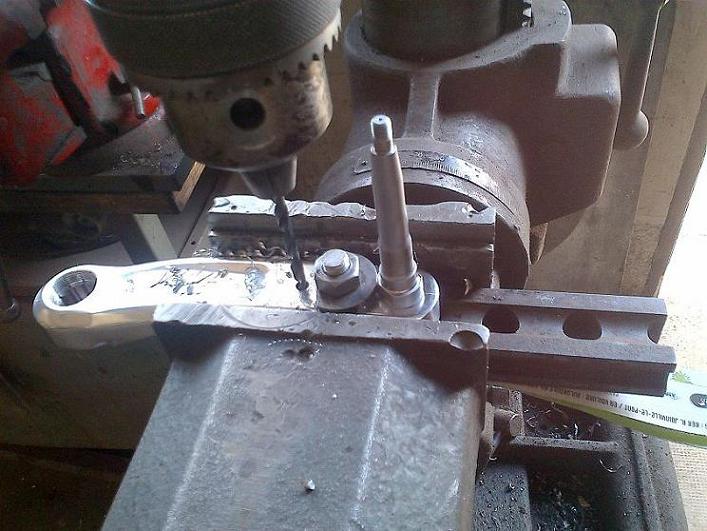

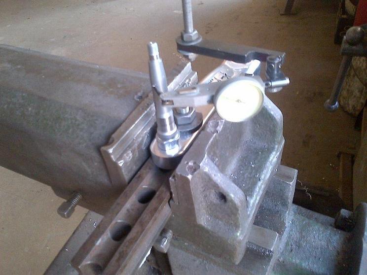

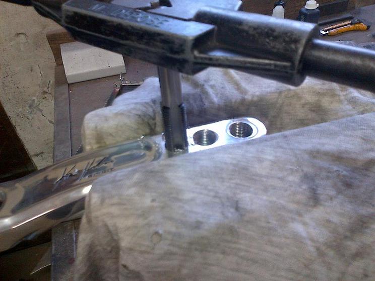

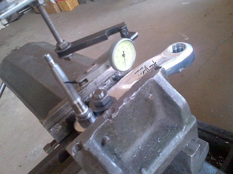

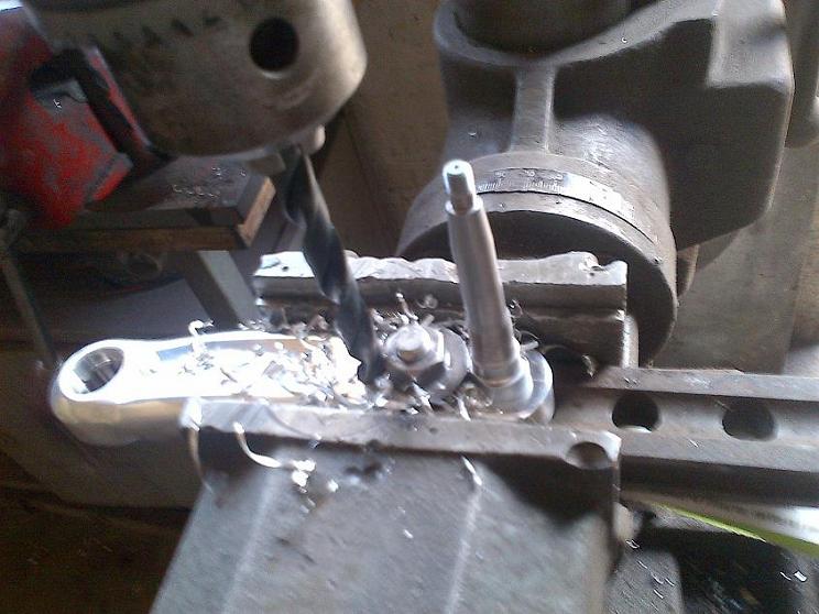

Most difficult was to fit the crank at the right position. I used a pedal axis and an indicating caliper fitted to the pillar drill in order to adjust the position. Then drilled gradually to 13mm and tapped holes with 9/16 20TPI RH and LH taps.
:wink:
Very nice work! But a more even spacing might be 150/130/110. But You’d have to start with the single hole 150 to get that spread.

I got taps from WWW.RDGTOOLS.CO.UK, these are not HSS steel but this is enought for aluminum
REF DESCRIPTION QUANTITY PRICE COST
1214 9/16" X 20TPI CYCLE THREAD 1 £9.13 £9.13
TAP SET
1789 9/16" X 20TPI CYCLE THREAD 1 £9.96 £9.96
TAP SET “Left Hand”

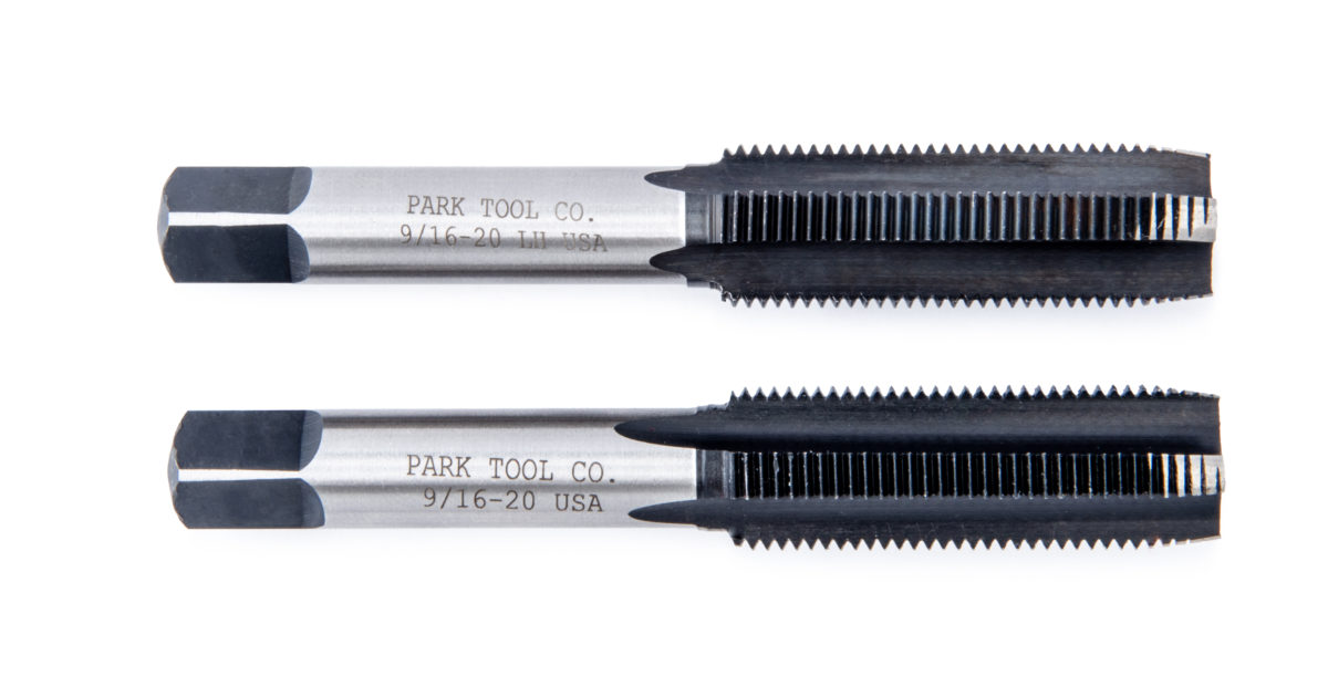

Park Tool also sells pedal taps:

David, Park tool taps are just to repare damaged threads, they are no conical enough for a full tap machninig
