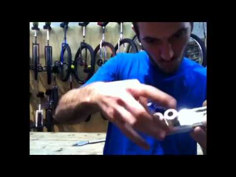

For those of you following this thread, mad4one now produces 150/130/110 triple hole cranks. ![]()

I would recommend emailing Marco Vitale directly. I bought a set of 110/130/150s (black) direct from him in Italy. No, they’re not cheap, like 2x KHs, but very nice. I like mine, and use all three settings on my G32.

Yes and this is a pity, Kris doesn’t want to produce them in spite this is perfect for ungearerd 36. Others are custom as I did
