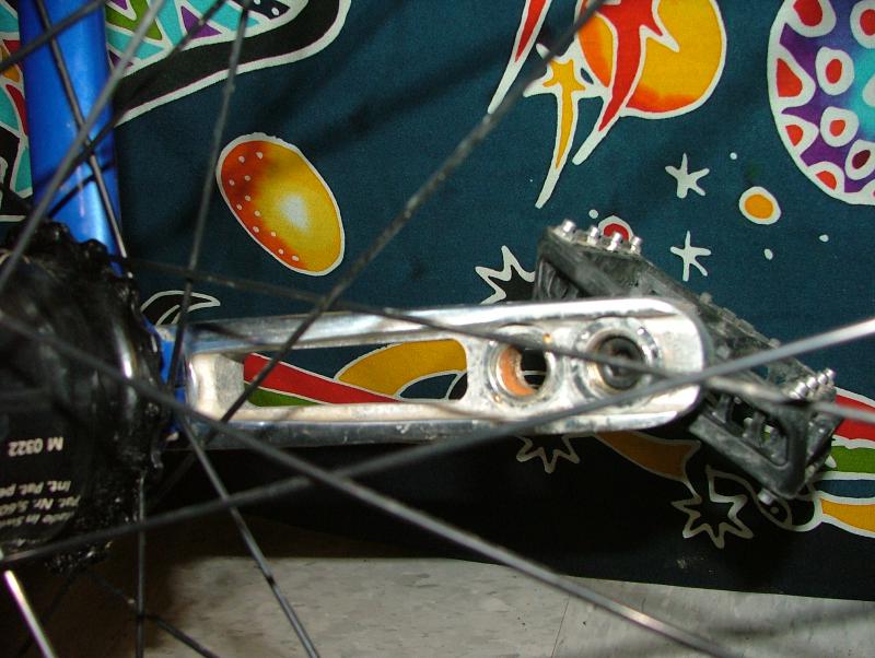

Cheers Corbin! Yeah Sam I love yours! what length are your cranks and what diametre holes?

You went all the way through (I think? Pic isn’t too clear) - haven’t seen that before! How much do they weigh now?

I would think doing a bar like that would be bad for the impact disciplines like street and trials though?

A mechanical engineer i know did the drilling and they seemed to think that it should be fine.
Diden’t get a weight, but its definitely noticeable.
Ive never seen bent Moments…I always bend pedal axles first…Maybe they are stronger than you think?

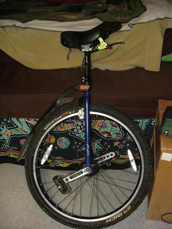

here are a few more pics
It’s very interesting. I know that if I had it done to my cranks though, I would leave at least one cross piece in the middle. But I am no structural engineer
The more I think about it the more I think that those cranks would be OK, as long as don’t risk denting the bottom part with crank grabs.
Oh an by the way, sweet Guni (29?)
the moments are really strong, after three years of hard riding the steal insert broke out of the drilled crank, I think t was material fatigue.
I cut them down to 125mm and ride them again
