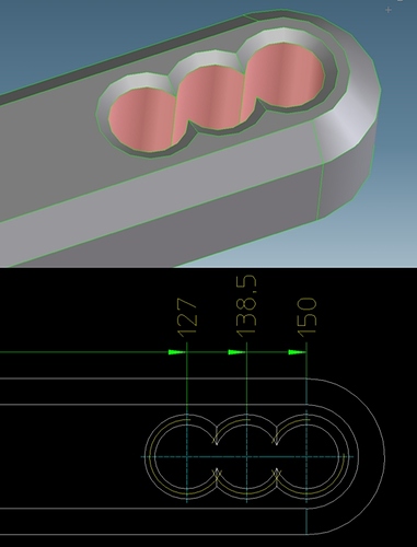

KH SPIRIT 3 holes cranks 110 / 127 / 150mm
As…

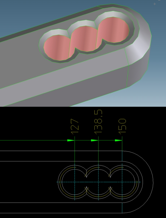

… and even such things are possible I’m wondering, what would be the minimum distance between two pedal thread holes? Or would it even be possible to let them overlap by a few millimeters and drill a third hole right between two existing? Could this work? Any thougts on this?
I asume, if the material is too weak, the middle hole would stretch and the pedal would come loose. But if the material is stiff enough, it could work.
