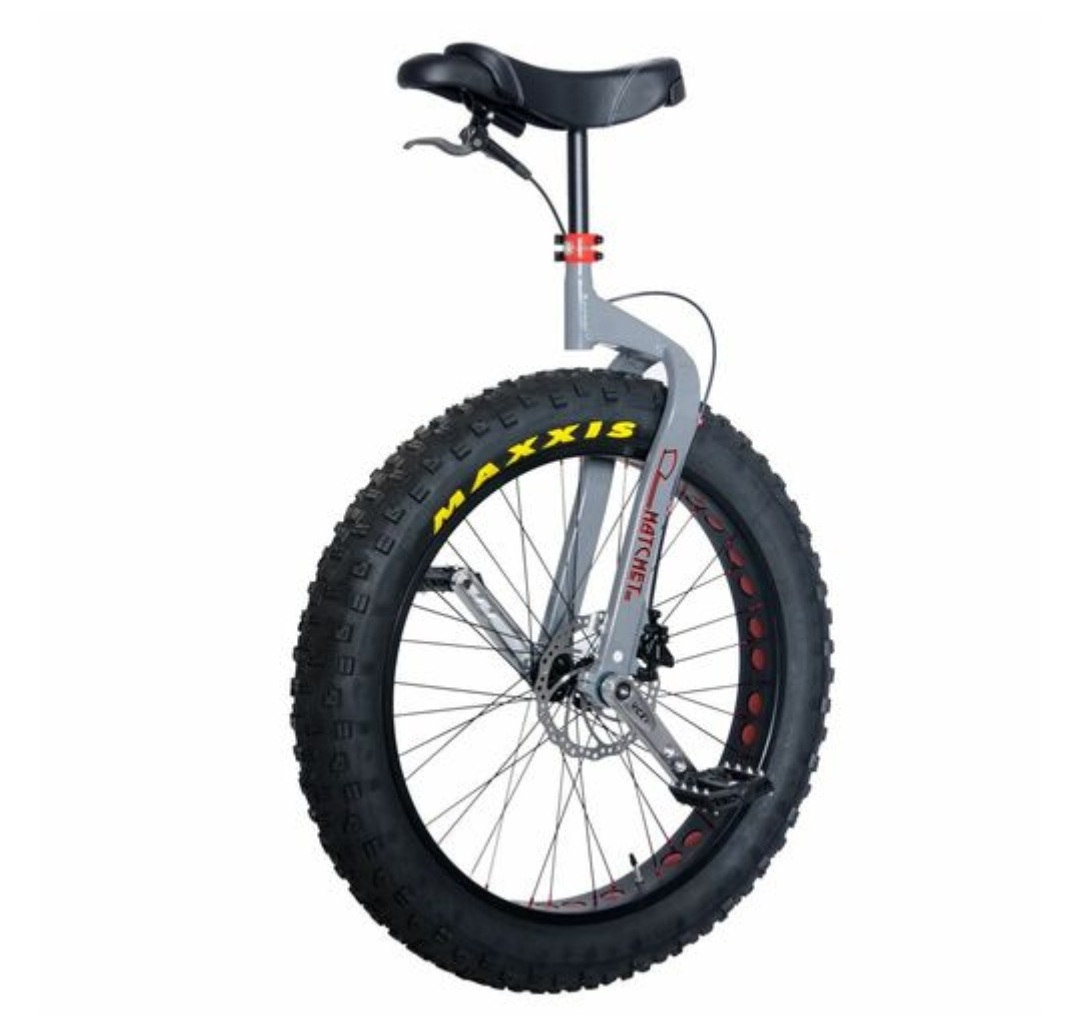

Why does this unicycle have a strange shape to it, compared to the standard shape? Does it serve a purpose? Do any of you feel like that particular frame makes a significant difference in the unicycle’s performance? ![]()
That’s to keep the frame legs out of the way of your legs. The tire is super wide and if the frame went alongside it like normal most peoples legs would hit the frame, so the frame was designed to go back and then come forward again to give leg clearance.
Yeah that’s what I figured, too. Allows for extra wide tire without getting physically in the way.
Not hitting your knees on the frame is a big difference , if you are prone to this. “Normal” design frames for fat tires also exist (but none are on the market currently), and some people ride them without encountering any major issues.
OK. So, there is a good reason. Good. That will become my first muni then, because, I don’t want to wack my knees either.
Well, if you want a fat (4" wide and more) tire, that’s pretty much the only option on the market. On “normal” (up to ~3.5" wide tire) muni, hitting your knees on the frame is less of a concern.
