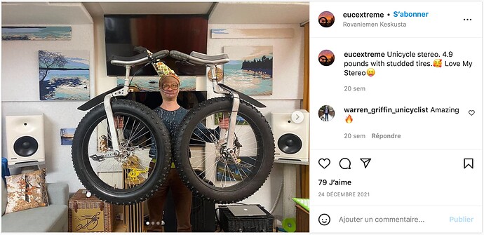

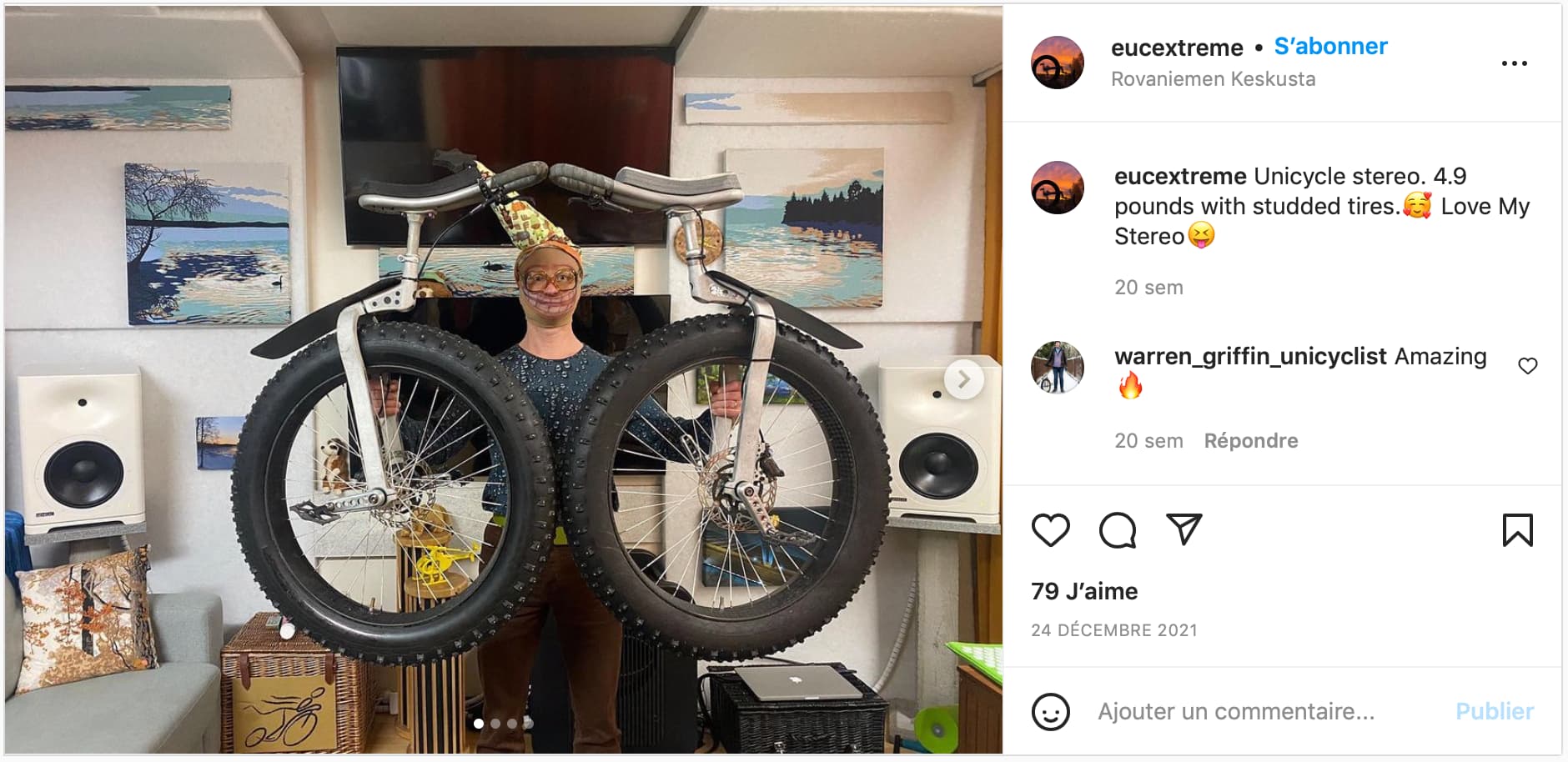

Have you seen these custom lightweight fatties? https://instagram.com/eucextreme?igshid=YmMyMTA2M2Y=
Quite cool…
Oh now that is a nice toy
Whoa, rather impressive!
Someone we know here?
I know a friend of mine who is building his own 36" but it seems it will be heavier than 4.9 pounds

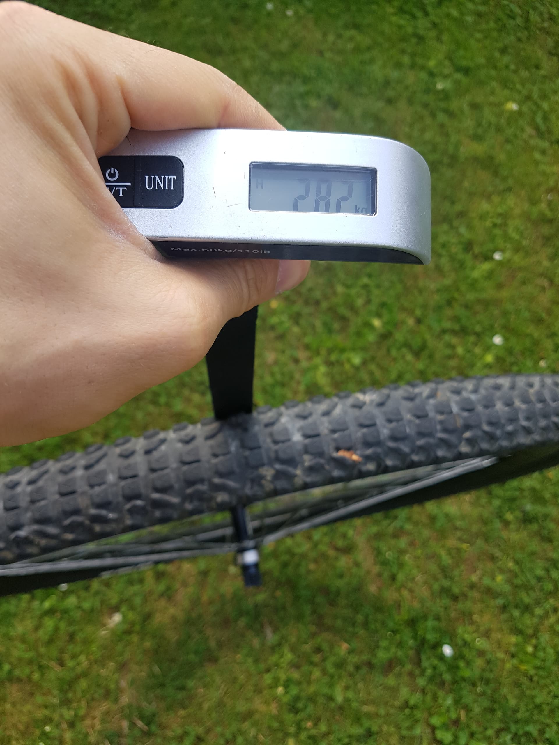

What tube are you running now?
Mine was only marginally over 3kg when assembled with the KH Spirit hub.
