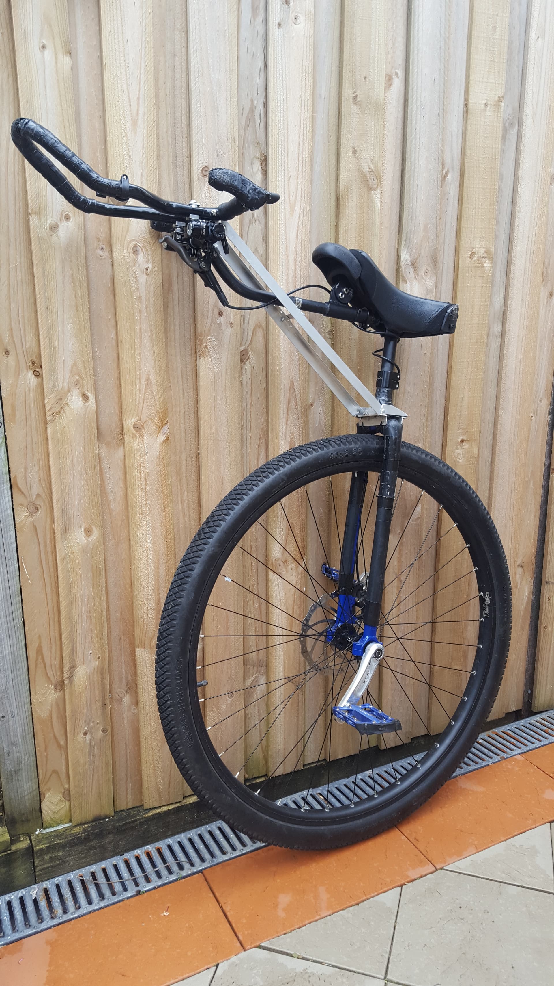

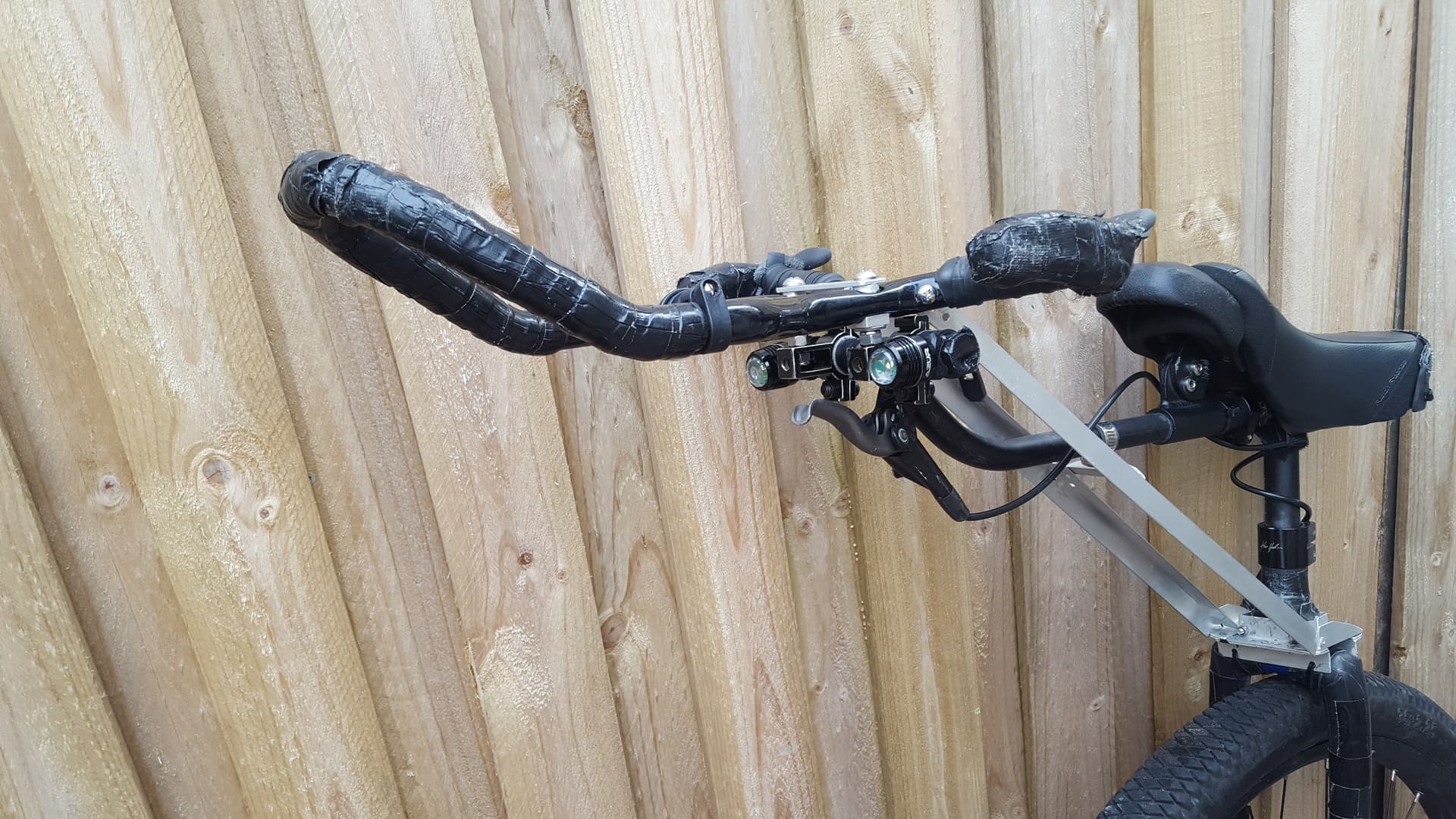

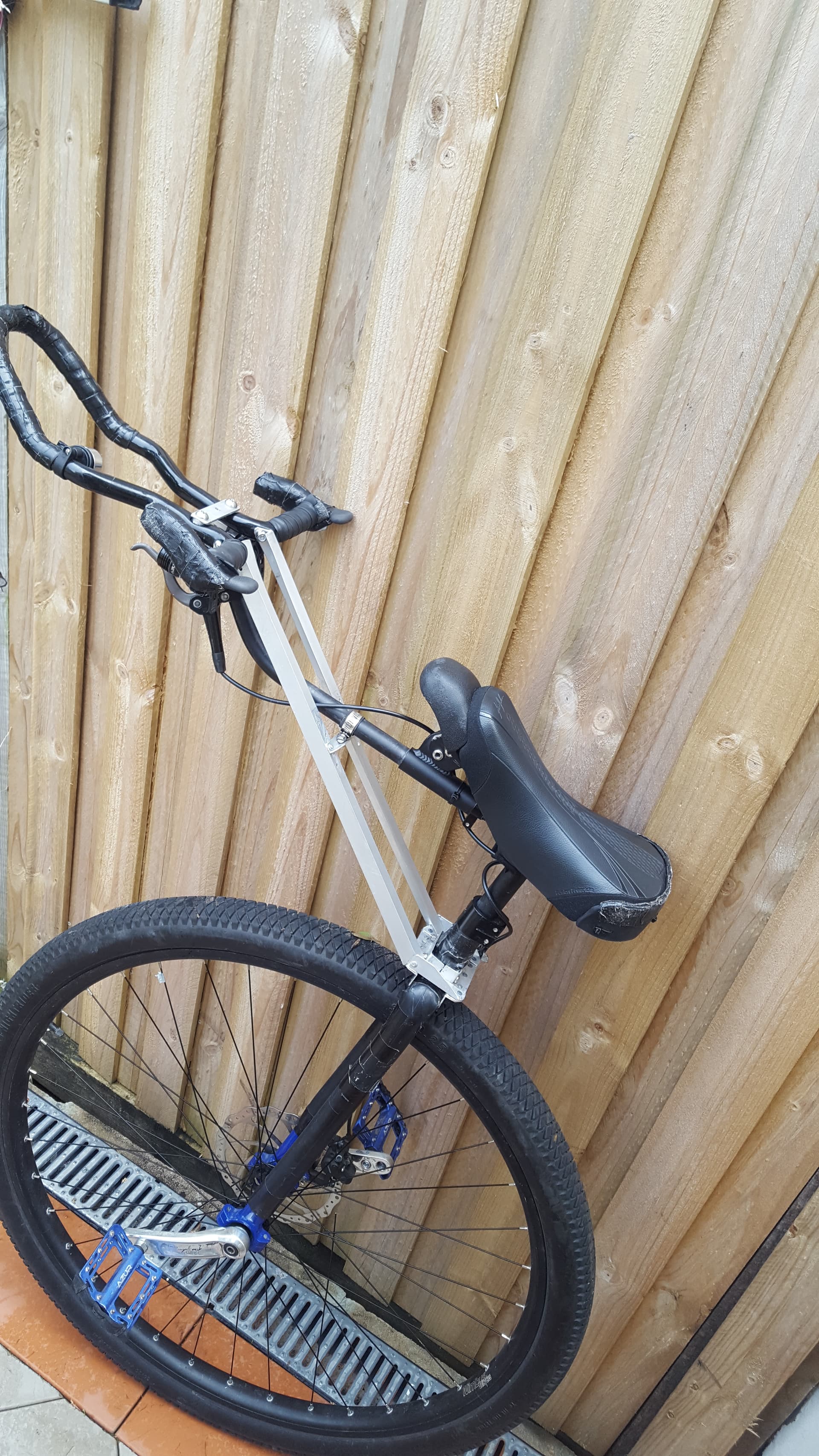

Bracing my aerobars to enable elbow steering with solid positive feel. Just this week I rebuilt the bracing on my KH36 from a single fibreglass brace to a double aluminium brace.
Allows for staying on aerobars even cornering. I can also relieve my weight on the seat by all weight on elbows.
Makes the 14km commute 3 days a week enjoyable and comfortable.

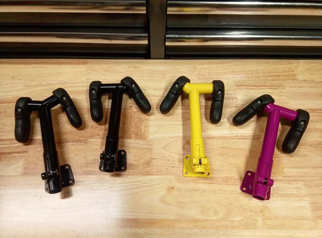

Here’s what it looks like ![]()
The far left one is symmetrical with angles on both sides. The 3 others are asym and offer a better and more natural position for riders who use only one hand (like me).
Can you show the symmetrical and the asymmetrical on unicycles to see what they look like mounted. How much do you sell them for?

Which brings me to the other topic of this thread, handlebars. I have my own version/copy of @jaco_flans asym handlebars (might be building the next iteration soon, I’d like to change around some angles). Getting hung up on them on falls was my main concern, but it has shown to be not a big deal, since I run it close to the saddle. I guess the way that the seat angles down when you fall off forward helps a lot, so with short-ish handlebars getting over them is not a big deal.

They are 150$ CAD plus shipping to whereever you are. And like all my products, they are all handmade by myself in my workshop ![]()
If you have any question you can message me!
