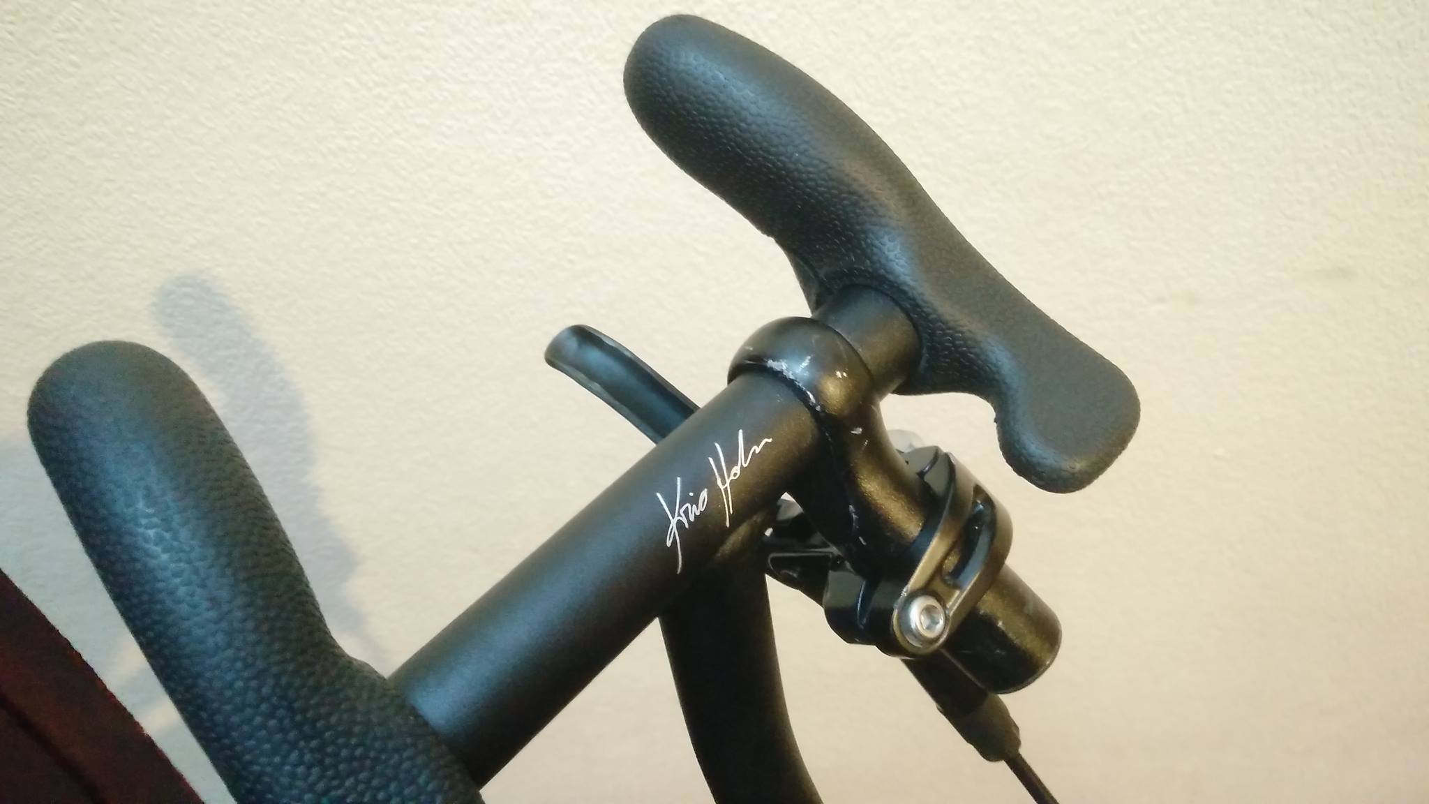

I’d have to say my most game-changing piece of kit is my Ursli bar. I have the medium-sized one on my muni. It’s a really simple but solid piece of equipment. You can ride comfortably two-handed, or one-handed with either hand, since it’s symmetric. You can change the riding position in-ride; for instance, I tend to hold it from the side while sitting, but from the front while standing up. I also really like the fact that you can angle the brake lever perfectly for an easy reach.

Thanks for information and photos on jaco flans handles , Im uk so i could imagine that with delivery it could work out expensive sadly :frowning_face:

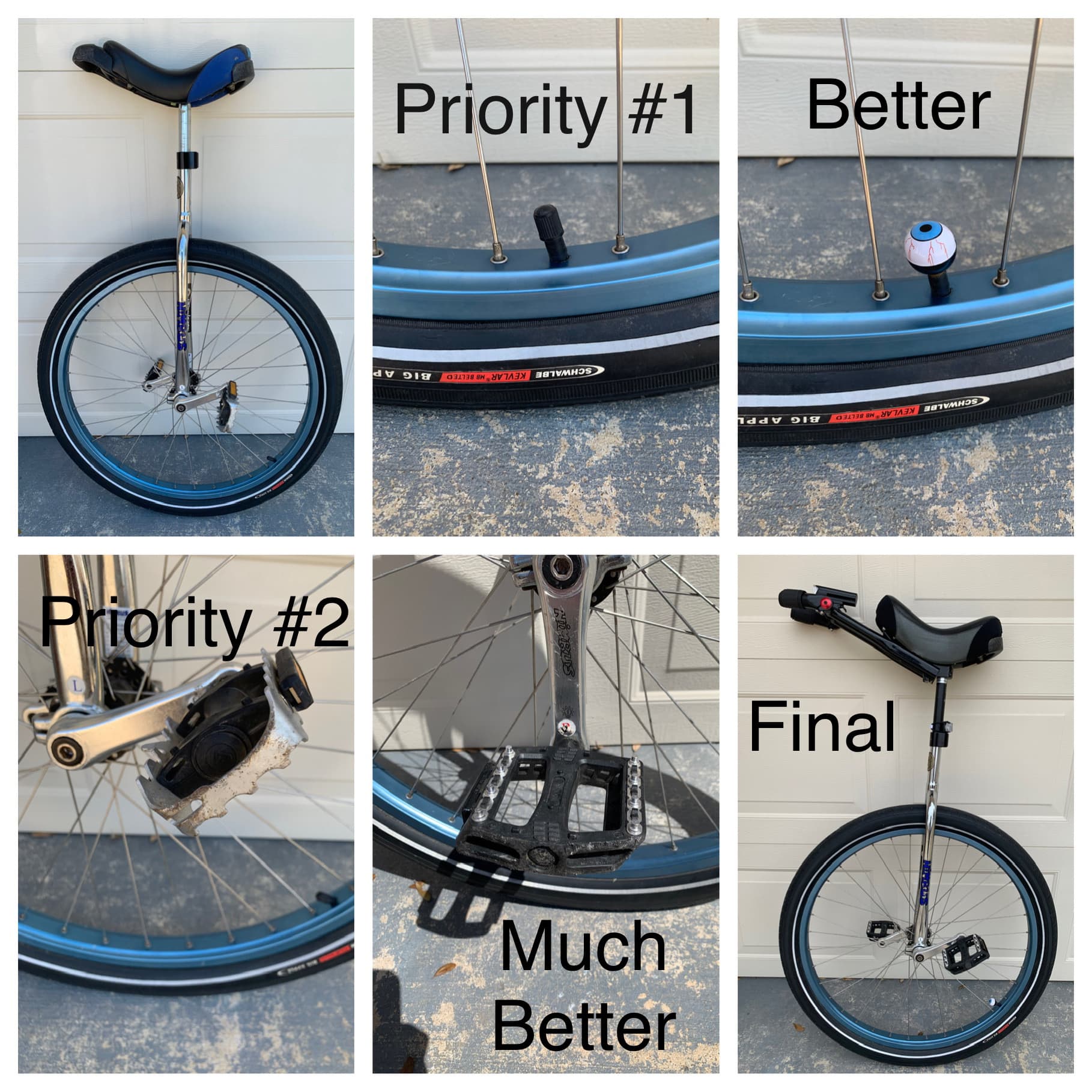

But earlier this year I acquired a wonderful Nimbus Road 29” w/ a 28” Schwalbe Big Apple tire on it (which is, interestingly enough, 29.25 inches in diameter). This photo collage is my best attempt to capture (in six photos) my progression of additions that I felt were game-changing after, of course, my aforementioned Kris Holm leg armor. I have three pair of leg armor. (Have you ever smelled soccer/football goalkeeper gloves that never get a chance to breathe/dry out? :smiley: )
The light-speed additions at the end were:
  1. A Coker Pi Bar
  2. A Coker soft & cushy seat. (Gotta get the boys all properly in their seats, but once you do you can ride for a long time. It’s like riding on a marshmallow.)
P.S. I am hoping someone knows the story behind this uni. Specifically, the story behind the rim. When did UDC sell a blue rim shaped like the one I have? @rogeratunicycledotcom
I bought it from a couple whose son was away at college/university, and had decided to ask his parents to sell his Nimbus road uni (but they let me know his very used/much-loved Trials Uni was not for sale. )
Is it an old/original Stealth rim?

The rim was used on early Nimbus II unicycles. That is quite an old unicycle now… I am trying to date it and think it may be about 2005 but cannot be too sure. There may be a 3 digit number on the hub, if there is that is the batch number, and I can tell you exactly.
Thank you, Roger!
I will check the hub and let you know!
