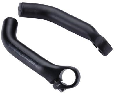

@mowcius where did you get that little extension piece for the brake lever?
It’s a very basic bicycle bar end that I chopped the curvy end off.
I get them for super cheap second hand from my local bike recycling/fixing place.
This kind of thing:
Thanks for that, such a simple idea and yet very effective.
I’ll be off to my local bike shop in the morning.
I’ll let you know how it goes regards comfort.

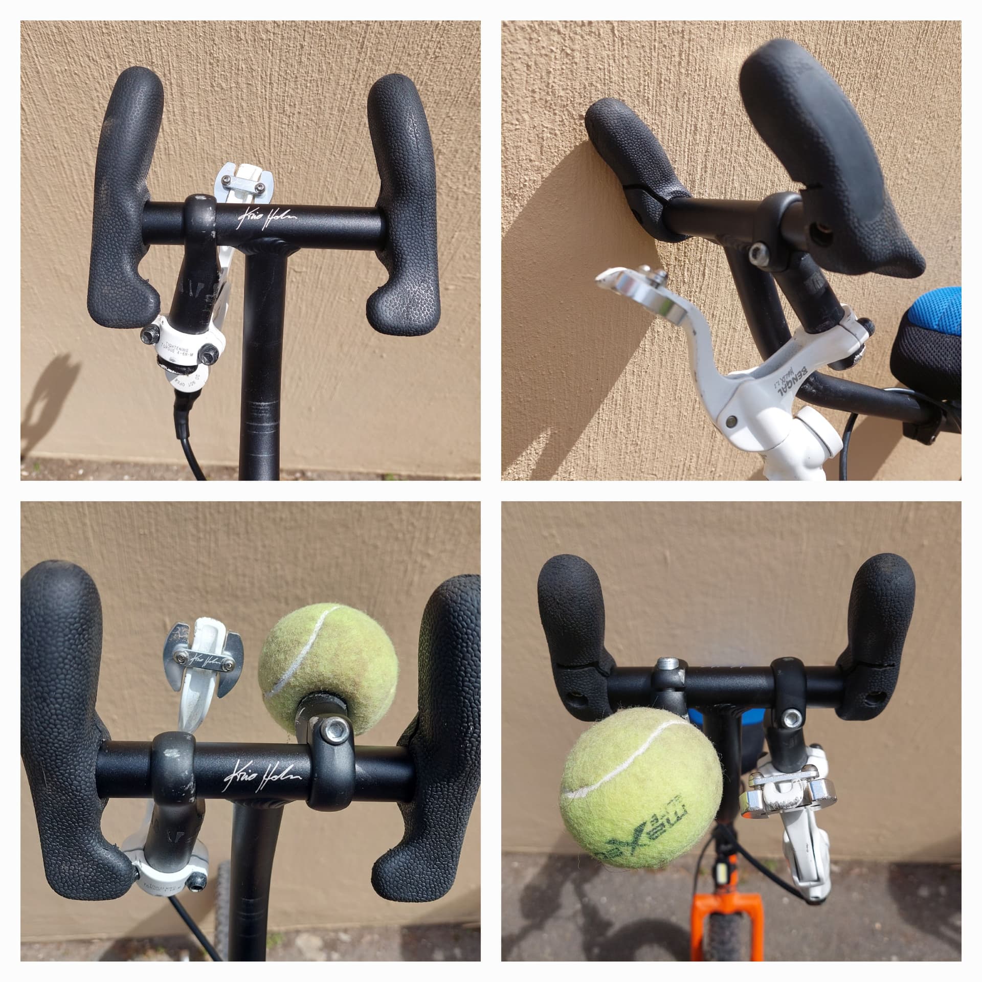

I had a rummage through my spare bike bits and found two bar ends, so with a little bit of cutting put one on for the brake and it was a game changer on this morning’s ride having the brake so comfortably close to my left hand.
Later I decided to add the second for bump protection. Presently I’m using a tennis ball on it but I plan to nick one of my son’s bouncy balls.
I imagine the tennis ball will last a lot longer than a bouncy ball. They’re surprisingly brittle once you start to abuse them by cutting them up.

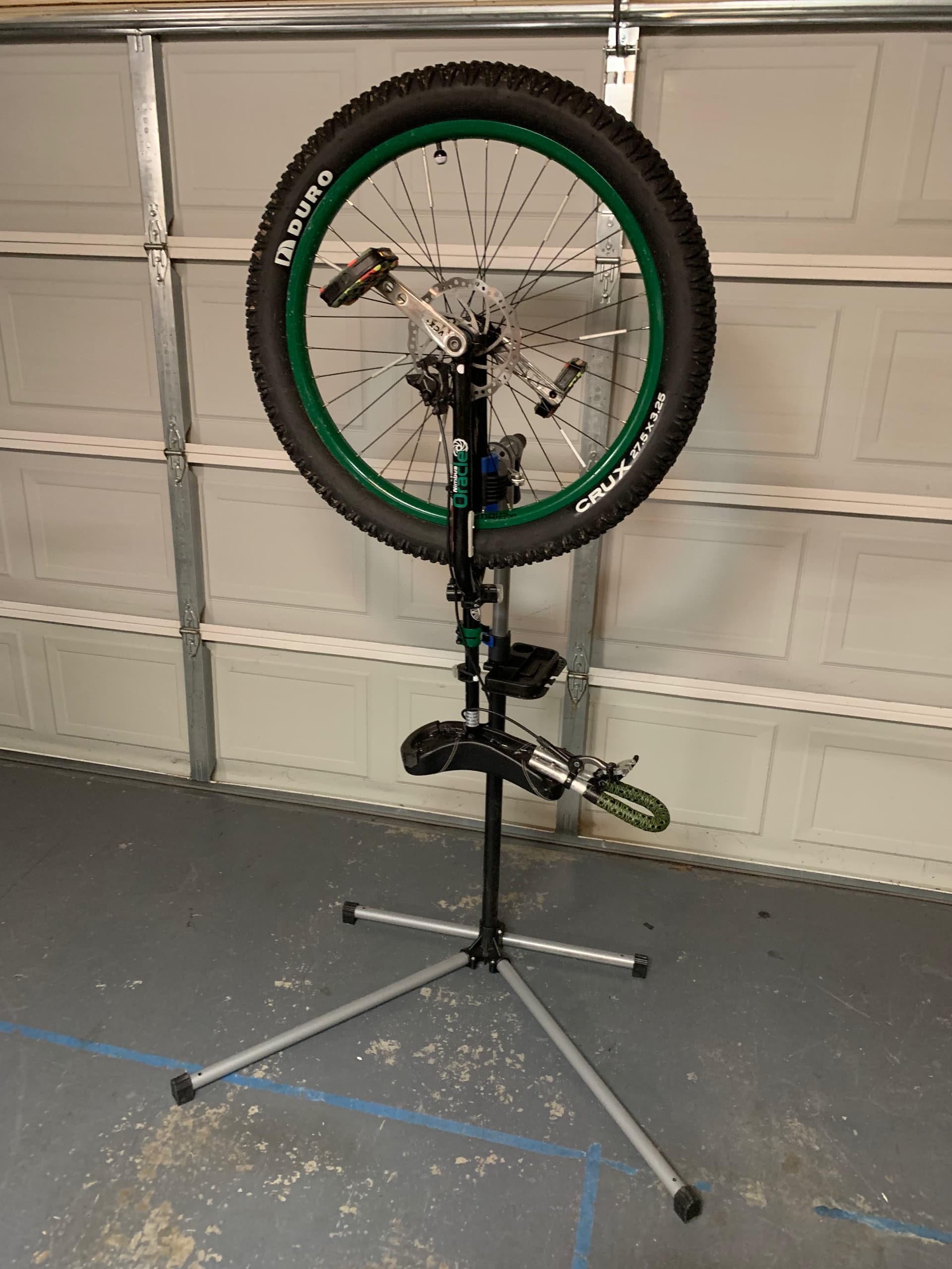

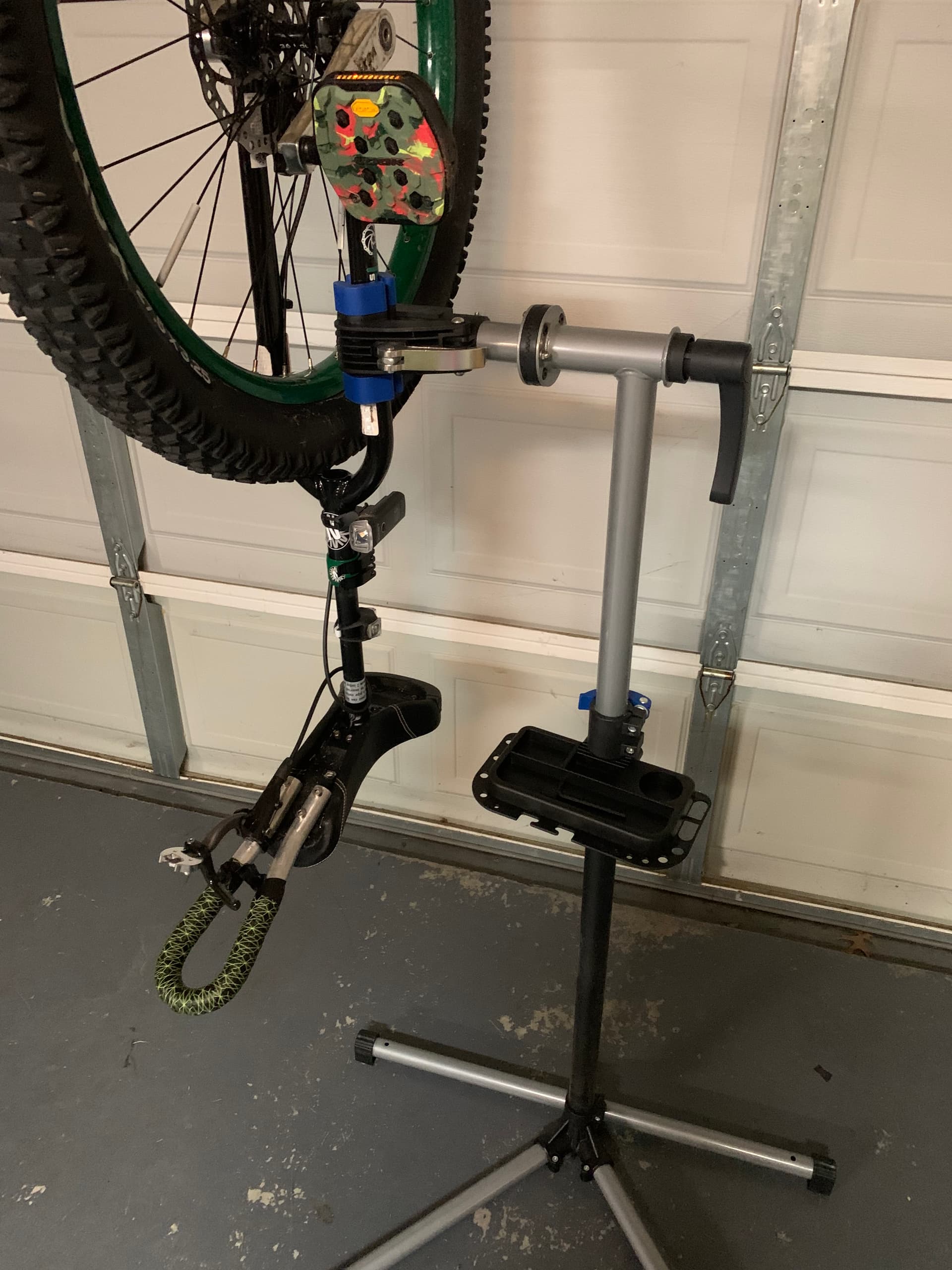

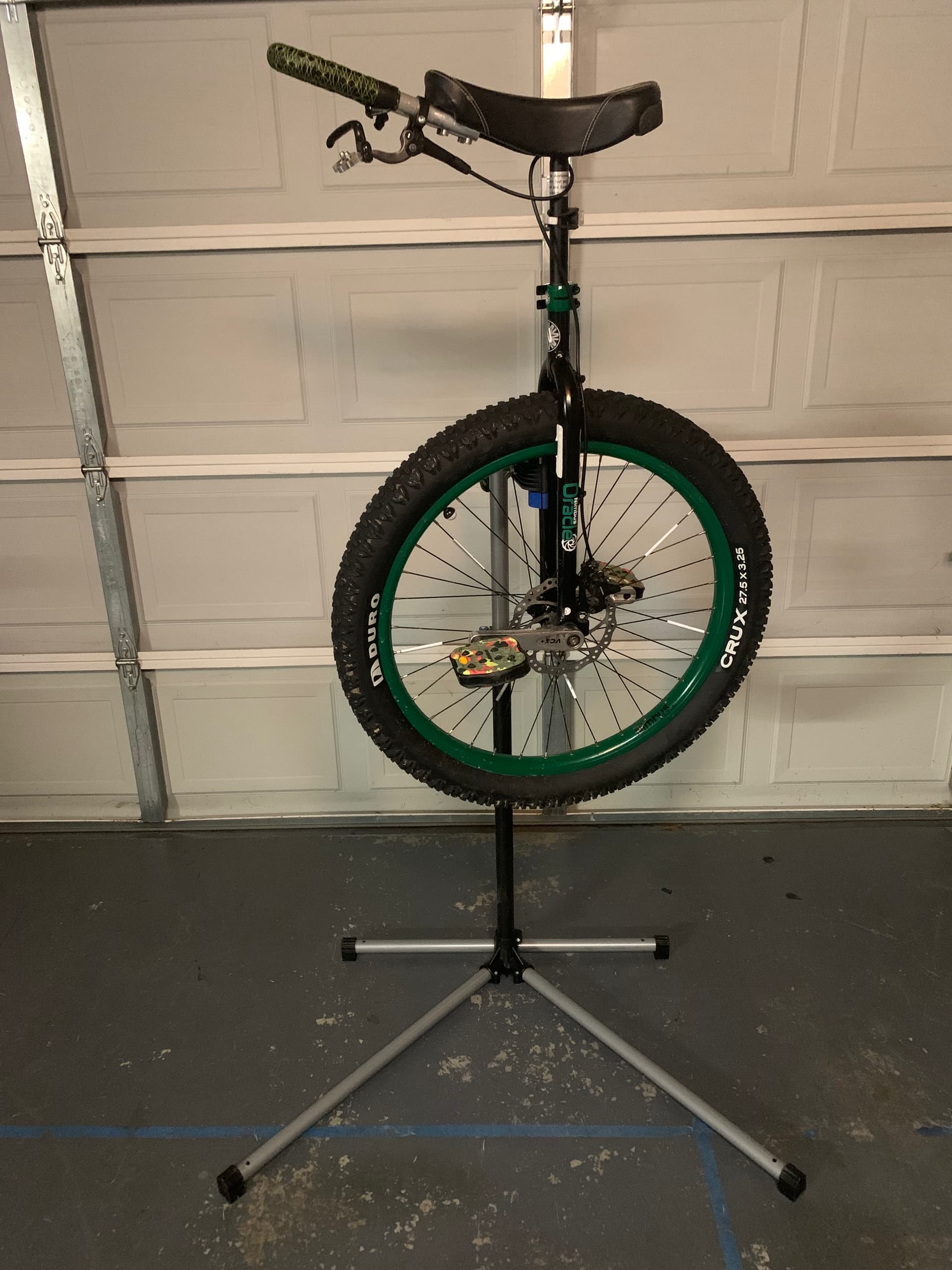

Time will tell whether this recently-acquired b*ke-stand is a game-changer, but after using it a bit yesterday, I believe it is going to make changing tubes and tires much easier. If I knew how to true a wheel, it might also help with that.
Adjusting the saddle to get it perfectly lined up with the tire still seems easier with the tire resting on the ground, but I expect this stand to enable me to repair punctured tubes quickly, rather than overlooking the problem and simply adding air each time I ride.

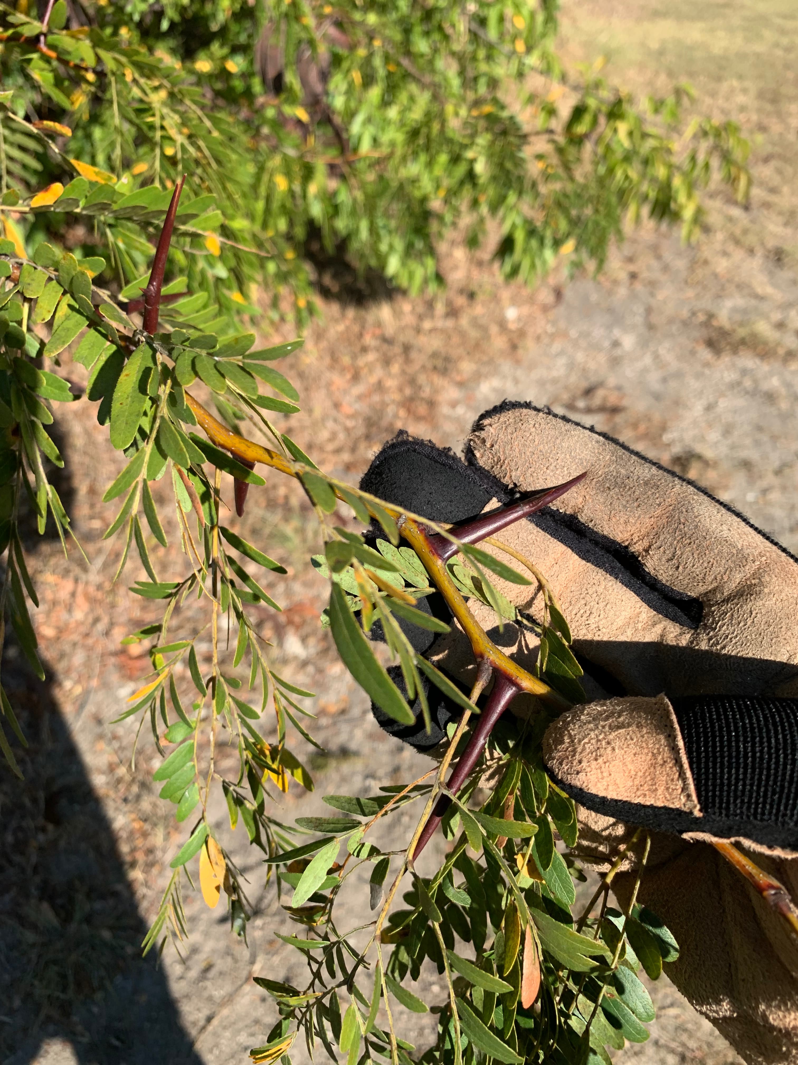

It seems that every time I ride Muni with a tube that holds air, the tube magically leaks the following day. Thorns, while not all of them as aggressive as these, are the culprit. :grin:

Can’t agree more, a good repair stand makes alignment of disc rotors much easier.
When I find that I need to align my disc rotor, you may receive a PM from me! :laughing:
A trick I learned at the bike shop when working there for a summer was to try and align the brake with a light source behind it.
So my kitchen floor is bright contrast against the dark black brake. So I’ll have a sight line that I can see down the brake with the gaps on the sides of the rotor letting in light and the floor being bright contrast.
Next step is just rotate the wheel to find where it making noise, and slowly bring that section through to see where it rubs the pad. You’re not spinning it super fast but not very slow either. Mostly enough just to see what side the rubbing is.
I like to stand when working on it so I usually set the Unicycle horizontal in the stand with the frame and everything at chest level to see down the brake well.
The light source is the key. I use a wide flashlight. The second tip is to tighten one of the two bolts on the break , while only manipulating only the other one. That gets you most of the way there, and you can fine tune from there. Its easier to demonstrate than explain in text. There is a good tutorial video that I followed, and now I have no problem aligning the rotor.
I have been wondering about a racquetball… very similar to a tennis ball, but without the fuzz, and hopefully stays cleaner/nicer looking without that, especially in mud. They have green ones too, which might match acceptably well with the “racing green” on the nimbus 27.5’s. (And of course normal blue for the 29!)
Hmm those thorns seem to be from a kind of Eucalyptus…
that remembers me a tree named “Tal-Haa” in Morocco (probably some kind of Vachellia )
