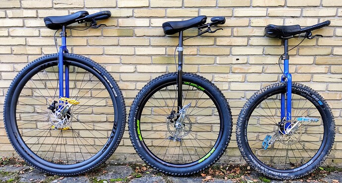

Time for a group shot of my Munis (36"/29"/27.5")
Weights are 6,51kg/6,12kg/5,34kg
Cranks are 150mm/137mm/127mm to keep similar gain ratio.
The newcomer that I built a few days ago is the KH29 with the 29x3.0" Bontrager XR4 on a Spank OOZY Trail 395+ rim (35mm inner width). The handlebar is an asymmetric Flansberrium Mini T-Bar by @jaco_flans that I really like so far.
I will obviously keep tweaking them as that is just part of the fun. But I will also strive to keep them feel different which I think is especially important for the 27.5" and 29" as the difference in rim diameter is just 38mm…
