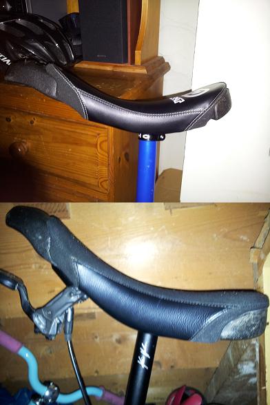

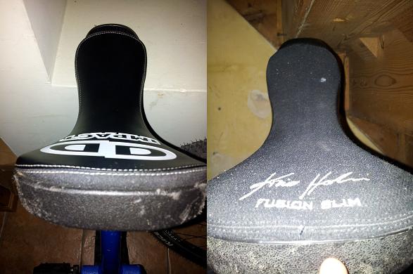

All the saddle basis are the same as far as I am aware (curve wise) and the level of center padding flattens it out, the street (which I also have) is thinner than the free ride with the slim being slimmer still and the Impact being about 10mm all the way over so it seems to be more curved.
I also run SI SLR saddles and am used to sitting on a 135g razor blade so I have always struggled with Uni saddles, unfortunately all the slimmer saddles are the same width but the more padding the saddle has the more it bulges out the sides wen you put your weight on it making it wider (and causing me chaffing issues). Measuring the Impact it is 14cm at the wides point and 8 cm where your thighs sit above the post, which is exactly the same as the Impact
The Impact also has a vinyl cover which like you I prefer to the rough fabric ones
You could indeed get the impact now and the CF base later when you want to get a handle, the CF base is incredibly stiff and will loses you a lot of weight. There are a few guides using carriage bolts or flanged nuts but I used T-nuts from B&Q, flattening the spikes (meant for wood) and use 2 part adhesive yo bond then to the seat. I can do a fuller right up as it was a bit of a pain to do
It is hard to tell from these pics but you can see the effect the extra center padding has on the curve shape and also how the Impact rolls off more on the sides where as the Slim is squarer. The very front and rear of both saddles seem to be padded to the same thickness but it is the center area that has the difference.
