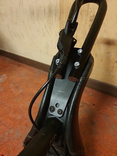

Just added a M4O 24cm Ursli to my QX Eleven saddle on my 36"
I really like it so far. I also own a M4O Handle Saddle “medium” that I also like and have mounted on my 27.5" Muni. The QX Eleven+bar seems to be slightly more comfortable for me.
I assume it’s a similar “ridge” that exists on the QX Eleven (as seen in picture below). But here I think it actually improves the angle because the seat is banana shaped and not flat like the Zero.
I also own a (old?) KH reinforcement plate but that seems to be a poor fit for the QX Eleven as the holes do not align. I think it is possible to make it fit but it will require some force and to me it seems like the QX Eleven is very stiff even without the plate (maybe due to the “ridge”) so for now the reinforcement plate will stay in the parts bin.

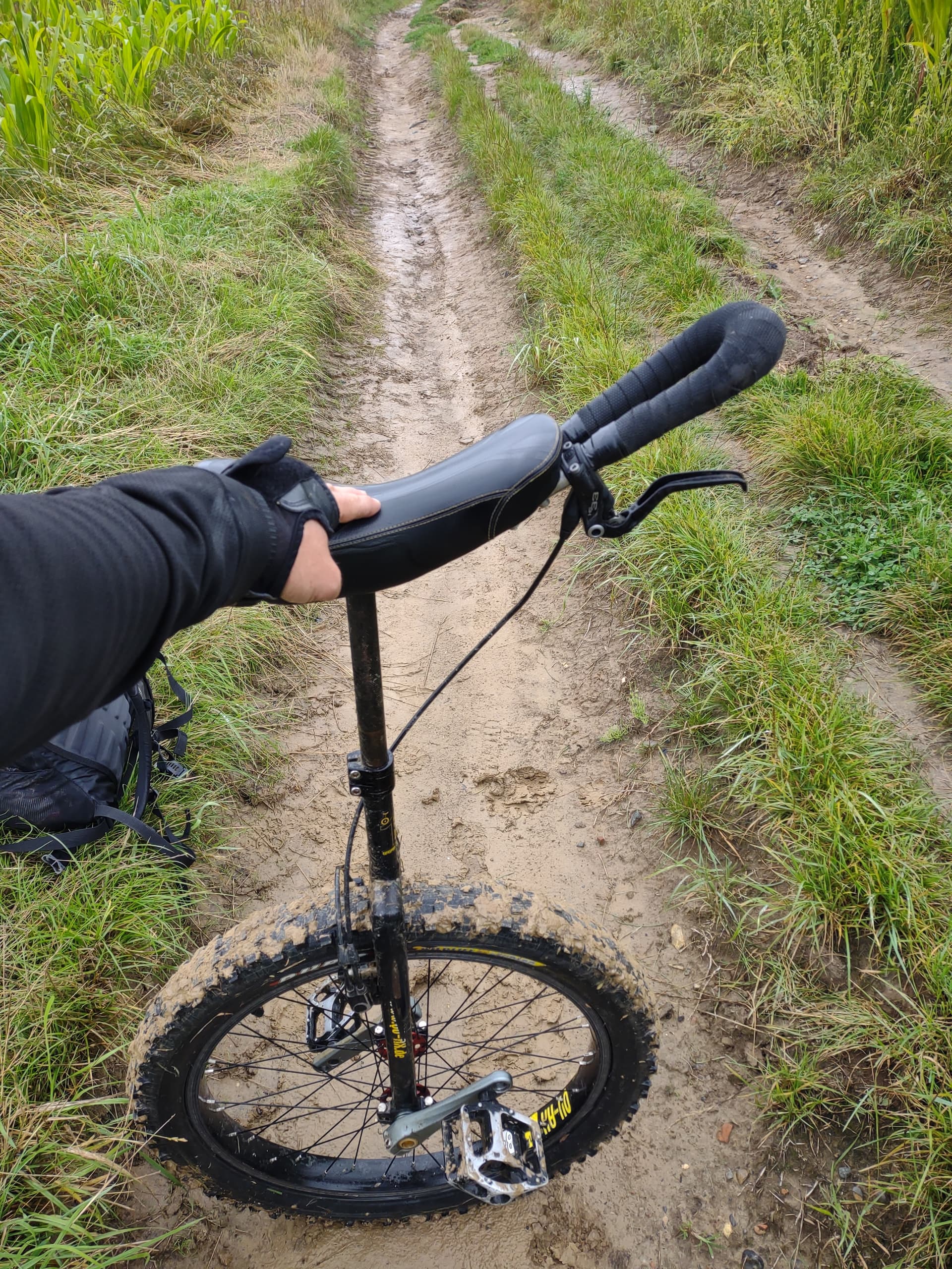

Thanks for sharing, @Hammer! I got my Ursli bar yesterday and have only barely tested it, but it seems very nice and solid. I attached mine on my QX Eleven with a KH reinforcement plate:
It was a bit fidgety, and I had to bend the Ursli bar slightly, but it seems rock solid. Can’t wait to try it outdoors!
I just need to follow up on this thread. I’ve tested my Ursli bar on a few muni trails now, and I couldn’t be happier! It’s sturdy and rigid, yet light, it’s simple, yet offers all the hand positions I could ask for. At first I was sceptical about having the brake lever tilted, but to my surprise I get a better control over the brake lever than I ever got on my KH T-bar.
Highly recommended!

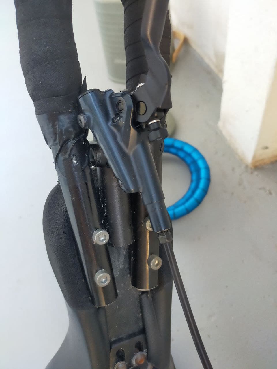

Does anyone here tried mounting the brakes in between the two bolts? There’s just enough space to do it. That setup moves the brake lever further back, in a position more similar to a traditional brake lever. I’ve been trying it for the past week, but I haven’t made up my mind yet.

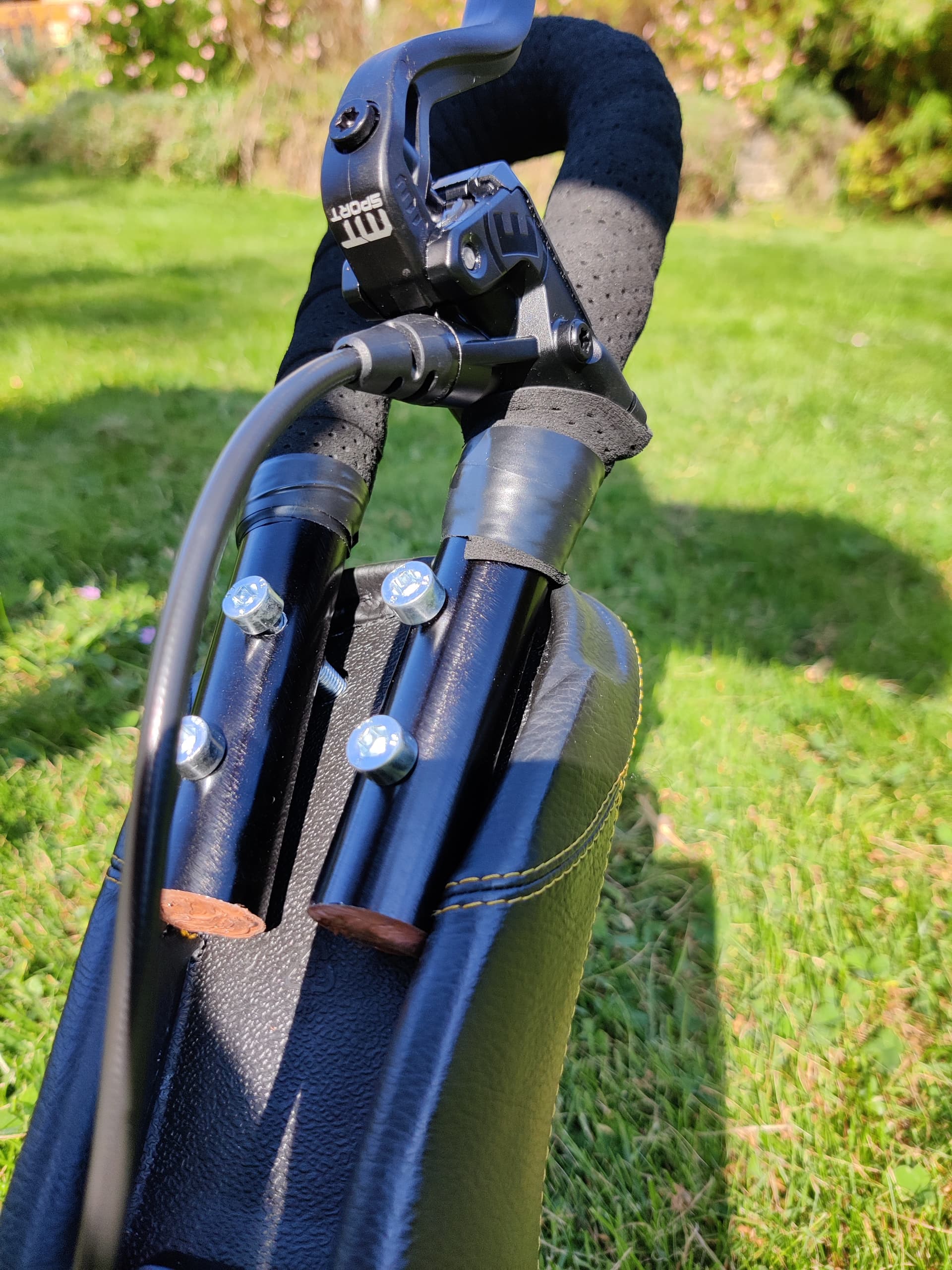

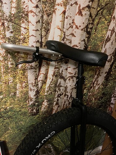

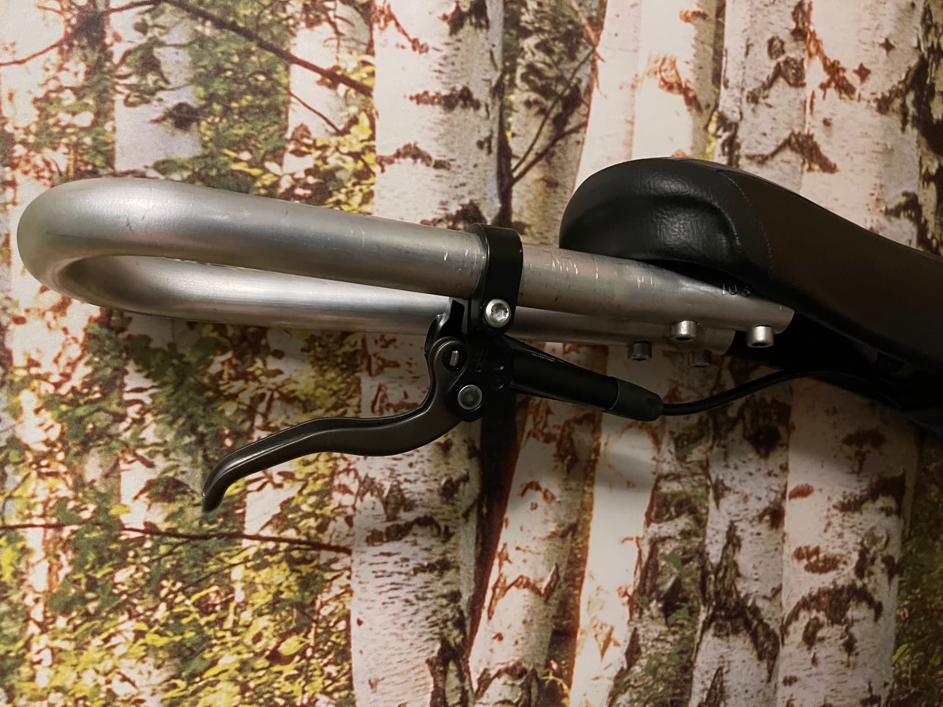

Not sure that what you mean, but I have used a 2-bolt brake lever mount - Qu-ax or Nimbus, I don’t remember - to fit my brake:
I had to reverse it so that the lever can be held while having the hands on the bar. I don’t think it would fit in the traditional direction as the space between the bars is much narrower there.
I find this set-up to be better than the one provided by Mad4One.
I don’t see any issue in mounting a brake lever between the mounting screws as long as you use appropriate spacer (and longer screws) to make appropriate clearance for the brake mount and the edges of the saddle (left and right).

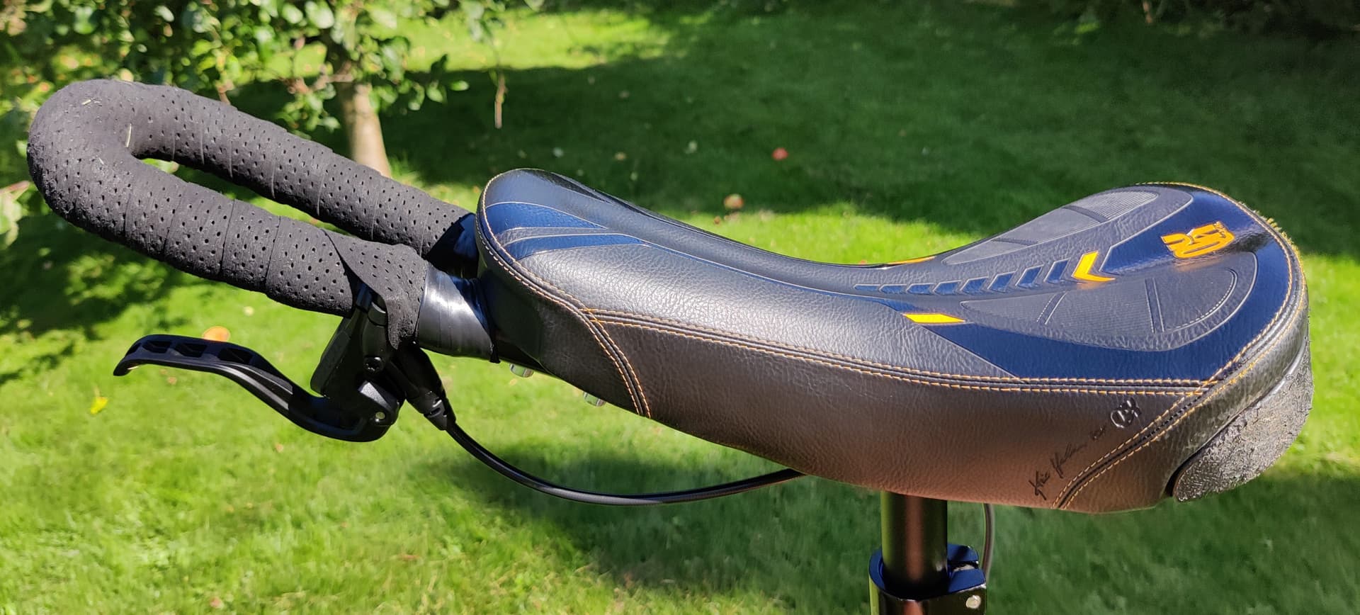

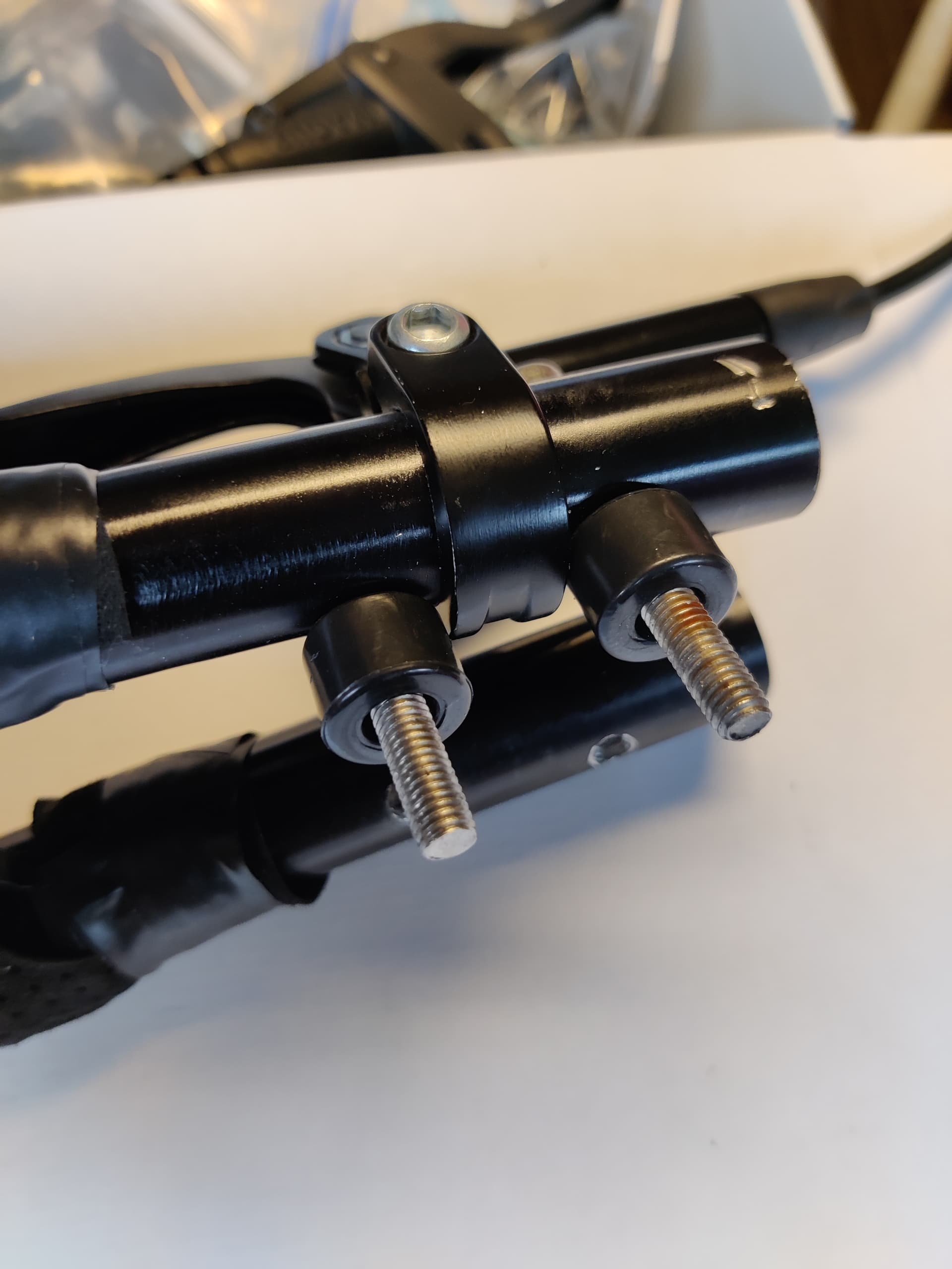

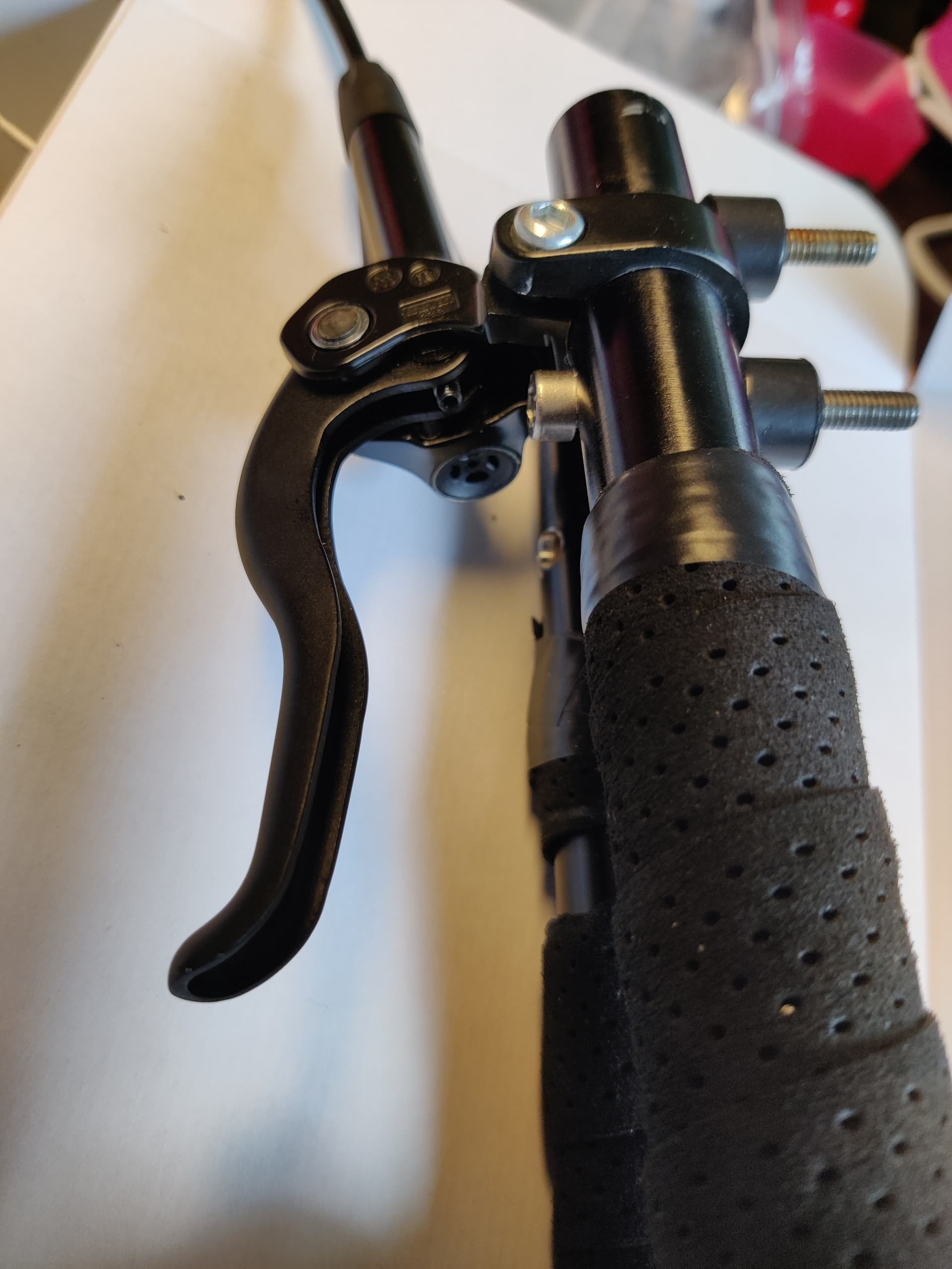

I have a KH Fusion One and a QX Eleven (and a few others). If you want me to try the setup on one specific saddle I can try to mount it on and take a picture if you like. I have the short (24cm) Ursli bar.

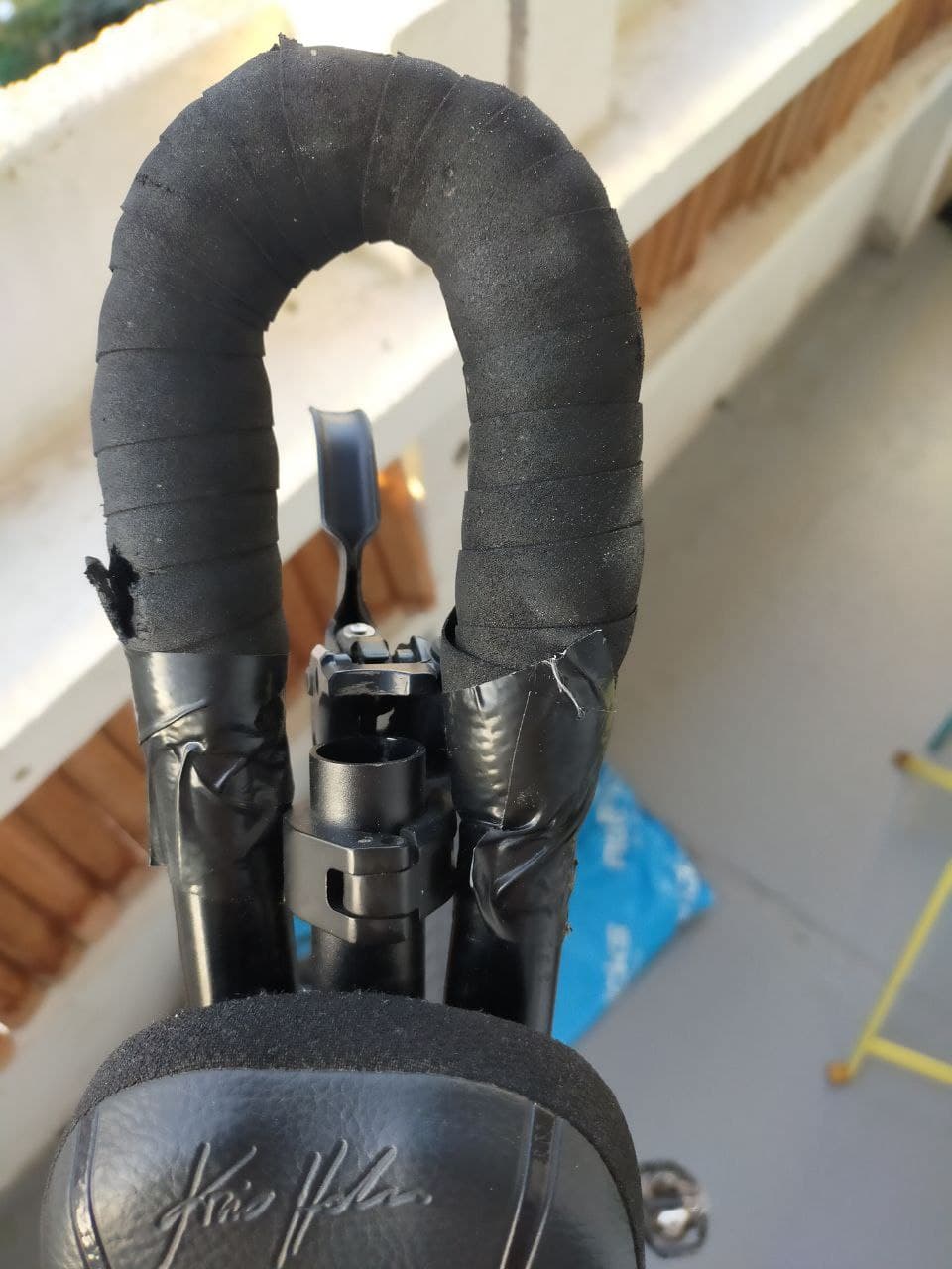

Oh wow I didn’t think you could use the brake mount in this way. @Hammer actually showed the mounting position I was describing. I have been trying that position for the last week, but I’m not sure if I’ll keep it in that position. @Maxence are you able to position the 2-bolt brake mount further back, or is that the only position possible? Can you still grip onto the bottom part of the bars in the setup pictured?
I don’t think I could put the 2-bolt brake mount further back. There are two issues:
  • the brake mount I use is designed to fit the 2 front holes of the seat and the 2 other holes are further from each other so it won’t fit;
  • there’s not a lot of space between the 2 ends of the bar: the brake mount fits between the bars when it’s in the 2 front holes but I think there is not as much place as needed in the 2 back holes.
By the way, the first point could be solved by using a reversed 4-bolt KH brake mount but the second point would probably still be an issue.
I can’t grip onto the bottom part of the bars either. But I really don’t mind as this setup seems perfect - at least for my riding style.
There’s also another limitation: if your brake lever is too large, it won’t fit between the bars. If you look at mine, you can see it is slightly twisted because the bars prevent me from putting it straight. That’s not an issue there, but it could be depending on the brake and/or the riding style and/or the size of the rider’s hands.

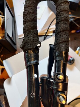

First test / taste - it’s going to be great.
Sadly I stupidly cross treaded one of the rear bolts as I did find it a bit fiddly to mount. Then had to over tighter that bolt to get it in and it pushed the saddle nut into to saddle. Managed to rescue it - and it does hold now but I panicked for a moment - thinking I’d messed up my nice almost new Fusion One.
LBS gave me longer 35mm M6 bolts which helped with the front bolt holes given the ridge and angle.
Not using washers at this stage and have managed to get them all down tight.
Do people think there’s any risk of over tightening them? Especially the from two bolts - given there is a gap to the sockets / nuts from the ridge.
It feels pretty strong but I did worry that the saddle nuts could be pulled out of the the saddle base. Doesn’t look like it can but it occurred to me.
