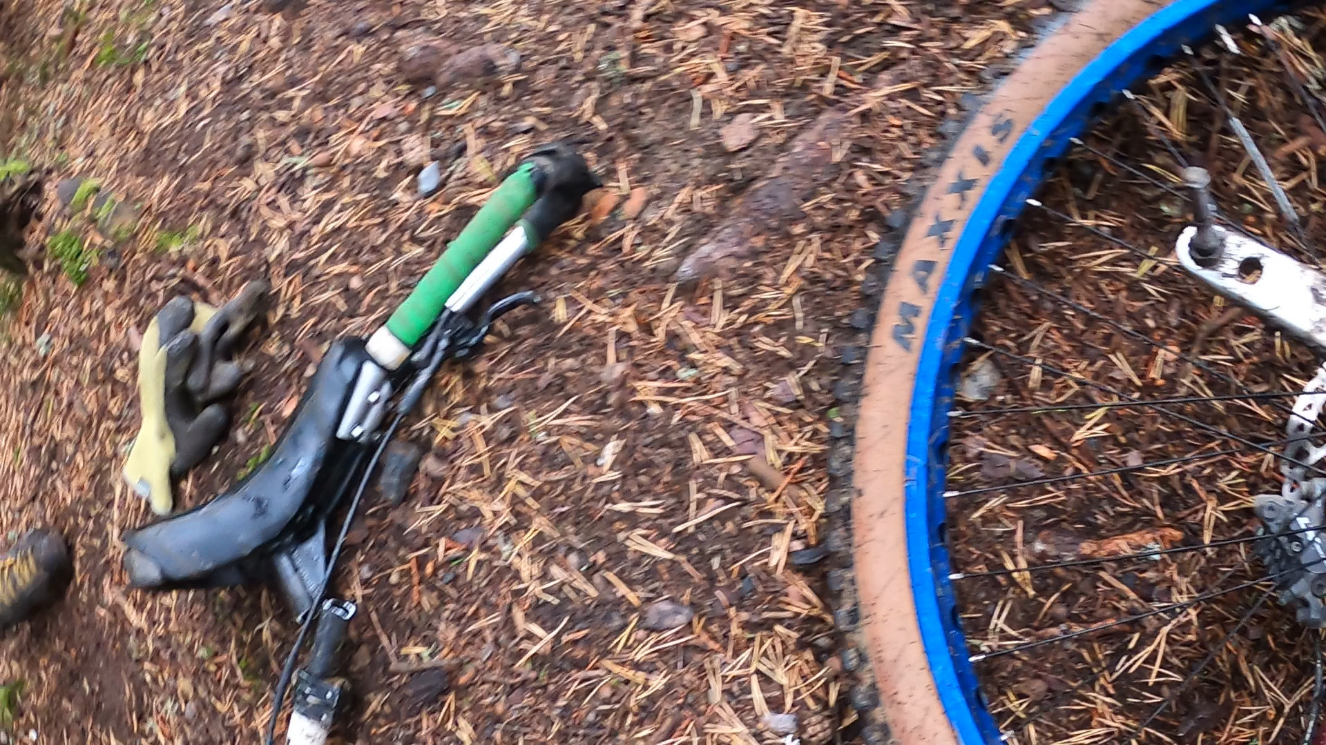

Because it hurts when I hear my unicycle fall on the bar only protected by a little bit of handlebar tape.
That would be more expensive, and structually worse. (You are getting rid of a lot of crossection). Also it would fit on less seatbases (like the fusion one). You could maybe recess the bolts into the bar, for that “professional touch”.
I understand the disliking of the bar falling onto the handlebar tape, but some electrical tape or some heatshrink tubing can be a sacrificial layer on top of the tape.

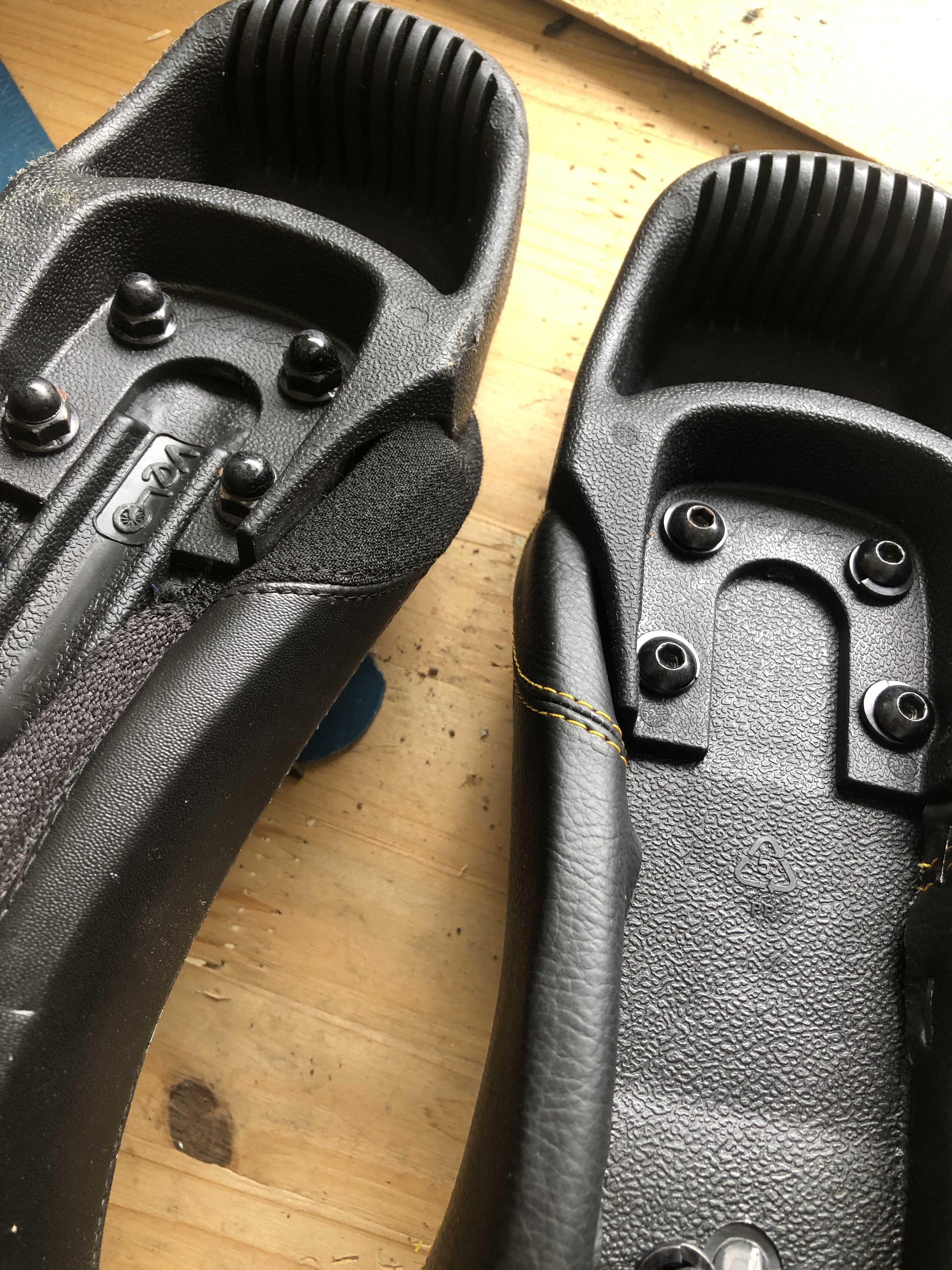

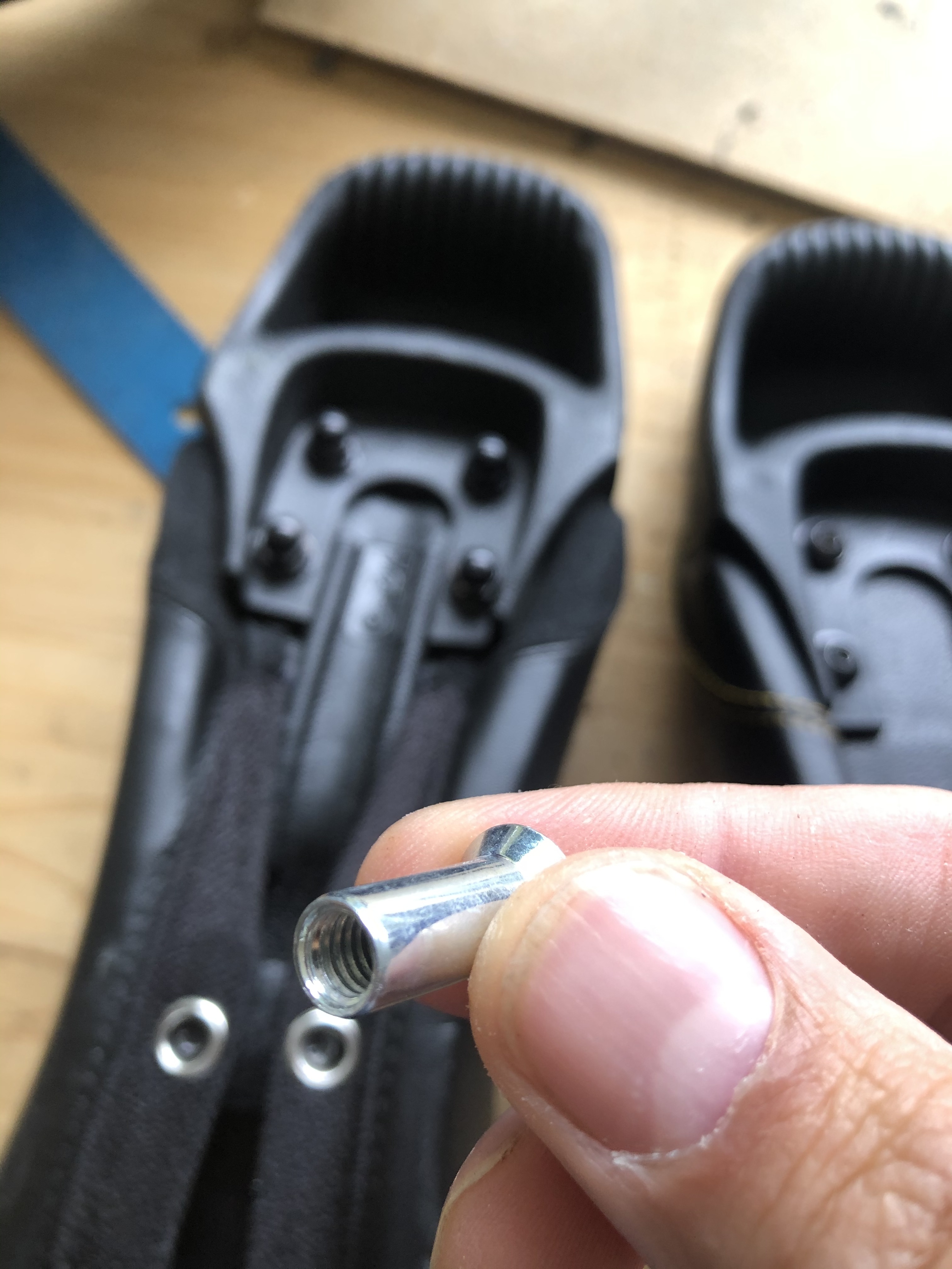

mad4one saddle is not really compatible but you can make it (bigger holes and threads like in second pic)

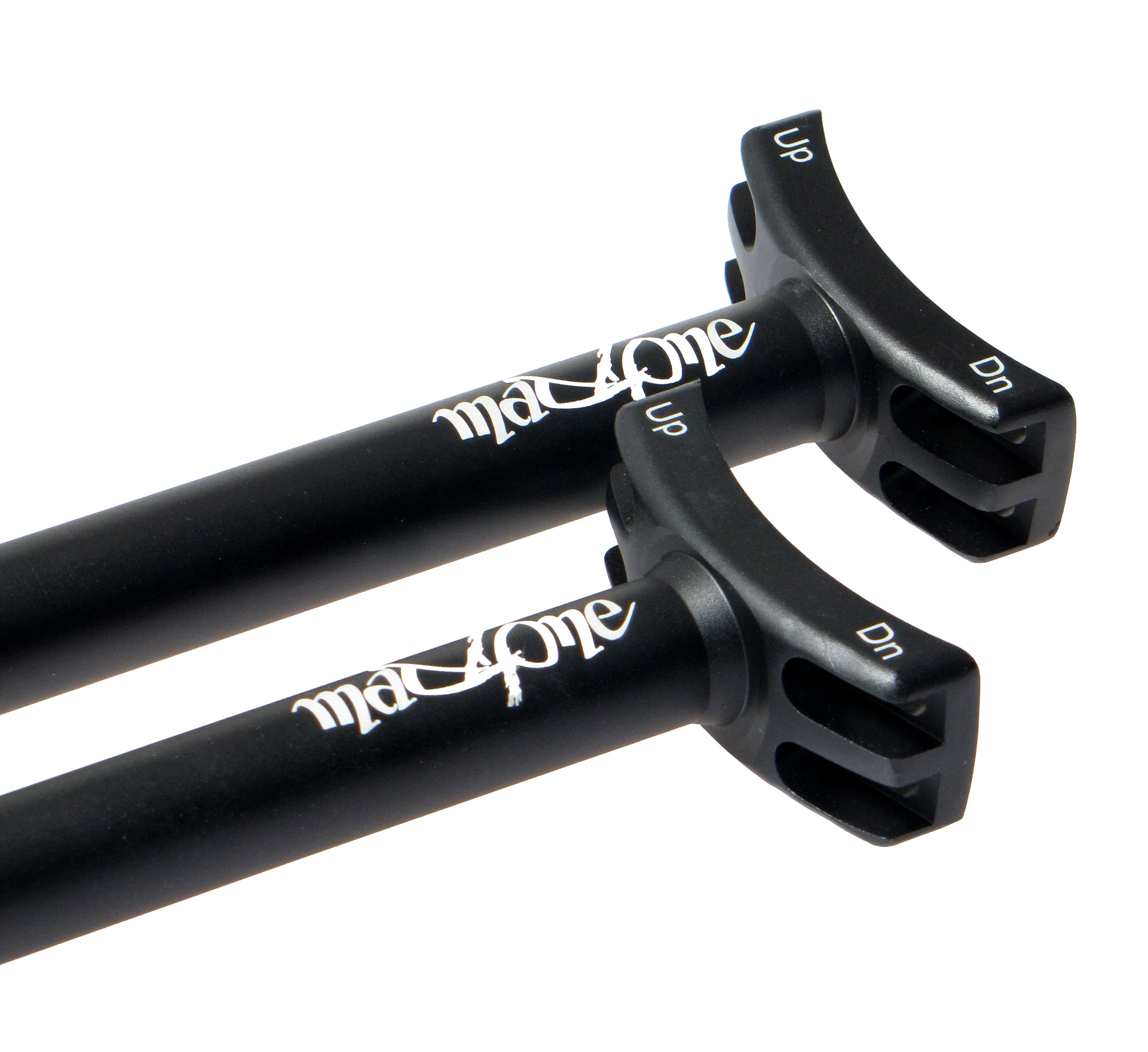

Yes the Mad Extension with URSLI mount does not fit on Mad4One standard saddle.
We invented and developped the Mad4One HandleSaddle to offer a strong light and professional option.
The MadExtension born to offer an extra length to the HandleSaddle.
All this inspired Turtle to make the URSLI BAR to be mounted on some standard saddles. The first problem of this solution is the weakness of the saddle you are upgrading and flatted tubes increase that weakness.
In the picture you see the position of the holes to check compatibility with your saddle.

I agree most all handlebars are missing a needed durable bumper.
This is on my homemade bar, it takes a beating with no damage.

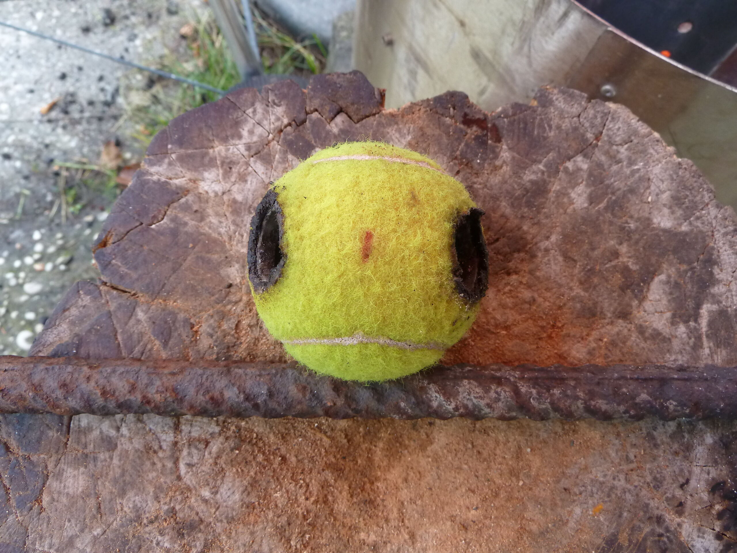

Oh, I saw that before in another discussion. I will consider this on an URSLI bar and will call that „The John McEnroe Bumper“ :tennis:

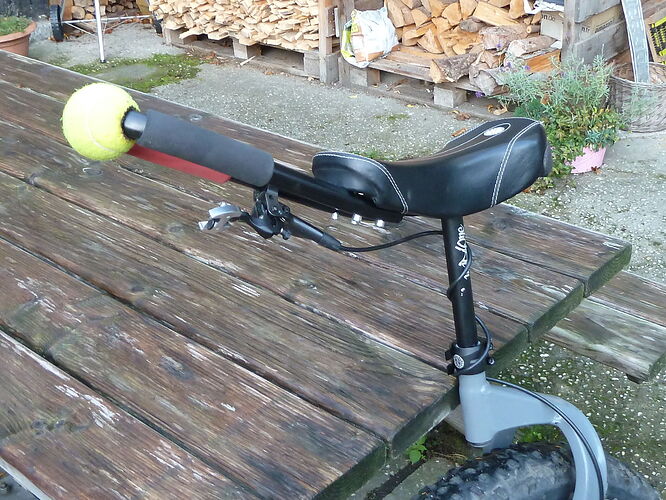

I finally purchased a mad extension @MAD4ONE (aka Ursli-bar) @turtle and installed a “John McEnroe Bumper” @JimT.
I cut two holes in a tennis ball with a pocket knife and extended them with a hot iron rod. In addition to the tennis ball I added two esi silicone grips over the handlebar, I had lying around from a mountain b*ke. Rides great and has already survived a few crashes.
cool idea and looks good!
the bar adds more control on your rides
