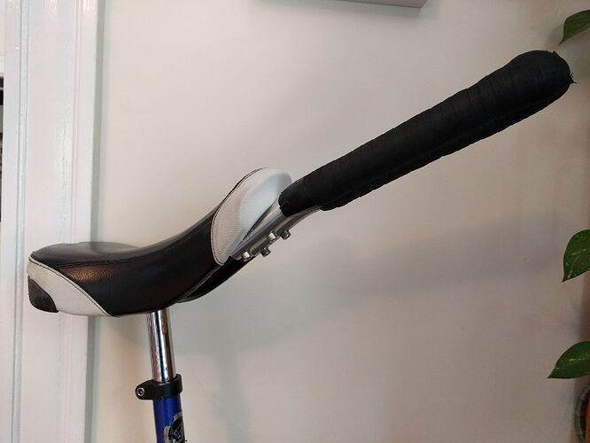

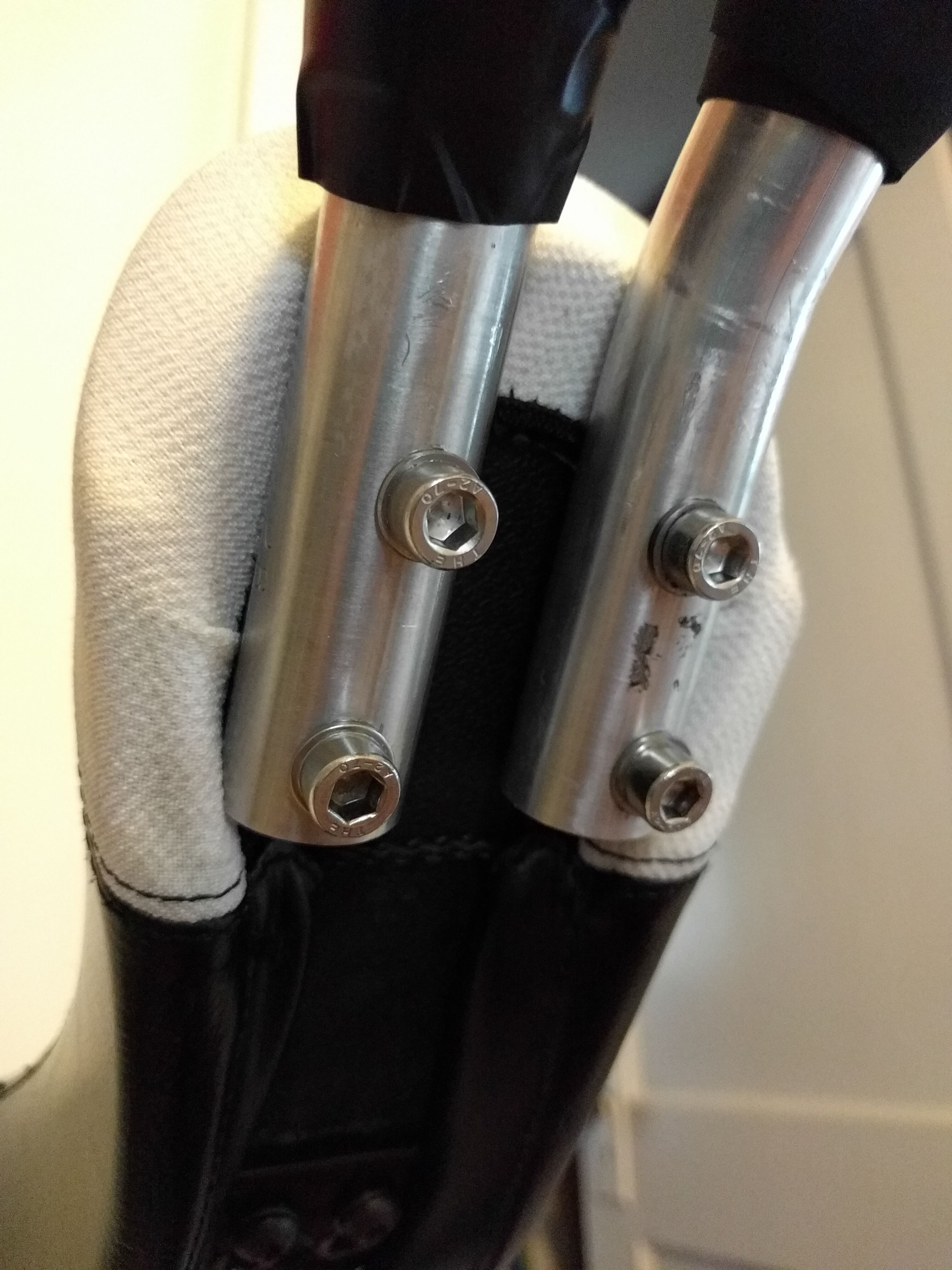

Does any one have a recommendation for preventing the bolts on an Ursli-bar from coming loose?
I bought a used Ursli-bar and mounted it to an older KH Fusion Street saddle. I love riding with the bar, but I am finding that the bolts quickly begin to come loose, even during a very short riding session.
Is it just a matter of loctite, or perhaps applying way more torque while tightening down the bolts?
I am also considering using lock washers under the bolt heads, but it already looks like the bolt heads are cutting into the Ursli-bar’s aluminum tubing, so I am hesitant about over-torquing or using lock washers. I imagine both of those approaches may further chew through the aluminum.
Not sure if there are any Ursli-bar or Mad-extension users out there who might have also run into this problem and found a good solution.
Blue locking compound would be my first recommendation to try.
It’s worth having some around for other threads even if it doesn’t fix this issue.
Something you have to consider with locking washers is whether they’ll actually do anything when tight. The bent single split spring washers are just a normal washer once they’re fully compressed, so only actually help a little once your bolt has come loose.

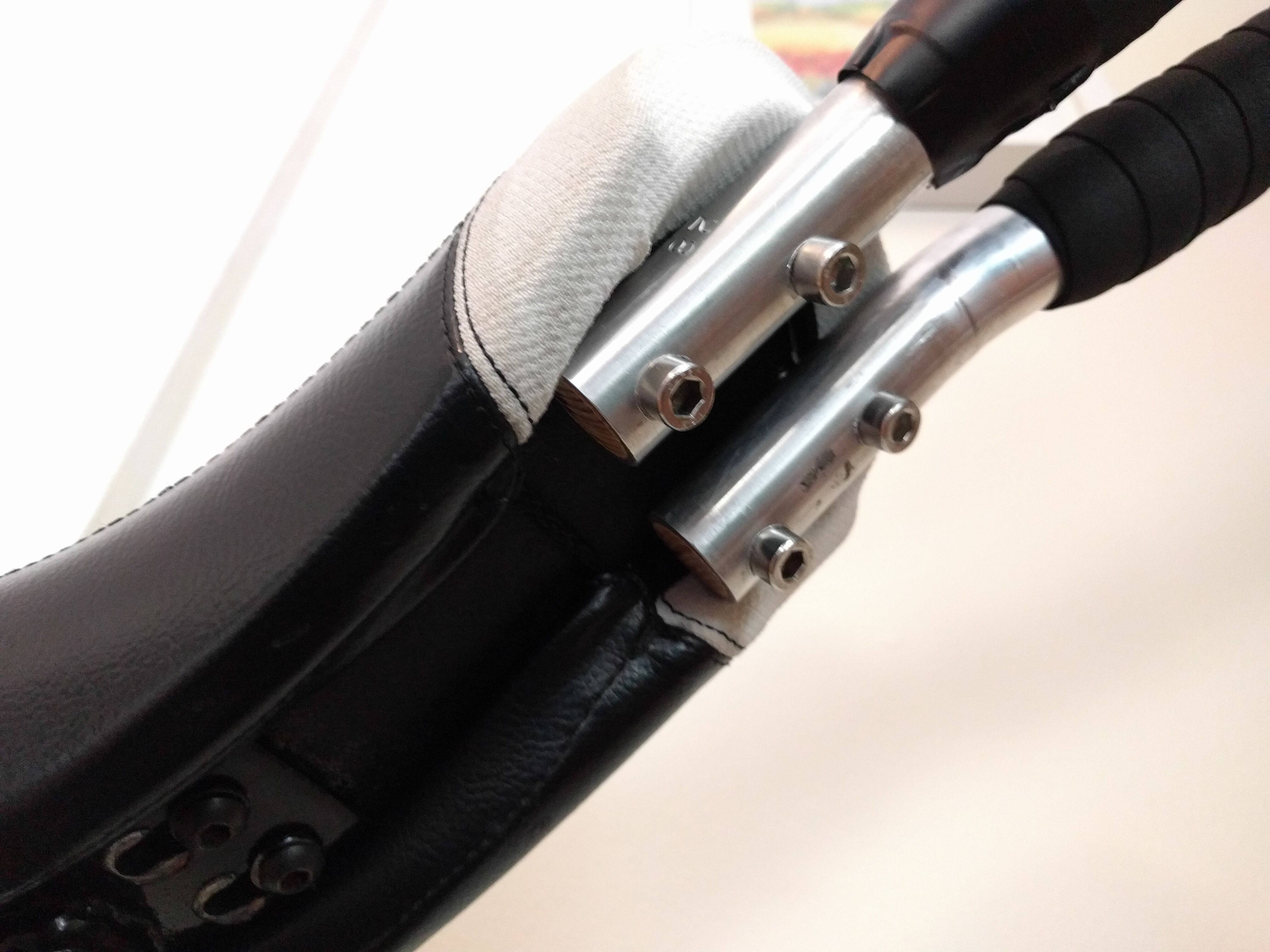

I’ll begin with the caveat that I have never seen one of these and I don’t know what is inside your saddle, so I could be totally wrong here.
However my gut feeling is that there will always be a problem with the bolts slackening with this. A thin round aluminium tube with that leverage with fixings relatively close looks like it would be a problem. It looks like the tubes are plugged to stop them deforming but the bolts are also onto a round surface, and it looks like the holes may be too big. Likewise it is straight onto the plastic of the seat by the looks of things, and I suspect the captive nuts are just into the plastic internally. So I think you’ll get enough ā€˜wiggle’ to slacken the bolts just by the application of forces both up and down and sideways on the end of the handle.
I think your idea of putting something like a ā€˜star’ washer in that will cut into the aluminium a bit would be a good idea. I’d also be tempted to ā€œflattenā€ the tube a bit so you have a greater bearing surface both under the heads of the screws and also where the tube sits on the plastic (that that is probably much less of an issue though). Depending on what it looks like I might also file a flat under the screw heads so they sit better. A proper sized washer might also help a bit with the size of the holes given they look too big (going by the one at the top of your second picture where you can see the edge of the hole).

Everyone, thanks for the ideas.
I tried some blue loctite and put some washers under the bolt heads (not locking washers, but small smooth washers just to provide a slightly larger contact area and to prevent the bolt heads from digging further into the aluminum bar).
I just rode a couple miles and so far no loose bolts. Time and additional miles will tell, but so far, so good. Prior to the loctite, these bolts would have come loose on that ride.

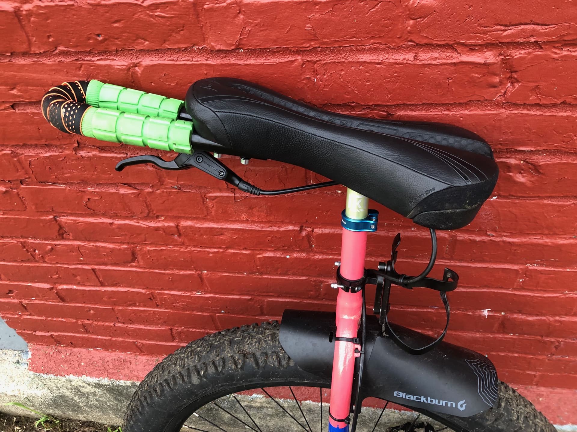

Here’s my 24cm @sedelmeyer mentioned (pictured on a 29er). It is 24cm end to end. It’s long enough to have two to three hand positions. The only time I want a more stretched out position (that is, more than 24cm) is when I’m on smooth asphalt, otherwise 24cm suffices for Muni. The whole setup is one of the cleanest-looking ones, compared to the T-bars, Quax, or even the handle-saddle with the brake mount.
I have borrowed @ruari’s and tested it on some short rides. He has the long one, which is too long for muni (but seems nice for road). I’m leaning towards the Ursli bar though, because I like my QX Eleven saddle, and I haven’t been able to adjust to the tiny handlesaddle seat. I’m not saying I would never be able to adjust to it, but going for the Ursli bar seems less risky (and more affordable).
Thanks for the picture and the info! I agree it’s neat and clean, just like I want it. (OT: What’s that thing above your mudguard?)
