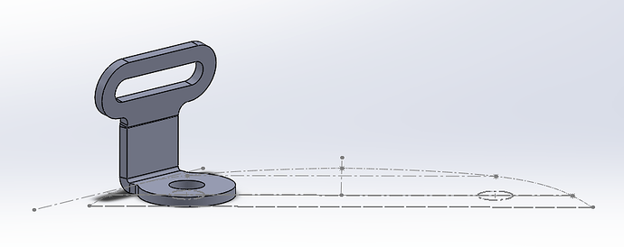

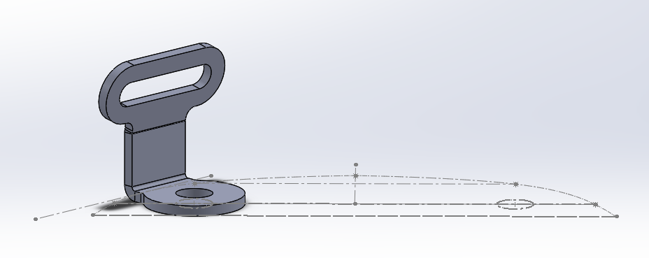

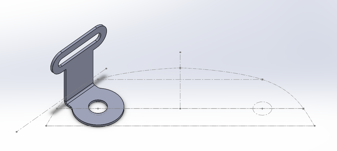

There are quite a few stamped stainless add-on hoops available for bikes so based on that I made a simple symmetrical one for a unicycle base.
I’ve not got a saddle bag yet, or a saddle with hoops to base the dimensions of this on so it’s a bit of a guess right now, but I do have a saddle and a bumper.
Inspired by saddle bags - #18 by JimT

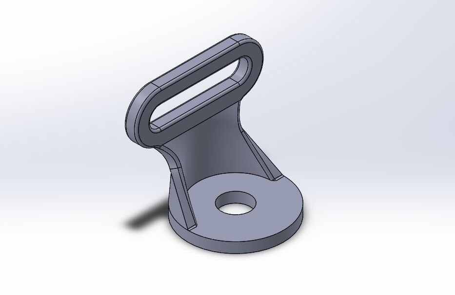

Nice one Robin, how about adding some radius where the loop meets to the tag to reduce the stress raiser.
So completely out of the blue, some saddle bag hoops crossed my path.

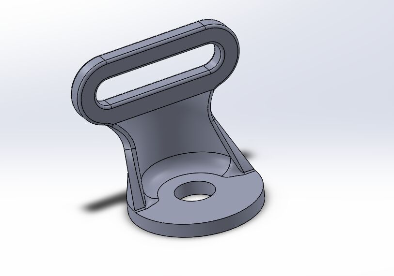

Now dimensionally similar to real life hoops.
And just for fun, a 3D printable version which I’ll try tomorrow.
Layer adhesion clearly will be the biggest issue here, but I’ll print it at 100% infill and see how we go.

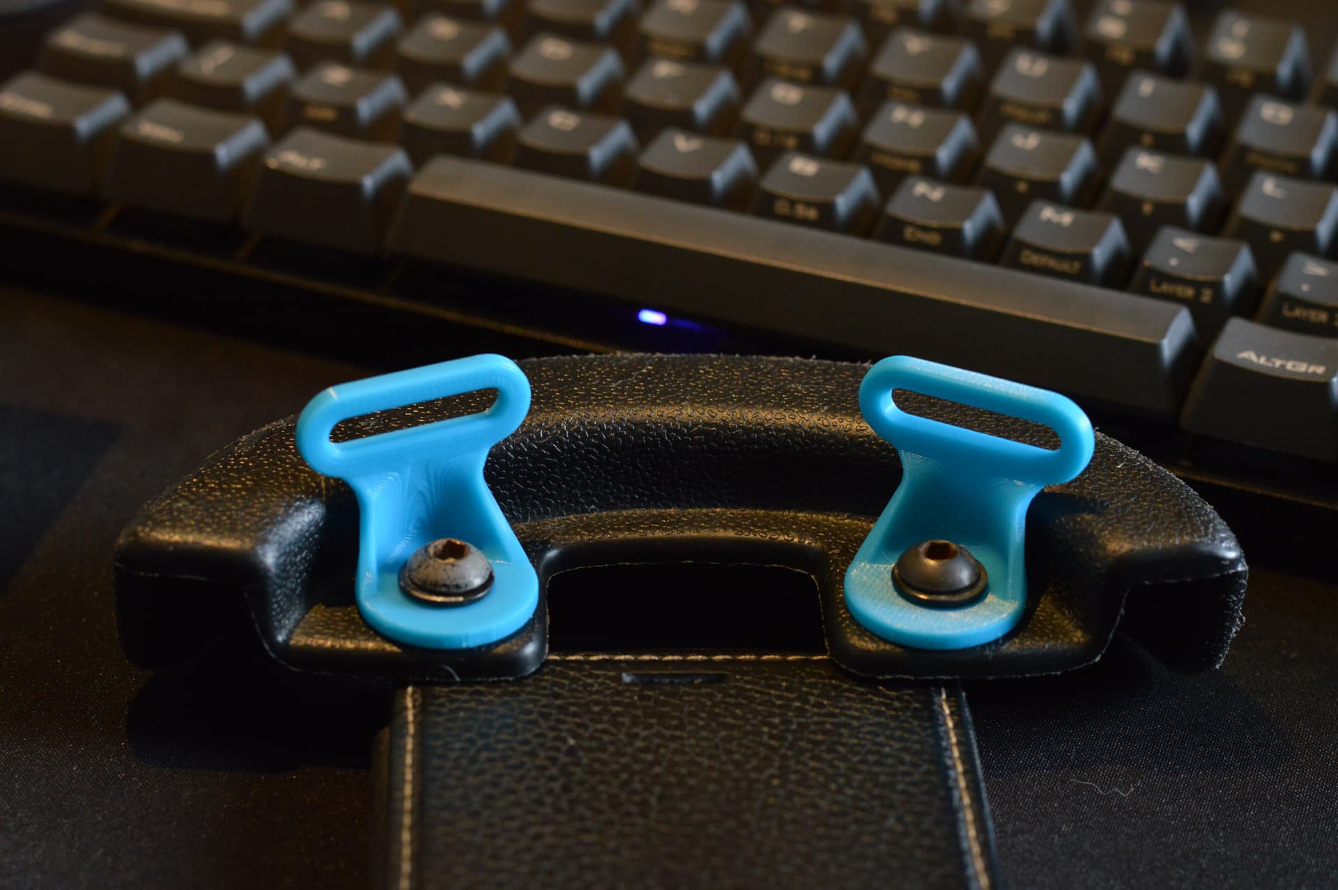

Stuck a bit more fillet on it, and printed them this morning.
Now I don’t actually have a saddle bag to use this with, but they seem strong enough that they’d hold small bags even off-road without issue. They were printed on their back so the layer strength should be less of an issue.
The STL file is here: Unicycle Saddle Bag Hoops by mowcius - Thingiverse

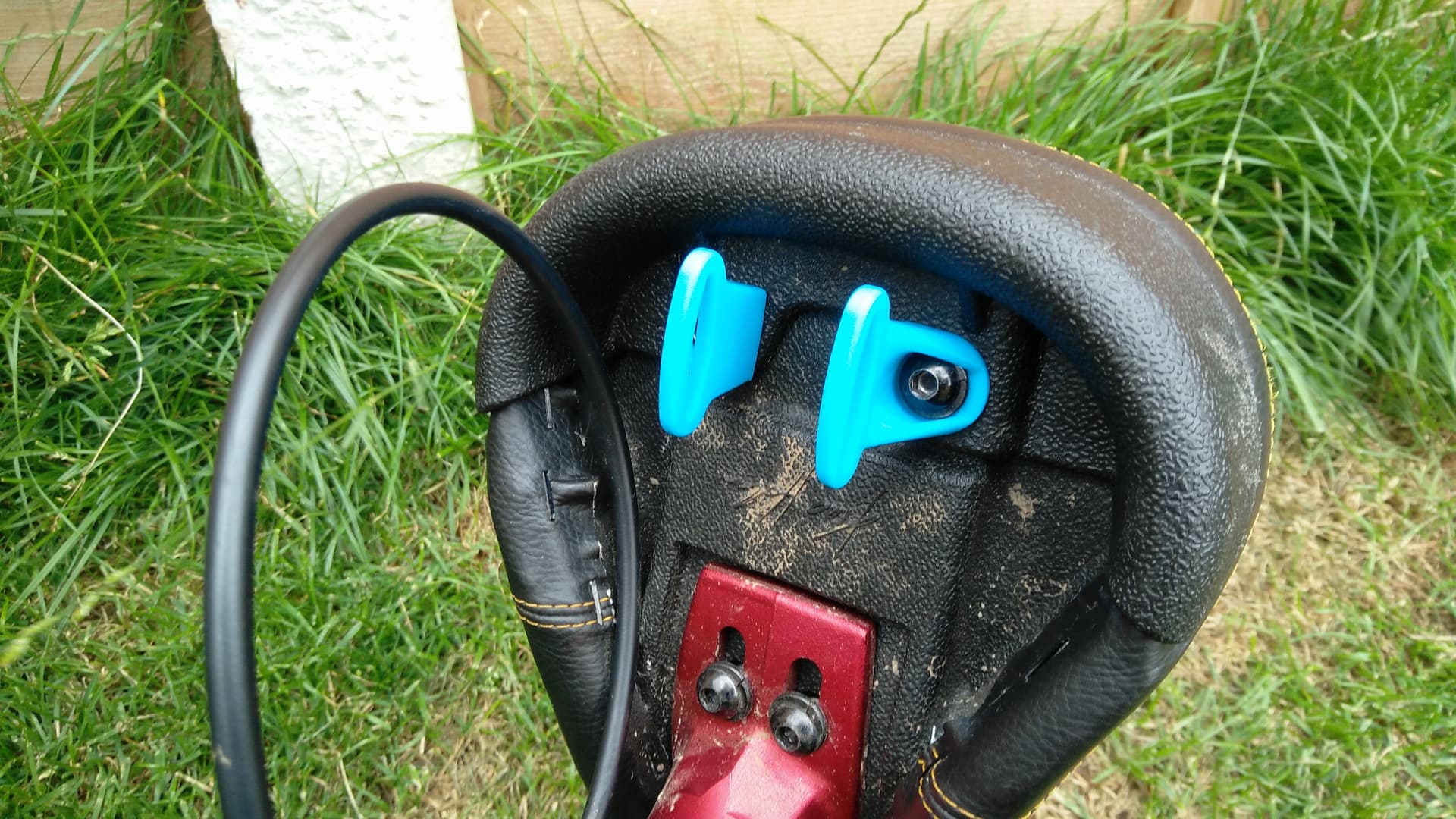

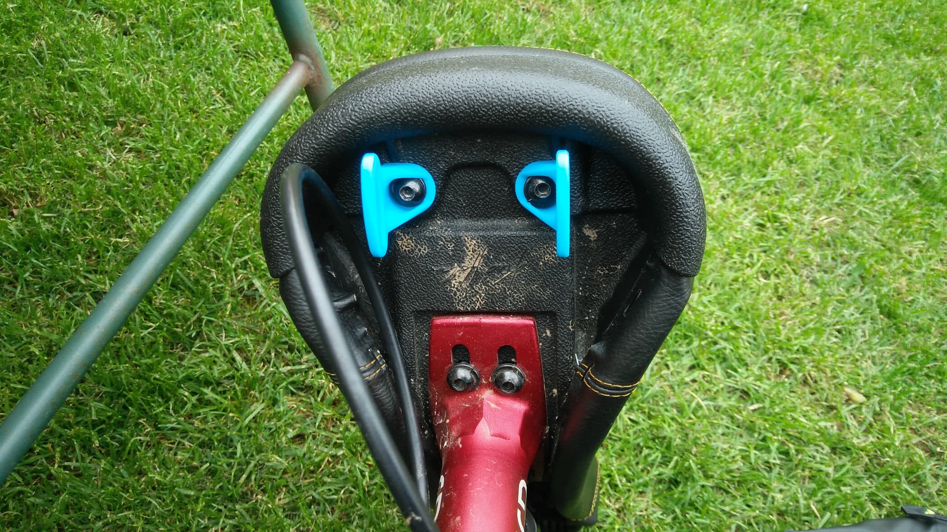

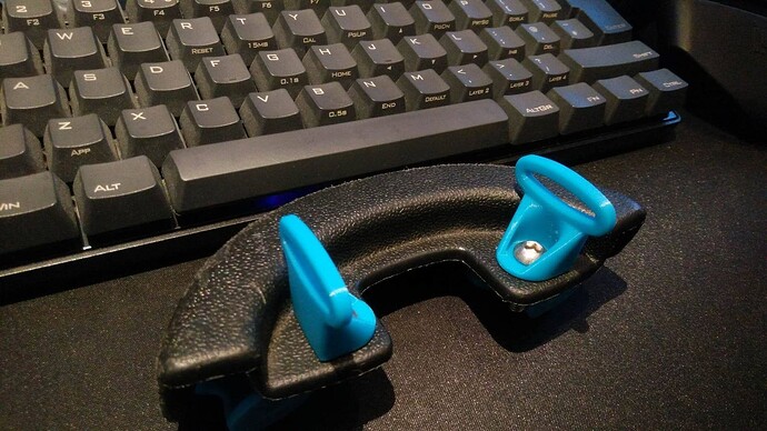

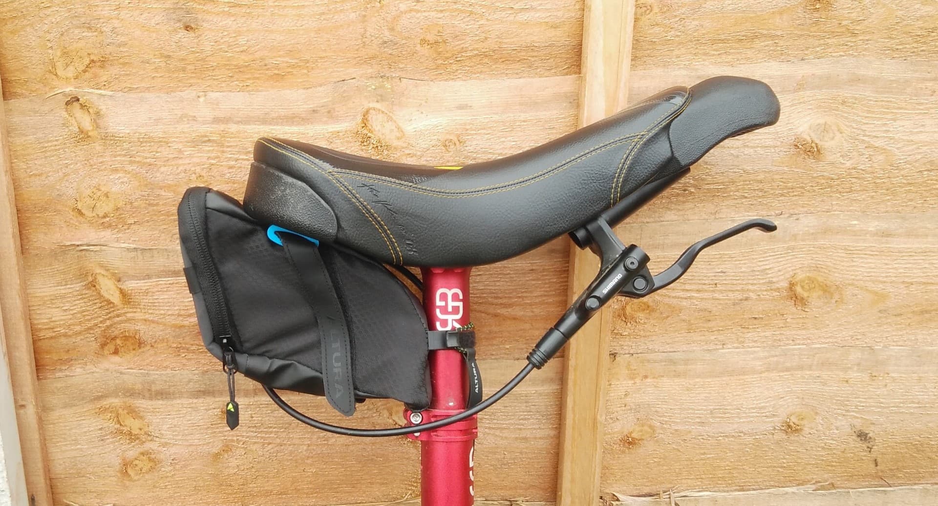

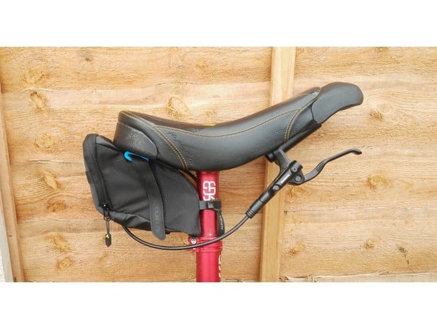

Right, so after some discussion with others, I decided to make some more designed for bags that are intended to be strapped to saddle rails.
They’re about 2g heavier per pair (9g/pair…) but rather stronger, now require no supports to print, and have a smaller base to also fit on more bumpers (the KH Fusion Zero has a small rib in the way of fitting the original ones).
Sending these ones to @Piece_Maker for testing, and I’m probably going to get myself a bag now and print some more for myself.
My saddle bag arrived, so I quickly printed some more.
Unless I smack them on a rock (and they’re pretty out of the way), I think they’ll probably outlast the bag.

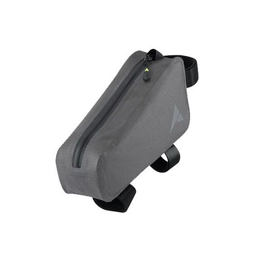

It’d be nice to have a bag that’s designed to mount like this, but which is more vertical than horizontal, in order to reduce the risk of it colliding with the ground.
Altura do a small one, but it’s pretty darn small in volume and only 1.5cm shorter so would likely still hit the ground.
A bit more like the bag that Railigion sell I suppose, but maybe made of a waterproof fabric for MUni and commuting rides.
I wonder what the smallest frame+post size that this fits on is before it collides with the tyre.

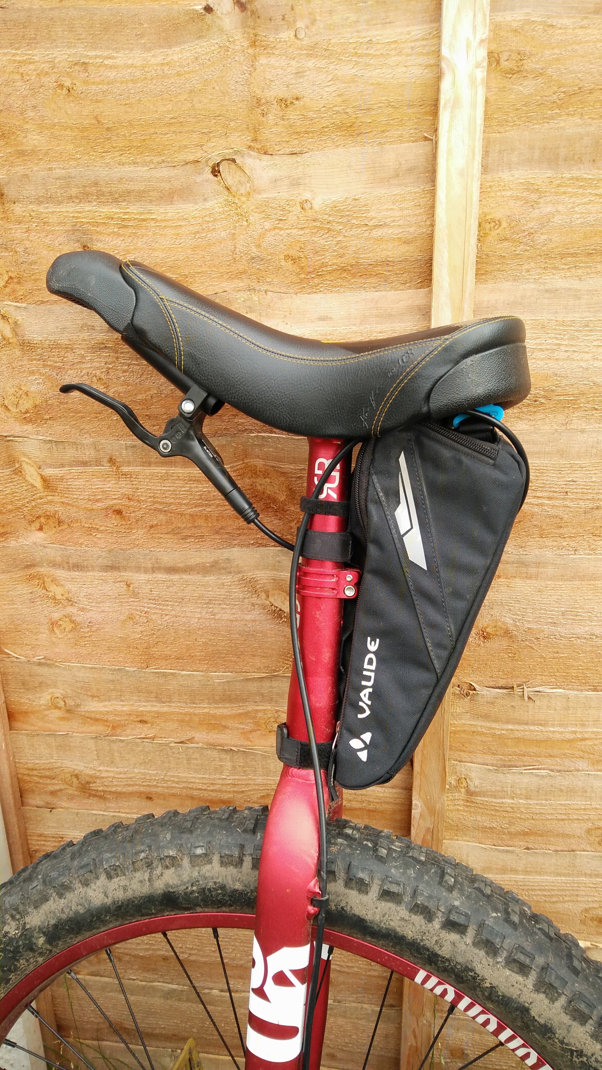

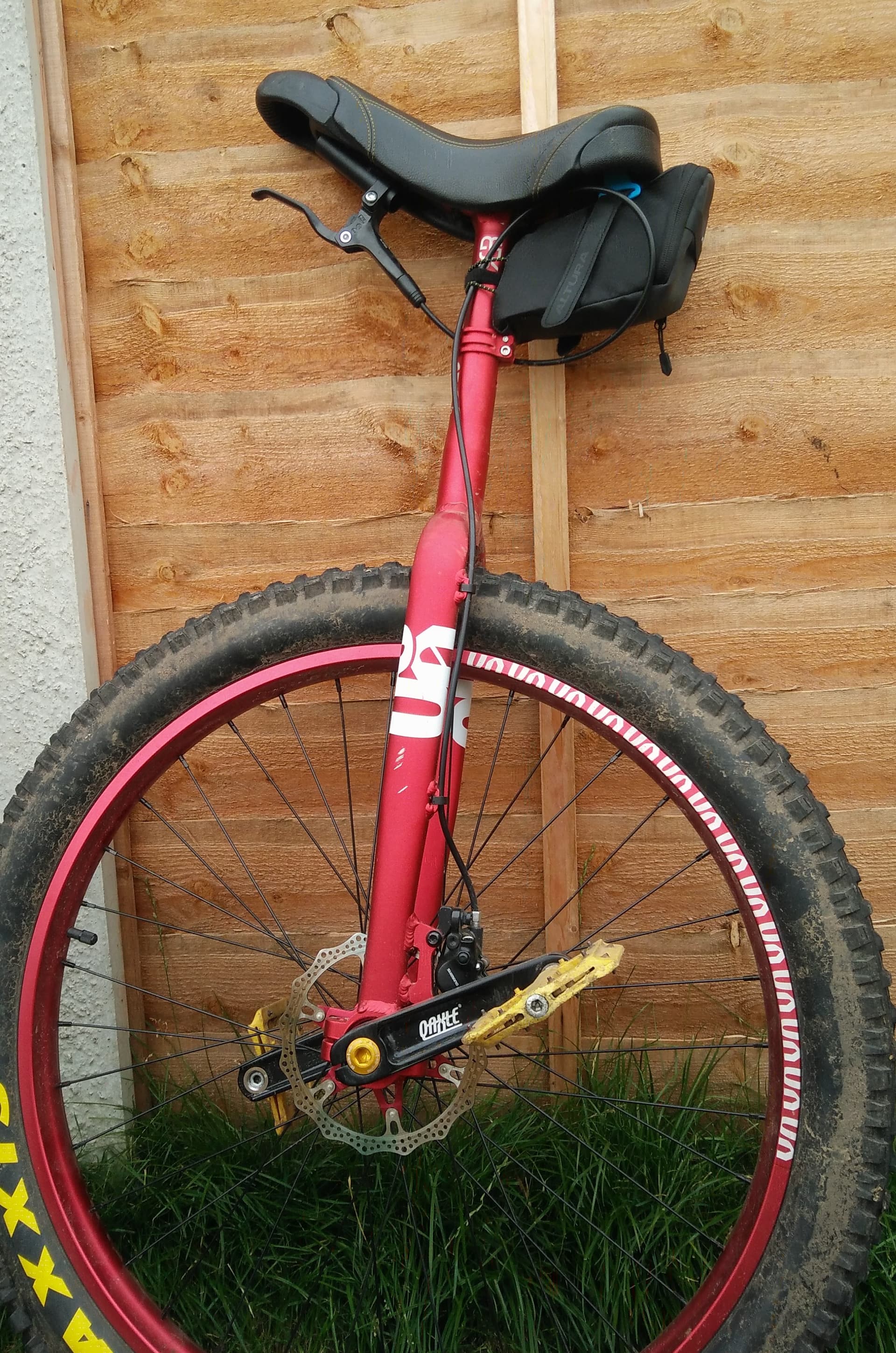

Oooh, actually - a top tube/small frame bag might actually work.
I have one on my 36er under my handlebar… Lemme go and test.
Yusssss
Spin loops around 180 so they’re closer together:
Attach top tube or (as in my case) small frame bag:
Did I… actually make something useful?

Is there enough space for a 10mm socket (approximately 14mm outer diameter) to tighten the nuts for the bumper on saddles with the bolts protruding from the seat base?
So I’d really rather not at the moment, and I suspect that it wouldn’t be worth your while for the cost of postage.
I’d recommend trying to find someone local (or at least in the same country) who can 3D print you a pair (CAD file here). They’re only ~9g and on even a basic printer should take around an hour (which is pretty short when you’re talking about 3D printing).
Ho ho ho.
I knew there would be a gotcha.
I own well over a dozen unicycles with this kind of fixing and still I forgot they existed as the original bumper I measured is just a bumper, and the two unicycles I have in easy reach are both new style KH bases.
The original version does have enough space for nuts and a socket (and even a ring spanner), but does not fit on the new KH base bumpers (due to some reinforcement ridges getting in the way).
I have an idea of how to ensure it fits on both bases, with both fixing types, but it’s going to require another redesign :smiley:

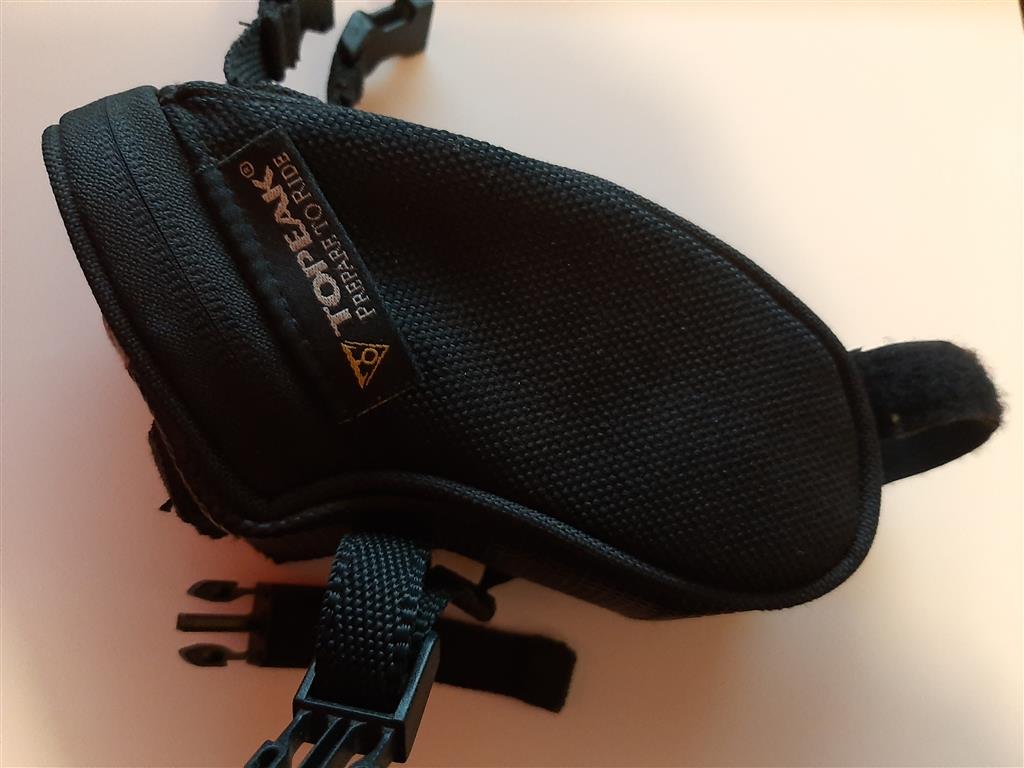

Do you know what bag you’re going to use?
I’ll post some pics once I’ve got the printing done which should be Friday morning.
I’m planning on using a Topeak saddle bag that I’ve had for a few years.
