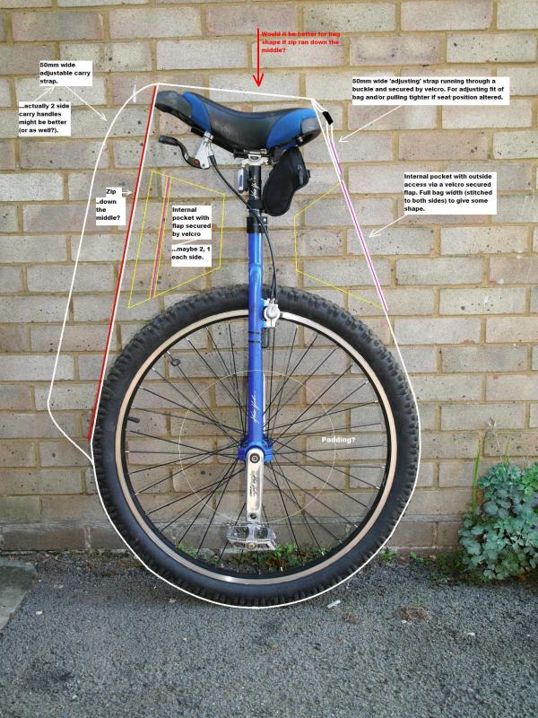

I’m in the middle of working with a small specialist bag maker (from the traction kiting community) to make me a sturdy transport bag for my 29".
He intends to develop 2 styles of bags to suit every size uni - one will be a simple cover to protect it and car seats/bus’s/bedrooms etc and be made from light weight material without any fancy details, the other is going to be a deluxe model with pockets, carrying stap/handles and padding. It will require the pedals to be removed but otherwise will take the uni whole and will be a proper travel bag.
There will be a selection of colours (KH blue for me!!) and as he makes them himself they can be sized to your requirements and any custom features can be added.
So any comments as to what else should be thought about?
His work is at:
The design is based on my original sketch:
sorry ive got bad eyes, can you tell me what the captions on the picture say? sounds great though :slight_smile: bert it would be useful for planes

The outline on the photo looks like it will fit your unicycle very snugly. Is the idea that he’ll make them custom size for whoever orders one, or is a ‘one size fits all’ approach being adopted. If it’s just one size, then you’ll have to appreciate that some people have their saddle a lot higher than you, and that handlebars aren’t uncommon on 29ers.
How small will the lightweight bag fold up to? I’ve got a large padded bag for my uni, but if I was to use it for a day out riding, the bag alone would fill my backpack which wouldn’t leave any room for tools, food or water. If your bag was able to fold up small enough to carry then it might just be practical enough to use.
STM
If you were to do the “one size fits most” approach (probably the cheapest option) then you could build the bag for the largest case, i.e. 29er, w/ handlebars and a tall 300-400mm post then have cinch straps all over the place to “shrink” the bag down to the appropriate size like with what is seen on some trekking back packs. Another nice option would be to make at least one of the fat sides of the pack a bit more rigid and have true back pack straps (and possibly waist belt) attached to it so one could carry the pack like a conventional back pack. The idea there might be that if one is travelling with this pack it can actually be functional when you get to your desination and begin riding i.e. you can pack other stuff in it and ride, or make it easier to carry your uni around?
Each bag is made to order so can be tweaked to suit each rider, if you look on the top right of my sketch you’ll see I’ve suggested a pull down strap to tighten the top. I like the ideas of more adjusting straps and particularly the idea of turning it into a rucksak. I thought of rucksack straps so you could carry your uni on your back while hiking up bad terrain but actually using it as a rucksack could be genius.

I agree with the suggestion to make the bag to fit a wide range of unicycles. I can’t think of a reason to want to walk into an airport with a unicycle-shaped bag. I much prefer a luggage-shaped bag, which attracts no attention. Also, since luggage weight and # of pieces is limited, I always use the uni bag to hold my tools, spares, riding gear (pads, gloves, shoes) and hydration pack. This helps pad the unicycle while also making it look more like luggage.
Also consider a wheel or two (a one-wheeled bag might be fun, but I don’t think it would be fun to drag around), or maybe a toughened spot designed for drag if it’s going to be a large or heavy bag.
If you make bags to fit the wheel and make the top (where the seat goes) long enough for a tall unicycle, you could fold/roll it up and fasten with straps or Velcro to accommodate a shorter uni without being baggy or much excess weight.
Was the expectation to remove pedals? If so you need pockets sized to fit two pedals then as well.

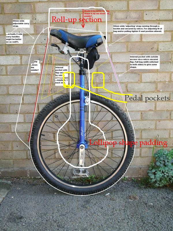

attached pic
You’ll have to put the zipper around the tire so that you can get it into the bag easily.
That looks like a great design for a more generic bag, good idea about the roll down top.
Also you’re right about the lollipop shape padding to protect the frame - I’ll be needing that on my custom bag as I intend to use it for plane transport.

Every single one of your questions/concerns were addressed in his initial post…wait for it…wait for it…if only any of you could LEARN TO READ!
The implied suggestion to increase the picture size is a somewhat valid point. However, for you and others for future use. If you’re using Opera or Chrome or possibly FireFox (I’m not sure) you can increase the size of the page including pictures with the browser’s built in zoom feature. This allowed me to zoom in to read the captions perfectly. If you’re not using one of those browsers (that’s kinda stupid, but…) you can download the picture and open it with whatever image program you use and zoom that in.
It’s understandable that many of you couldn’t read the original captions, and therefore missed out on things like the extra pockets (for pedals or whatnot, the he explicitly stated must be removed) and the cinch strap on the back of the saddle. It’s understandable, but not an excuse for not attempting to read them and THEN ask your questions.
And…seriously…“a zipper would be necessary”?..do you REALLY think that both his plan, and the bag maker would forget how to get the unicycle in??? SERIOUSLY?!?
