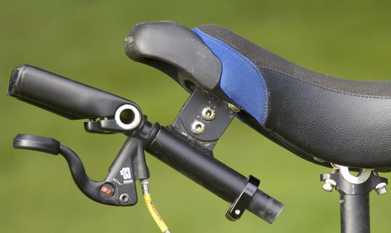

One issue I can think of would be figuring out how to mount the brake lever if I also want to get the KH handle. (short version like KH uses). If it’s mounted on the handle, (on the tubing below the “T”, just under the front of the saddle) it puts the lever almost out of reach because it’s so far below where it usually is when mounted on the traditional brake mount. There’s really nowhere else to mount it, that I can think of anyway.
IMO, at first you really miss having the brake lever directly on the handle. Then you start to get used to it, and soon it feels really normal, even preferred. It’s worth trying out the brake positioned on the T-bar (between the bar ends) for quite an extended period, on lots of types of terrain, before making a final decision.
The only kinds of riding I’d still prefer to have it on the saddle handle are the kinds where I’d also prefer not to have a handle at all - freeriding on my singlespeed K24.
I do suggest cutting the T-bar narrower (mine is 120 mm wide, rather than the 150 it comes with) if you mount it low and close to the saddle, to avoid hitting it with your knees. For the furthest back position, flip the slotted tube mount so the seatpost clamp is towards the back. Also, when the T-bar is close to the saddle, it moves the tube angle up, which means you can angle the bar-ends down, bringing the brake lever closer to your fingers. Definitely it’s worth playing around quite a bit with the 3 aspects of adjustability on the T-bar (length, angle of the bar, and angle of the bar-ends).
Kris
Can you post some pics of your G26er with the brake? If mounted to the T bar would the standard 18" maggie main line need to be longer? UDC has just 2 lengths that I know of; 18" & 30". But some pics of your setup would be great!
Terry, check out this thread: T-bar discussion thread
edit: I see you actually posted in it;))

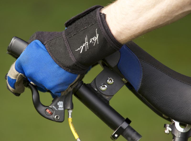

Attached are two photos. This is the closest I’d use. Furthest would be maybe 3 cm further out (e.g. the length of the extra tube sticking out the back). Mounting it fairly low lets me lean on it, and having it close to the saddle means that I can pull straight up on the handle to unweight over bumps.
This setup uses an 18" brake line on my KH26. It is pretty much at the limit of fitting, with one wrap around the seatpost tube. If I was taller I’d need a longer brakeline.
K.
Like the first post in this thread? T-bar discussion thread
Thanks. I’d forgotten about that thread plus, it was possible that Kris might have modified his setup a bit.
Thanks Kris, it looks good! Are those the newest version Pulse gloves? UDC says that they’re expecting the new gloves a bit later this month.
Yes - those are close to the appearance of the new gloves. The photo shows a prototype with grey palms; production are black.
There’s one more new item in the photo; can you spot it? =)
