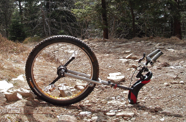

-build a 26er like mine for very versatile mixed riding, you’ll love it!
But as others have mentioned you should try not to abuse it with too technical terrain and high drops. Keep those things for your ungeared unis. The 26" is definitely my favorite uni and it would be the last one I would ever want to part with.
Another thing to keep in mind is that one has to keep an eye on the crank bolts and retighten them once in a while with a proper torque wrench at no more than 40Nm.
Confirming my thoughts exactly. What tire is that on you 26 guni?
That’s a Continental Rubber Queen 2.4. Very nice tire IMHO, very light but still more robust and better tread than a Racing Ralph. I also prefer it to the Muddy Mary and the Gazzaloddi. Haven’t tried much else either. I did get a pinch flat recently when I went over a very pointy stone with too low pressure. So now I’m running a serious DH inner tube with it and I keep the pressure somewhat higher.
Thanks for your advice; it makes good sense to me! But I have t ask, do you have the square taper Schlumpf on your 26er? I guessed this by the looks of the cranks, which don’t appear to be isis. oh, and is that the standard 18" maggie main line?
You’re welcome! That’s the ISIS muni version and the cranks are Nimbus Ventures 150mm. The brake line is the one it came with. Haven’t had any problems with it so far (no super technical terrain).
