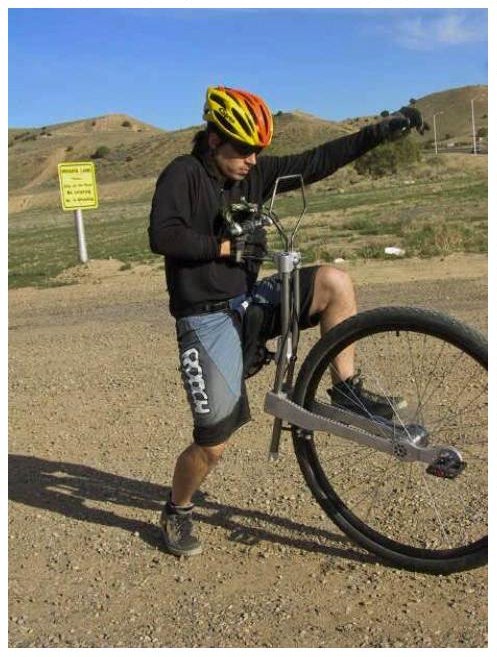

This is from his website:

That frame is so cool!
I am seriously considering a 26" guni wheel. I just want to confirm 100% that it will work in my conundrum frame and mountainUni set-up, if not, I may buy another frame :slight_smile:
What other frame will work?
