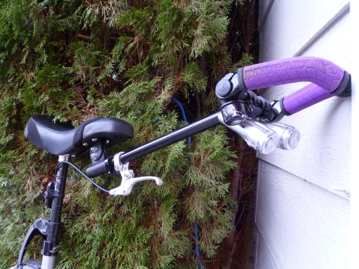

Personally I have 3 setups on the unis I mostly use:
  1. No T-bar at all, for pure technical downhill (North Shore) riding on my 24" muni.
  2. T-bar in a low, short position, with the brake close to the saddle, for everything else offroad, on my geared 26er.
  3. T-bar in low, fully extended position for gravel and paved road riding (e.g. on my 36er)

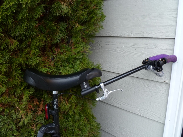

For #2, the lower position means I can lean forward onto the handle even though it’s short, and the short position means I can keep stable and pull up hard on the handles over bumps while keeping hold of the brake. I used to wish I still had the brake lever mounted under the saddle handle for technical riding and drops, but since using this setup I actually prefer it where it is for most conditions.
I cut the T-bar width narrower (to 120 mm) so it doesn’t bump my knees in the low, short position, and the excess T-bar tubing is cut off. The slotted tube is flipped backwards (clamp towards the rear) to allow the shorter position. The T-bar is angled up, with the bar-ends slightly down, to move the bar-ends closer to the brake lever.
Attached is a photo of #2. This is in a really short position; often I might move it maybe 10 or 20 mm further forward than this. The bar-ends in the photo are Carbon and have since broken - currently I’m using the standard spec bar ends.
I don’t personally have experience with putting Tri bar style elbow rests on the T-bar, instead of bar ends, but I know some riders like that for really long distance riding.
Anyway, it would be cool to hear your thoughts and see what ways people prefer for their own setups.
Cheers,
Kris

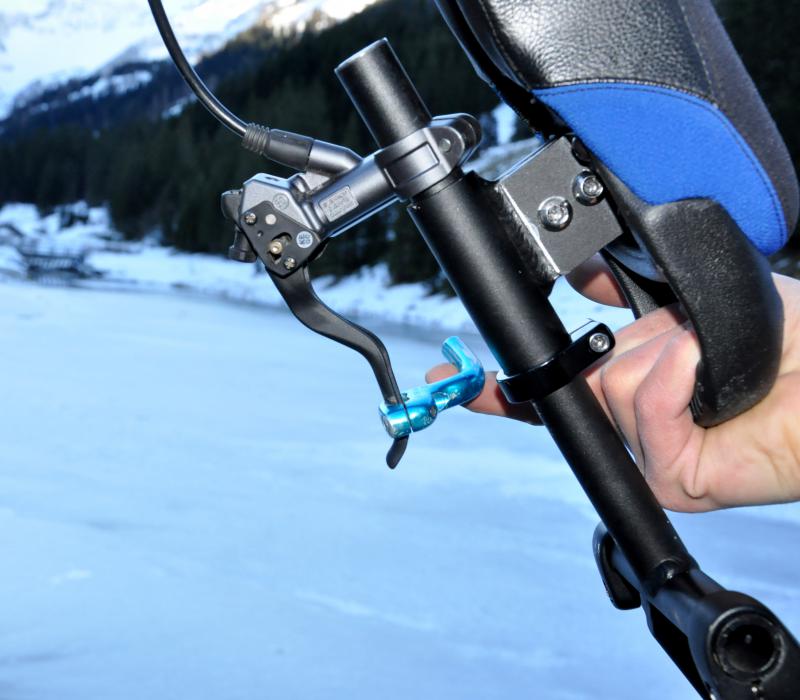

i’d like a “all for one” version, i cut the thing which holds the T-bar and drilled a hole closer to the saddle , so i can reach the brake lever from the normal seat handle… (but not very easy, thats why i’m making a longer lever extender… not ready yet), but i like to ride all mountain with some cross country in it but also some real technical downhill in the same ride…

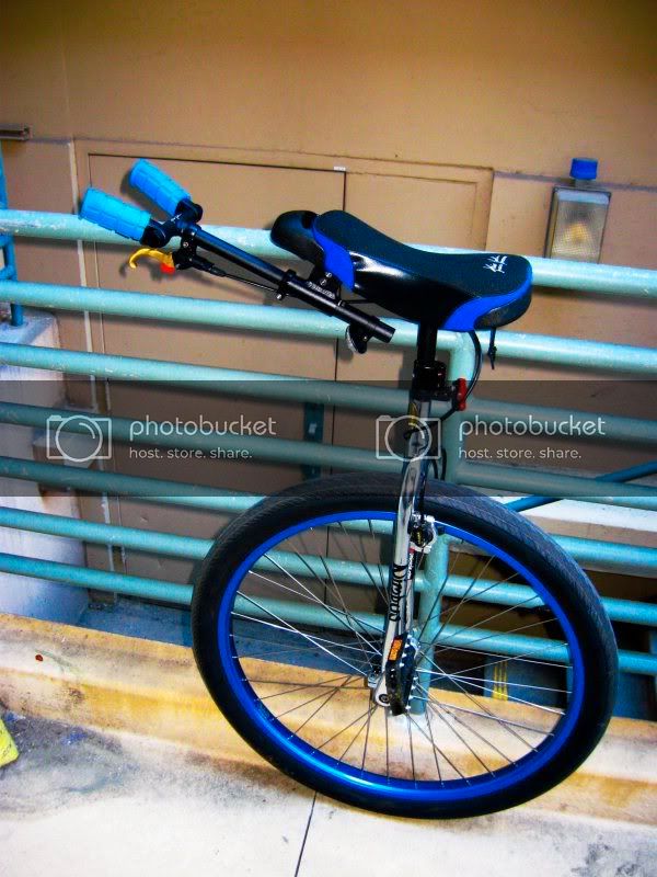

funny thing is i didnt take the picture. someone from school took the picture and through mututal friends on facebook, i was connected to it. i thought it was kind of cool. you can see it but it is ulocked to the bars. = ]
My T-bar is set up on my Coker Big One with a 2010 KH Street saddle.

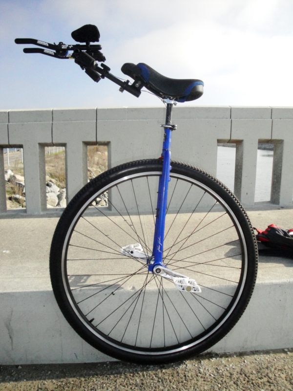

I just extended the length of my T-bar by using a straight “T” from a Nimbus Shadow handlebar (the “T” alone is $20 at UDC US). This extended the handlebar out about 4.5" or 115mm longer than the longest setting for the standard KH T-bar. I’m tall with long arms, and found the extra length to feel very natural and comfortable. I didn’t perceive any lack of stiffness from the extra length. Note this is with a 2009 T-bar; the 2011 is going to be ~70 mm longer. Good move, Kris. Even so, someone who wants maximum extension could still gain some length by switching out with the Nimbus “T”.
The Nimbus bar is also a little wider than the KH. I’ve run the KH short before on my 29er for trails, and found that it’s too wide, because you hit your legs on it in UPD’s (I like Kris’s setup cut narrower, and will probably do this for my 29). However, when stretched out far from the saddle on a 36, hitting your legs on UPD’s seems to be less of a risk, at least for me. I’m liking the handle a little wider for two reasons: I think it’s helping my stability when holding with both hands; and the extra width gives me enough room to mount two headlights and a bell (on the KH I could only fit one light and the bell).
Although I’m liking the add-on of the Nimbus “T” in the KH T-bar base on my 36 setup, I still like the KH T-bar overall better than the Shadow handle (although I admit I have not tried one). The adjustability of the T-bar just can’t be beat.
Forgot a couple comments: For rougher dirt rides, I might still swap out for the shorter T. However, today’s ride had lots of bumpy ice, mud, and deep muddy icy puddles (fun!). I intentionally held onto the long handle through some of the tougher conditions, and was surprised to find I didn’t have any problem with it.

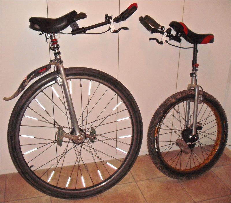

Here are my two setups, one short for muni and one long for 36ering:
Maybe I should add some explanations to my picture:
I replaced the stock bar ends for round ones on both setups so I could put some grips on them.
On the 26er I got straight ones that are about 2 cm shorter than the grips, so in a upd there’s some suspension before the actual metal parts hit the ground. For the same reason my brake lever is mounted further back and pretty loose.
So in a upd I don’t have to worry about my uni that much anymore.
I also shortened the boom of the T-bar, by the way.
When going downhill I usually grab the T-section part of the bar (which I covered with foam grips) with my right hand and use the middle and ring finger for braking with the spooner. My left hand sometimes flails around when going through difficult terrain or it holds onto the left bar end for some addad stability.
This setup has been going strong for quite a while now, so I can really recommend it. It may be a bit narrow for people with bigger or thicker hands, though.
On the 36er it’s pretty much the same except that I use the longer bar ends that bend inwards. They’re not too tight so in a bad upd they can turn and absorb the shock somewhat. I think I pulled the bar out as far as possible on this one and it could still be a tad longer for my taste.

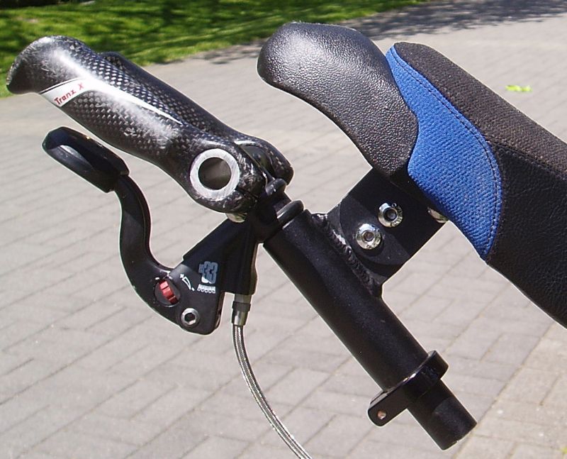

my solution:

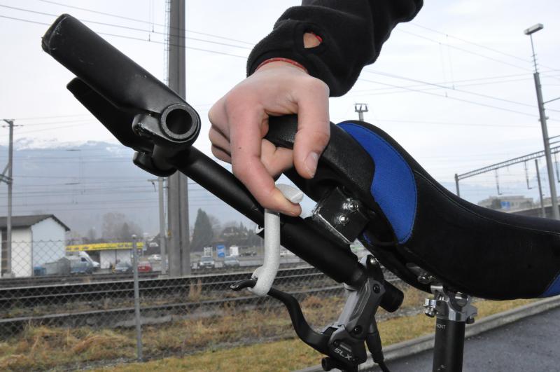

an other option:
Hey turtle! Your above setup looks really great to me!!!
Quick question: did you design and make the grey extender yourself, or did you find it off-the-shelf?
[EDIT] You said earlier on: “i’m making a longer lever extender”… I guess this is the one shown above, right?
Also, did you keep this setup, or did you give it up after a few weeks/months?
Cheers, MadC.

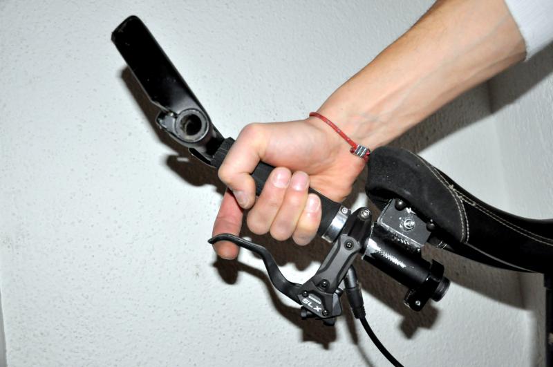

perfect timing, yesterday i posted in another thread my prototype (second pic is how i used the kh T-bar the last months which worked perfect!
it looks very interesting but what about jumping ? the first solution seems better (?)
Yeah, jumping is no problem, well that is unless you land poorly :roll_eyes:
I’m just not into the double hand position for muni, a single hand works best for me when I need extra control/power. I can ride ambidexterous, but what I find is that if the trail is easy enough for two handed riding, then I can ride no hands :slight_smile:
