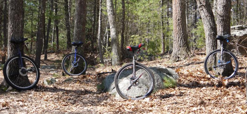

The Versatile KH 29er!
Seatpost or “hole-less” lift handle?
Seat or handle?
Nice - hole-less handle is it =)
haha, I win! But I could only guess since you couldn’t actually tell from the pic.

All these 29ers are cool, and versatile… one of them is a KH!
