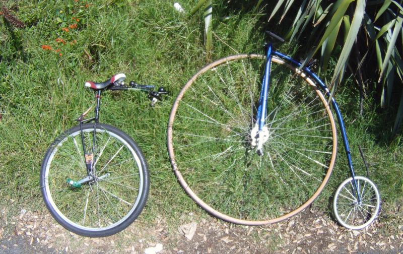

After yesterday I got the feeling that my 36" is very small. I rode Andy Fraser’s 58" custom hand built Penny farthing for a few hours. He says you can get aluminium rims any size now but he made his rim out of wood. Bigger is definitely faster. Better for falling harder too. The solid tire is very bumpy over bumps but Andy made it around lake Taupo (100 miles of hills) in just over 8 hours on it. He uses clip in pedals.

Yes and yes, to a point. A 54" unicycle is probably less crash-prone than a 36" Schlumpf in high gear. And of course bigger means heavier. That penny farthing wheel looks relatively lightweight for its size; kind of like what we’re talking about in this thread. If you make a bigger unicycle, you magnify the problem of rotating weight. But it looks cool. That bike sure dwarfs your 36"! I’ve ridden a 63.5" unicycle, once. The wheel was very light, but it was made more for demonstration riding than cranking out distance. It was a rectangular cross section, solid piece of aluminum, with a solid piece of rubber stuff of similar dimensions glued to it. And the seat was built into the frame for the lowest-possible seat height. Even then I was barely able to reach the pedals (the builder was a tall guy!).
Impressive. When we passed Taupo last year, I could see how it must be a beautiful ride, like our Tahoe ride only longer. And that day it was really windy! Almost like the Unicon Marathon day. :slight_smile:
