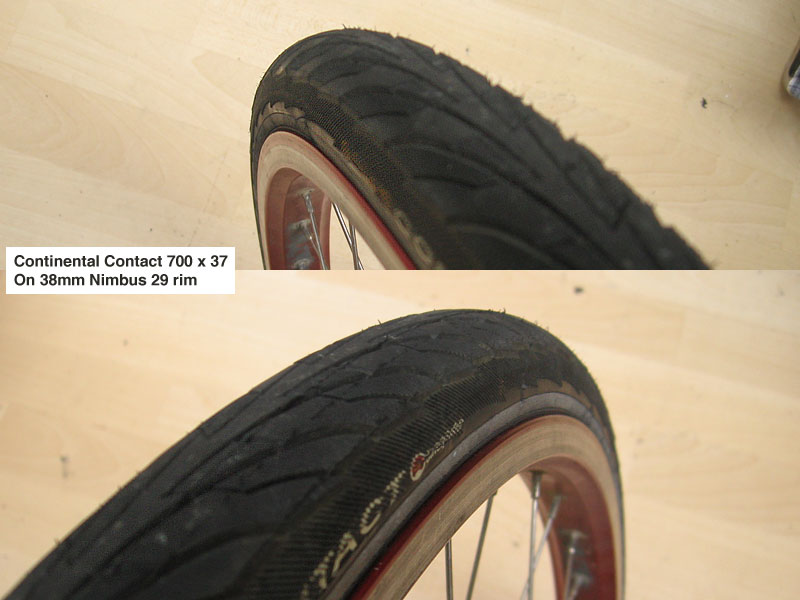

Just to visualise the shape of this idea, I mounted a 37mm tyre onto a wide 38mm rim. That’s at least as wide, if not even wider than 36 rims.
It looks fine to me. 36" tyres bulge a lot out from the sides of the rim, but this goes straight up in line with the edge, like road bike wheels do (which makes removing a wheel with brake pads fitted much easier).
