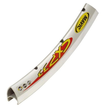

Road bikes/racing bikes generally have extreme high profile shaped rims for optimum strength and aerodynamics.
A 36er rim made this way would probably be much stronger than the current, much more square shaped stealth rim.
The older “airfoil” 36er rim had a fairly tall profile, and it was amazingly strong. I did tons of good sized drops with mine and the wheel never went out of true. It’s like an arched structure; they are incredibly strong and can withstand far more weight and resist downward force much better than a flat structure.
Oh I meant more for the side-to-side bend. Like what might happen if you crashed and your uni tumbled into a guard rail or something.
