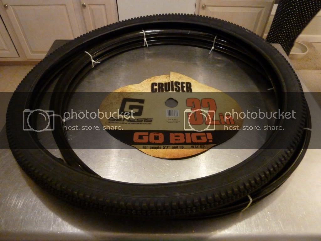

I tried to ignore the urge, but it just wouldn’t leave me alone… Fast forward a few months, I was talking with Josh at UDC and he mentioned the Walmart 32er and how cool it would be to build up the wheels for a unicycle. The plan formed, Josh agreed to build the wheels if I supplied the parts…and off to Walmart I went.

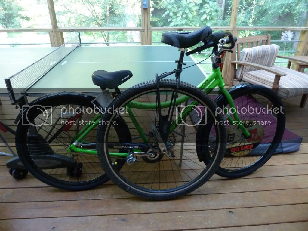

They had a big ole display of the Genesis 32" Super Cruiser, color choices distracted me for a moment, would it be green, red, or blue? I spun a few wheels, skipping the bikes with flats :astonished: , and chose a nice neon green beauty. I paid my $199 plus tax and road her to the car. I drive a Honda Element, not a small vehicle, but even with the seats out it was a struggle to get these beast of a cruiser into my ride.
Away we went, home that is, no stops, it was demolition time! My wife begged me to reconsider, she said: “Why not wait until Alex gets home so he can ride it?” I then suggested Mrs Nurse Ben ride it first, so down the road she went, a whole twenty feet before exclaiming: “this thing is a pig, who’d ride a bike like this?” :roll_eyes:
Two hours later the wheels were broken down and ready for shipping to Unicycle.Com headquarters in Atlanta, Georgia.

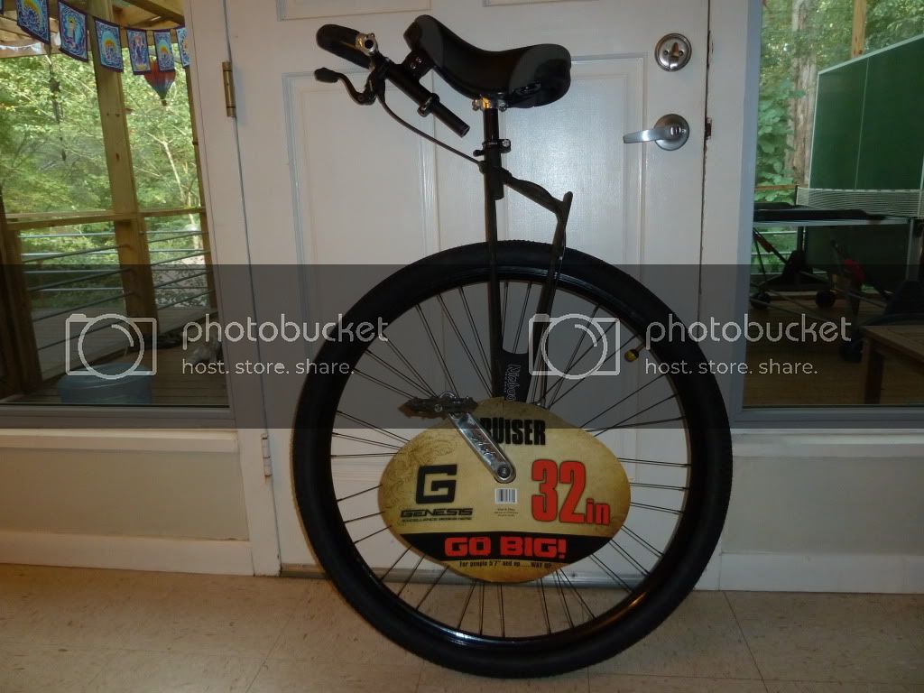

And now, for your viewing please, I bring you the Super Cruiser 32" Unicycle…
Who would have thought that Kent and Walmart would the ones to bring us the first production 32" wheels?

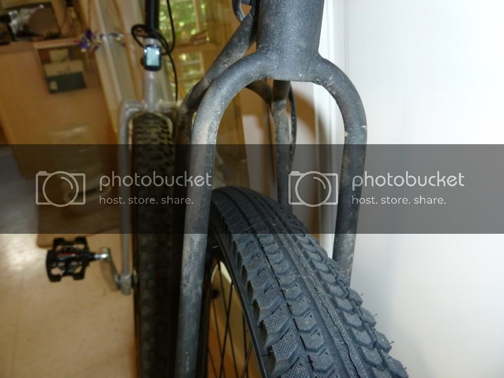

And for my next trick, watch me build a “Sakatchewanian style” Racing Ralph 2.4 custom tire for this little lovely :stuck_out_tongue:
This sounds like a fun project. It doesn’t seem practical unless you have some sort of reliable source for replacement tires. I assume you can get away with 29" tubes, but I would want to know I could always get a new tire.
So, I’m curious about this “‘Sakatchewanian style’ Racing Ralph 2.4 custom tire”.

The way it’s set up now, it is a very nice road cruiser, not really a trail rider, so that’s the reason I’d want to make a better tire. Saskatchewanian has been making tire by combining two smaller tire to make a great big one. He did for a 36ers, of course now we have a good trail tire for the 36er…so I’m going to follow his lead and make one for the 32". He has a thread or two out there on his projects.

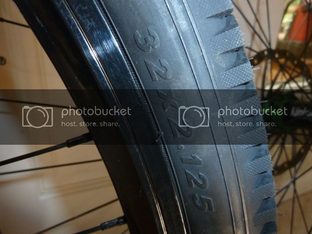

It’s a nice cruiser, the tire they made for this wheel is pretty durn good considering the source. The wheel built up fine, some odd lacing, 4x, but it tensioned well and has no signifeicant flat/low spots where spoke holes were skipped. A 32h hub would be a better hole skip pattern and of course a 48h hub would be a straight forward lace up.
I did some simple calculations comparing rim sizes and it appears that the 32" rim has the same size step above the 29" as seperates the 26" and the 29" (2.5"). This makes sense from a design perspective, though I wish the step was larger in order to place this wheel solidly between the 29" and the 36" (~3.5" step).

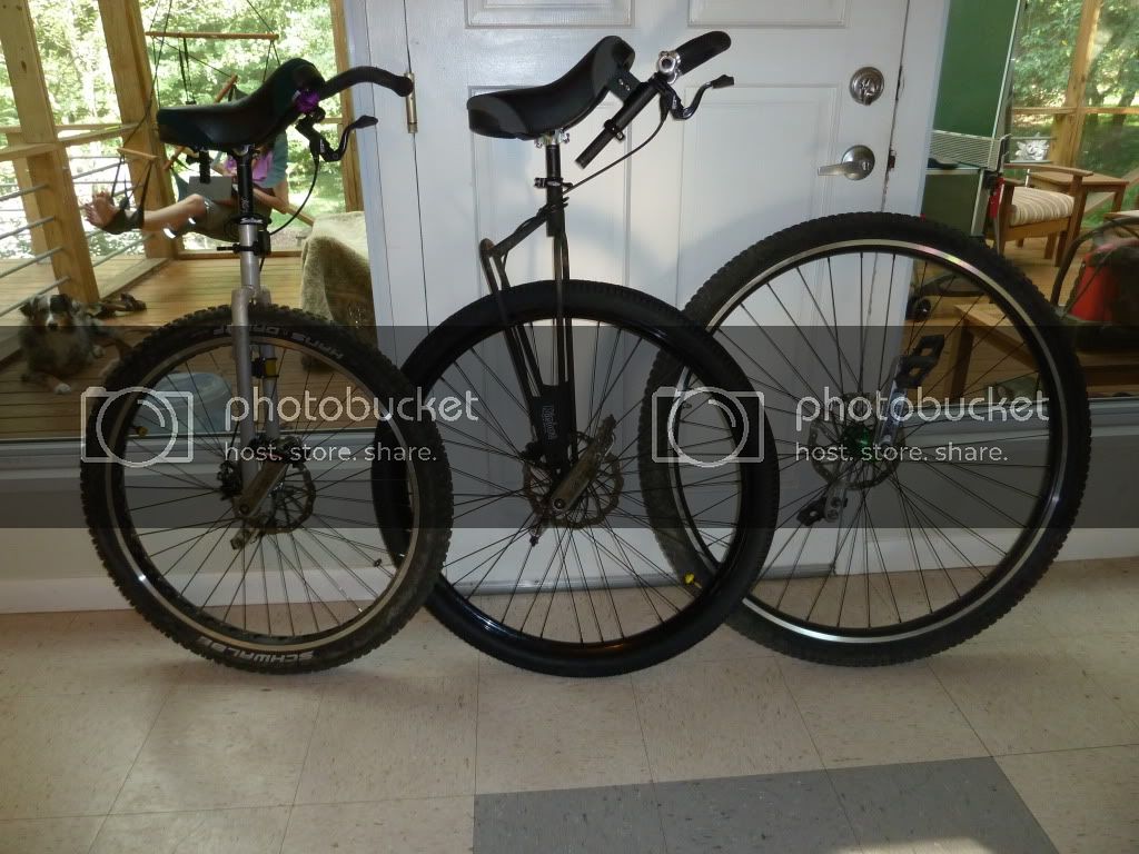

Tire height does make a difference, which is why in the group photo the 29 x 2.4 seems so close to the same size as the 32" and the 36 x 2.25 seems so much bigger than the 32". The actual rim size step is the same for the 26:29 and the 29:32
For perspective, tire measurements from rim sidewall to highest point on tire tread:
32 x 2.125 tire = 1.75" tall
Duro 24 x 3" = 2.6" tall on a 42mm rim
Hans Dampf 29 x 2.4" = 2.25" on a 47mm rim
36 x 2.25 prototype = 2.25" on 42mm rim
To be fair, when the tire compresses, the knobbies do not stand “tall” so a taller knobby and a low volume casing is probably not as significant as a short knobby and a high volume casing, so the RR 2.4 is probably just as tall as the Hans Dampf 2.4, even though the Dampf measures slightly taller than the RR 2.4 when unmounted.
The 3" Surly Knard will gain only a 1/4-3/8" in height over the existing fat 29er tires, so not that much of a change, a 2.4" tire on the 32" would add 1/2" or more, so if we’re comparing “apples to apples”, a Knard for the 32", then it would have a sidewall 3/4" taller, so 1.5" taller than it appears in the picture.
The big sell on the Knard is the bigger volume and lightweight, so no one should be expecting a 29er Gazzolodi, instead think more like a beefed up RR, Surly style; supple with low tread height, like a mini Larry.
