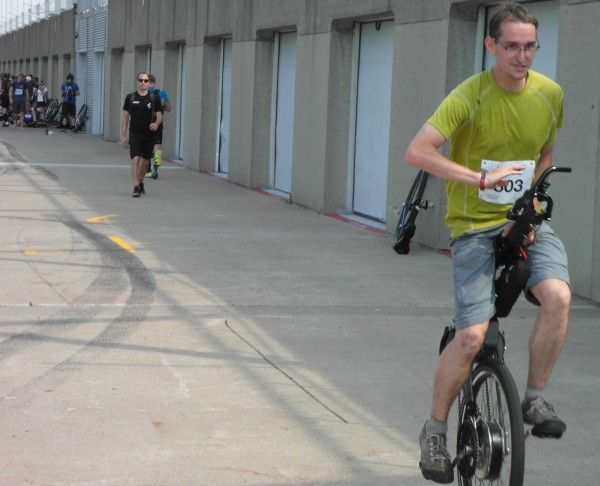

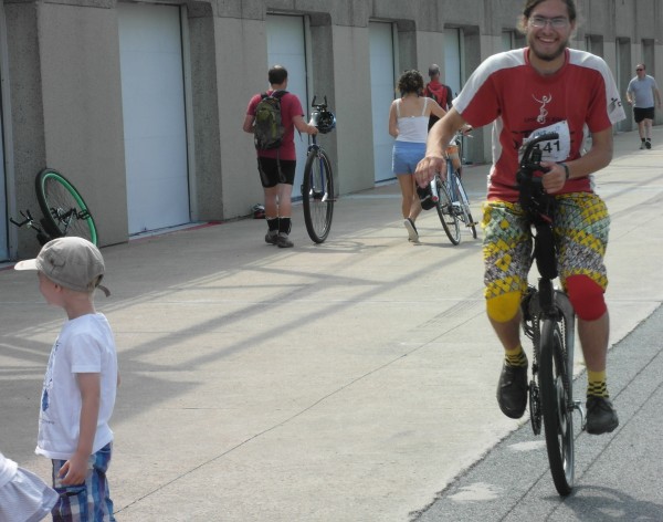

Hi Bobby, it was awesome to have you and all the others brave enough to not only take it for a test rides but really figure it out and put it through the paces. So thank you Bobby, Martin, Dave Cox, Thierry, and all the others who had a go and were able to provide useful feedback. The learning curve was not easy, but a handful of people used to geared cokers were able to freemount and ride (somewhat nervously) after just a few tries.

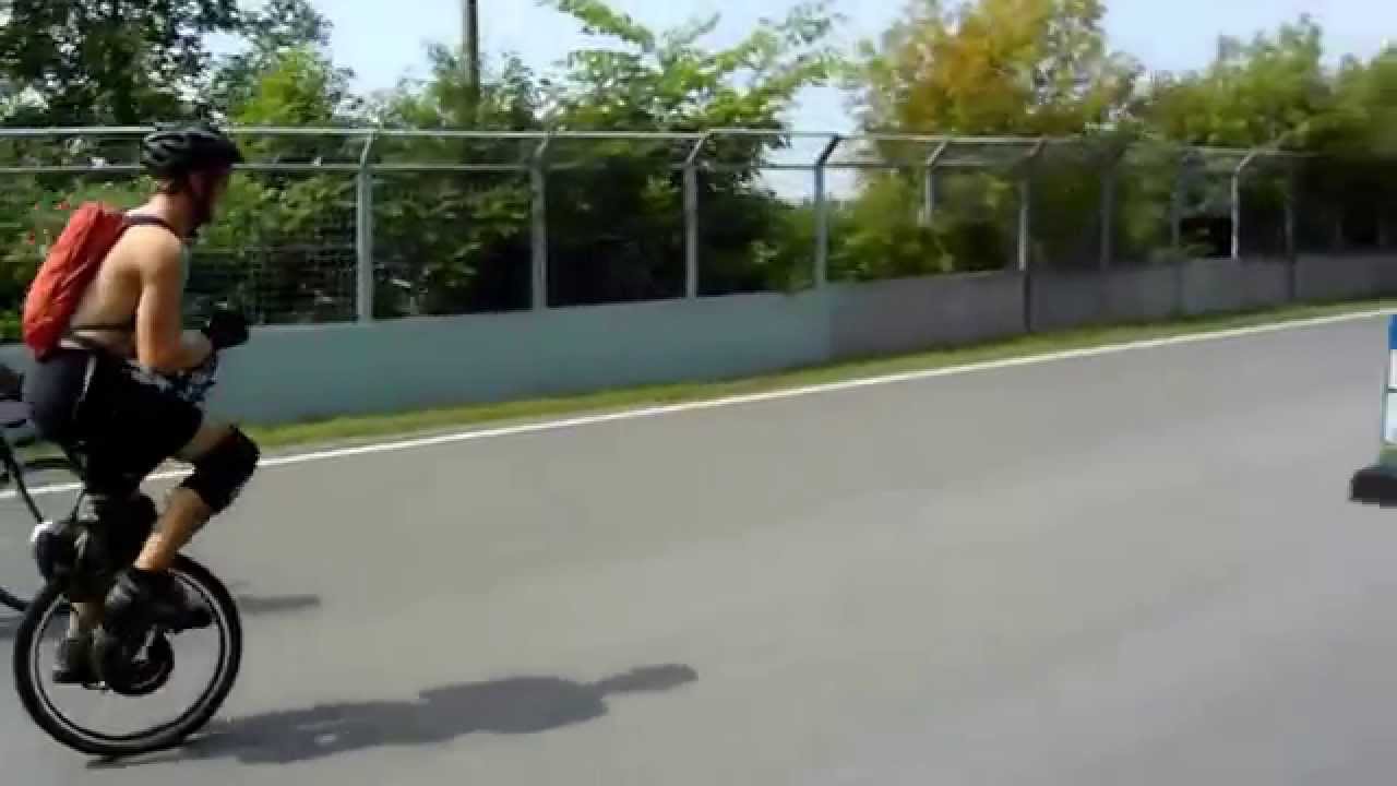

Yes, much more than just time lapse, I actually got full data logging with GPS of the circuit showing all their speeds, cadence, motor power levels etc. at each point in the course. Of course, since both Martin and Bobby had just finished the actual marathon and were more than a little exhausted, it didn’t make for the best test case for setting any speed records. It was also (in martin’s case) his first actual test on the unicycle, while I think it would take quite a few hours of riding to be comfortable enough to really take it at full speed.
Anyways, the data is quite interesting to look at. Here is a look at Martin’s lap, which includes a crash at 1.3km in, and then getting up to speed pretty steadily (~35kph).
Click on it and you will see the lap details and as the mouse hovers over the graph it will show where on the map this corresponds to, as well as all the stats for that point. Over the last km, you can see the battery voltage is at less than 30V, and the motor power steadily drops from ~560 watts to ~160 watts when the file suddenly cuts out. This caused Martin to crash a 2nd time, but it wasn’t until after I looked at the data that I realized why. Turns out that only one of the two small batteries was connected inside the bag, so I only had half the battery capacity I thought was present. This also explains why he didn’t get to the target 40kph speeds, since the battery needs to be at least at 36-37V in order to do that.
Thanks! It wasn’t quite intended like that at the start, but so it became. If you look at this short video from the start of Bobby’s lap, you an see that some cylists on the course were equally mystified by wtf they were seeing:

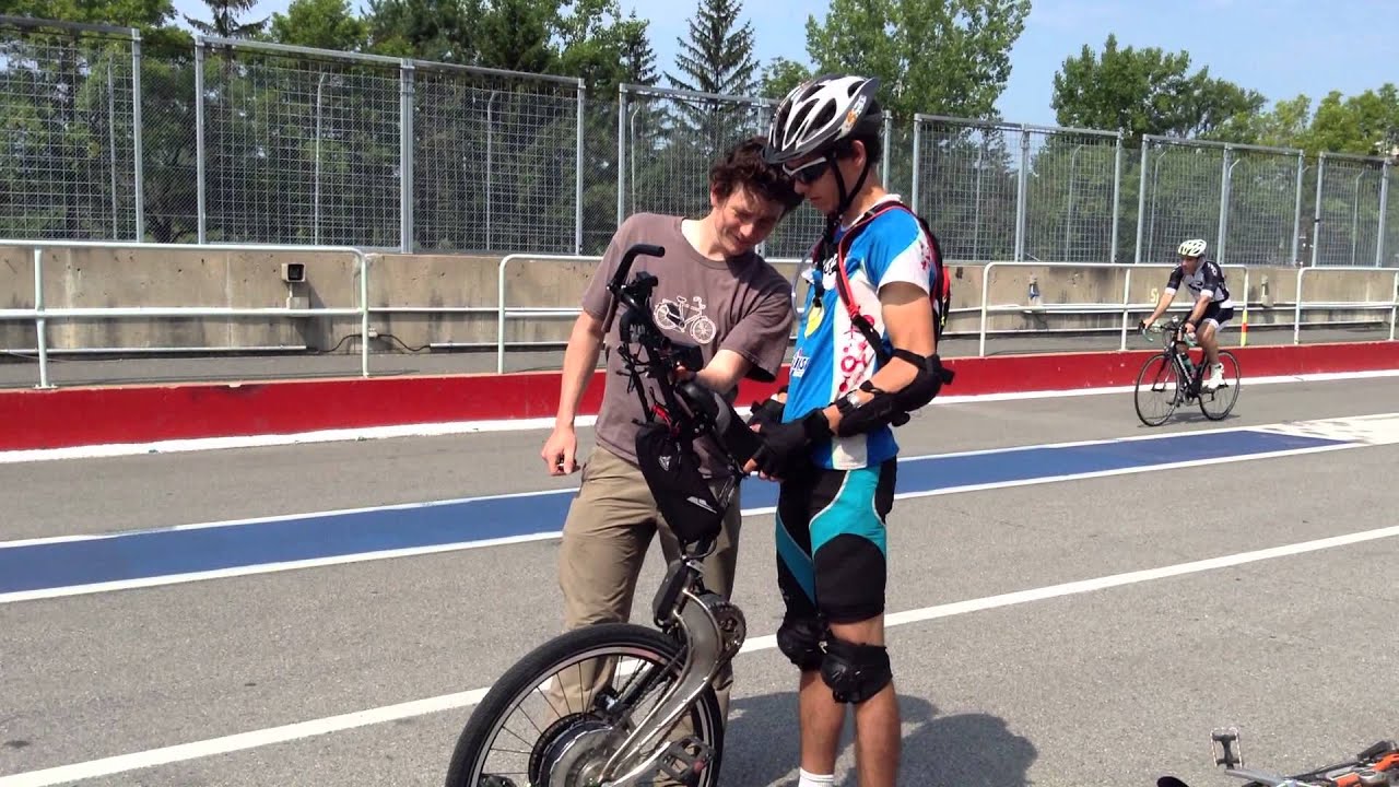

Here’s another quick clip of me explaining the setup to Martin before he first mounted it:
