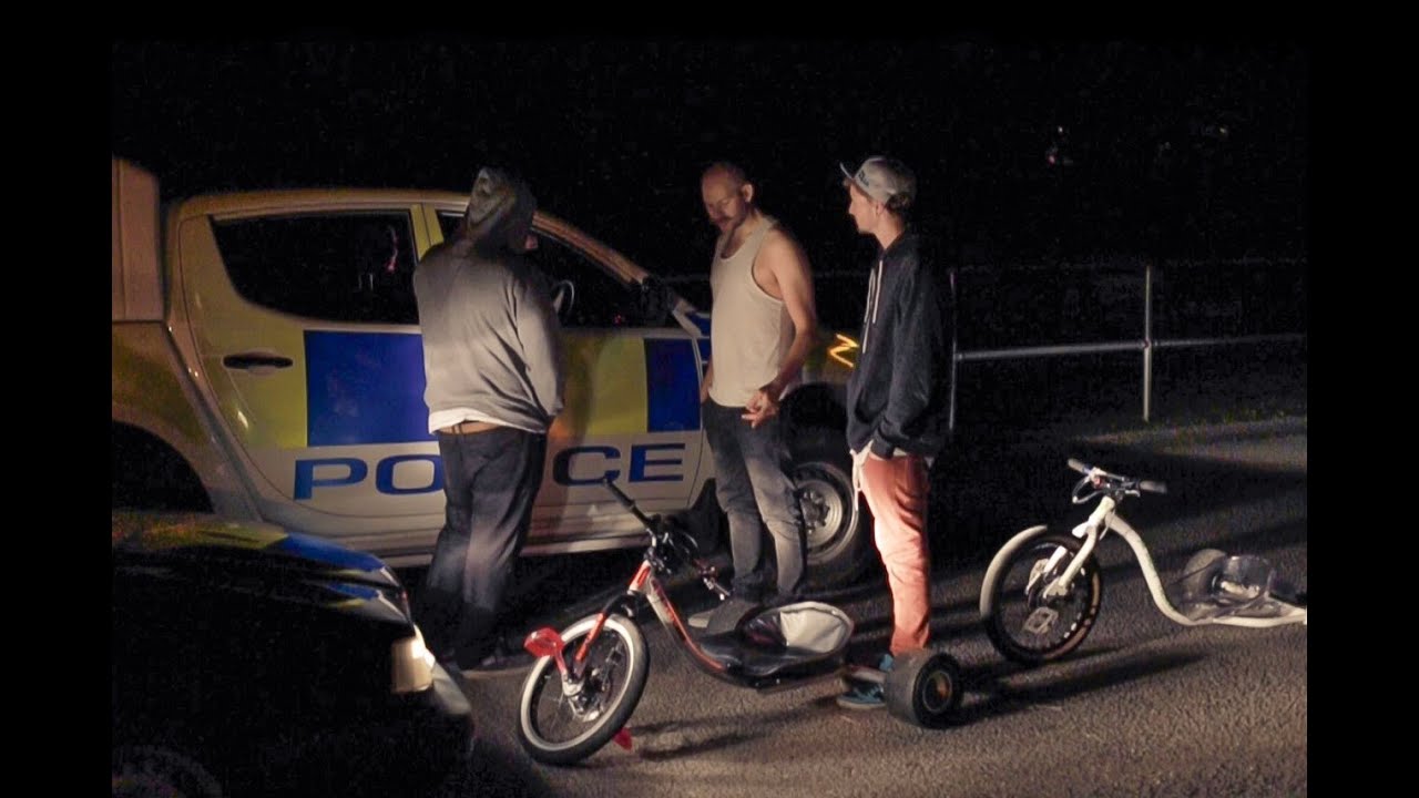

Due to my continued interest in freewheel unicycling I read a lot about drift trikes and I came across this interesting photo:
Notice the Nimbus Venture cranks! This doesn’t work for freewheel unicycling because it’s direct drive but I’m curious if anyone’s seen anything like this. Is it maybe a regular bike hub and they mounted the cranks in a special way? It looks like there may be more developments soon and maybe they’ll give out more information.
