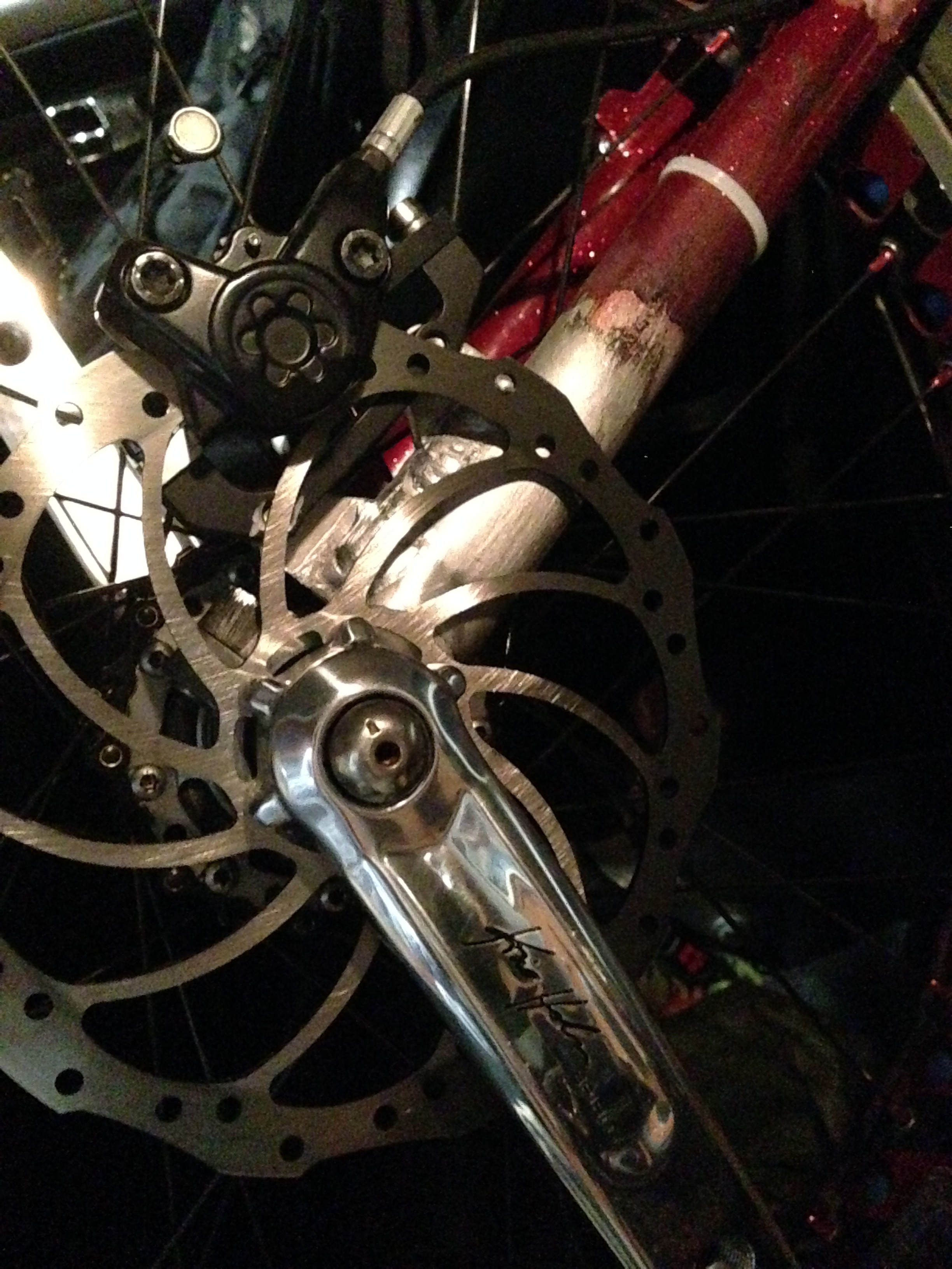

Finally got this delivered and built it into a unicycle. I still need to adjust the brake. The rotor is a custom 225mm Hope and the largest cranks I can put on are 125mm. I didnât get much time to practice with it yet, maybe 20-25 minutes in which time I was able to do about a half revolution. Iâm guessing it will me take a few weeks to be able to ride this on flat ground.
Amazing! Looking forward to videos!
Subscribed.
What is the wheelsize, 20 inch? That would be 76 virtual inches. You would have about the same leverage as with 59 mm cranks on a 36 inch. This must be difficult to ride indeed. And the wheel looks so innocent.
