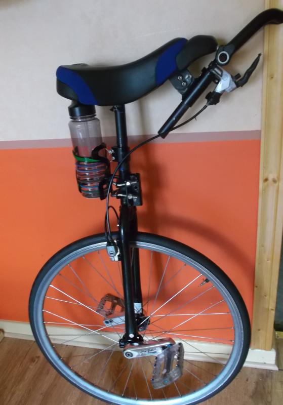

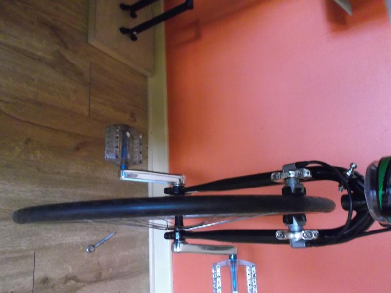

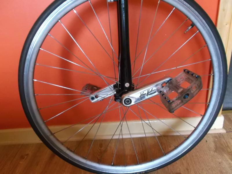

Here’s my contribution. It’s a NImbus 29er but with a difference. I’ve only gone and put a narrower rim on the wheel and added a very narrow tyre. The rim is off a broken E bike which was very heavy so I reckon the rim is quite strong. The tyre is a Gatorskin 700x23c tyre with a very smooth surface.I wasn’t sure if the HS33 Magura brake pads would reach in as far as the narrow wheel but they’re working really well. I have a 127mm crank setting but will be aiming to ride on 75mm cranks as suggested by GizmoDuck. I’ve ridden the 29er before with 75mm cranks but that was years ago. . The 29er looks weird with the very skinny wheel. The photos give some idea of how skinny the wheel is but it looks even skinnier in reality.:smiley:
My reason for this conversion is to overcome some fairly steep camber on the cycle lanes. I believe that less tyre to ground contact should reduce the camber effect. I hope to try it out next week. If it works I will call it my ‘CC Uni’ (Conquer Camber Uni) :stuck_out_tongue:
Skinny wheels always look fast!
