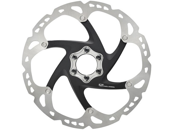

The aluminum center piece for a floating rotor alone would cost that, in a small production run, before you even have someone assemble it, test the assembly, etc.. There is no way they can make that happen for less than 1.5 times the price of a hope piece rotor.
Don’t get me wrong, I hope to see a more “normal” disk design in the production version and I did stumble over the price too. But if you compare it to something like a hope trial rotor (costing about 50€ for a one piece, relatively simple design, with the Schlumpf disk being 80€), it seems not an extreme price anymore.
Knowing how Schlumpf usually operates, it will probably be heat treated and ground like good quality disks are, not just lasercut from a random piece of stainless.
Remember that, when developing BrakeFast, Roger looked for producing a “plug and play” rotor. He said it was finally too expensive to be done. So I’m pretty glad Florian found out a way to produce rotors for 80€.

From a technical point of view, the triangle is the most stable shape, so we build a corresponding shape from triangles.
I also notice that the design is close in shape to BrakeFast. I’m happy also on the point that compared to a bicycle’s braking forces on a unicycling I’d suspect they’re never as forceful or for dead stops.
In short I’m reassured and am just going to trust Florian from now on :gear::grinning_face:
Urge to do some stress/strain simulations on that design rising…
Triangles are indeed very strong, but that design has some very thin triangle sides, and typically even designs with triangles will orient them so that the force from the disk is closer to the top of the triangle, rather than trying to push it over sideways.
It’s probably absolutely fine, but it sure looks weird compared to every other rotor I’ve ever seen.
The brakefast is a very different beast as most of it is billet aluminium, not in a triangle, and the triangle on the disk part itself is facing the other way.
I suspect the only reason that the aluminium part is not shaped like the centre of the original disk is due to wanting two symmetrical halves, and the issue of the spoke holes getting in the way.

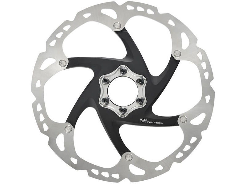

The original disk design:
