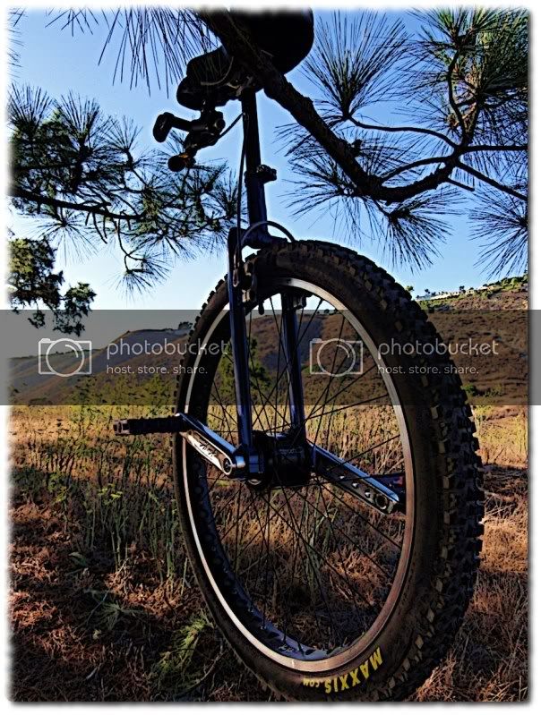

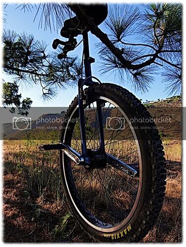

I’m running the Ardent 2.4 w/folding bead. Super light but still very solid and high volume enough for hard tech and drops.
Here’s a recent pic from a local trail. :slight_smile:
