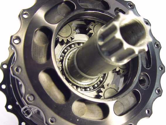

Yes, at minimum there are 2 sealed bearings on the inside, one on each side just below the big bearing. In the middle of the hub, there is an other bearing (not sealed on the photo)
YES They replaced all the bearings and return the old rusted (sezied) bearings. The No: is 7 bearings! :sunglasses:

Probably should distinguish between oil and grease. Oil goes in the hole behind the screw to lube the gears. There is grease inside the sealed bearings. And there is grease behind the external dust covers. So when my dust cover came loose, and I had grease coming out, that was not the hub oil coming out.
I think, Schlumpf hub uses now grease instead of oil !
Depending on the batch. Early hubs came with grease, later it was oil, now they are back to grease. But all hubs work with grease as well as with oil - according to Florian Schlumpf.
Am I wrong in thinking that if the cover on the outside of the hub came loose, that the oil/grease in the gear chamber is still contained? and that the internal bearings are still contained?
Wrong for oil/grease : if the cover comes loose –> oil/grease leakage :angry:
? for internal bearings –> if cover comes loose, hub can disengage more easily in low gear :angry:
