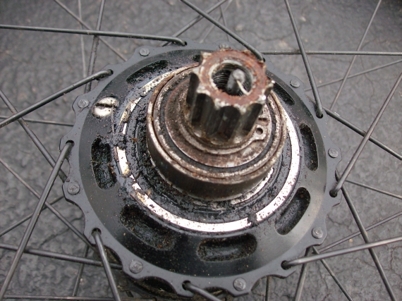

My Schlumpf has started feeling less smooth, regardless of whether it’s in high gear or not.
I removed my wheel and cranks and found it looked pretty dirty:

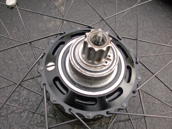

With a toothbrush, cotton swabs, and paper towels I cleaned it up quite a bit:
Unfortunately, cleaning it up didn’t solve the bigger problem. Spinning it by hand, it feels and sounds like the bearings are having issues.
It’s not bad, but I suspect it will get worse.
With years left on the warranty, I figure I’ll just keep riding it until it becomes annoying or is not longer fit to ride.
Any opinions?
And am I doing something wrong? I didn’t expect things to look so dirty, with some surface rusting. Maybe I need to clean it more?
Is it leaking excessive amounts of grease?

Hi sounds like a bearing is on its way out, My Hub sezied a bearing back in March this year and its just come back this week?
I don’t think so. Though, after my last ride I noticed what looked like a bit of clean grease on the outside. So maybe it’s oozing some. But it’s hard to tell the rate.
:stuck_out_tongue: But unfortunately if it’s the bearings adding grease won’t help, since it goes into the gearbox, not into the sealed bearings.
Could you tell it was on its way out before it seized? How long after noticing did it seize?
Question: is there a sealed bearing on the inside of the hub? And does it have a cover that is separate from the cover you see on the outside of the hub?
