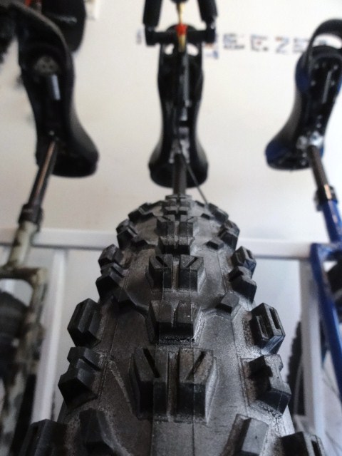

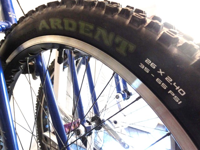

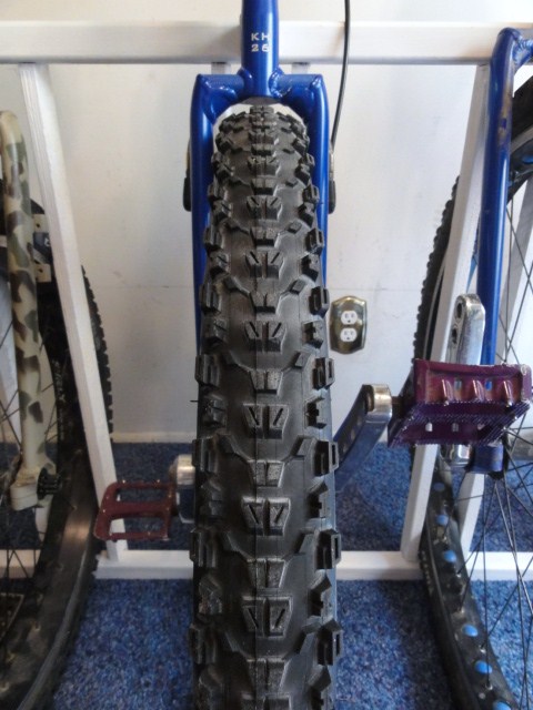

Here’s a pic of my newly mounted Ardent 2.4. It’s a full pound lighter than the 2.6, owing to its single-ply and kevlar bead. But I can still run it at the same (lower) psi for tech terrain, where it has excellent compression to absorb impact and roll over obstacles. But for all-out hard tech and serious DH, I would go with the 2.6 2-ply w/steel bead.
The 2.4 also retains the exact same tread pattern as the 2.6, the slightly narrower width isn’t very noticeable, and I really like the raised center line, as it greatly reduces rolling resistance, at least in my experience, as compared to other tires in this size that I’ve tried. Got mine on sale for $21! Sorry, sale ended on 9/6/11. :o
