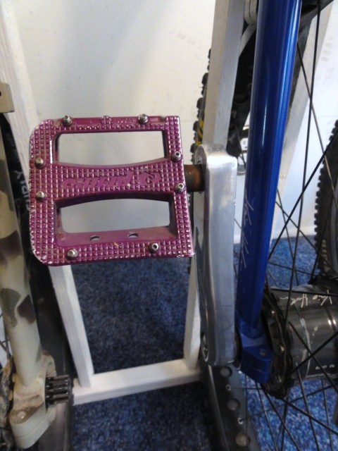

You touched on the issue of weight and you can still do some things to cut it down. Those speedplay pedals are absolute behemoths and could be replaced with a lighter alternative. I really like the feel of low profile pedals and went for a set of addict knockout pedals and couldn’t ask for more grip (I also have the 5:10 Sam Hill shoes). The wellgo Mg1s are a tad lighter but have a smaller platform, one less pin, and are taller. There are a heap of other lightweight, low profile pedals out there at the moment that could suit.

Hey Mark, nice hearing from you. Wow, we must be on the same wavelength! Earlier today, I swapped my drilliums out for pedals I use on my 36er. They are much lighter, Primo (non sealed) magnesium pedals. When switching the pedals, I also discovered that one of the inserts on my 125/150 moments was loose (I had used epoxy in place of the ring that fits there due to bad threads) and it came out with the pedal! So I took the single holed 150’s off my 24 MUni–which I had already drilled holes (about 5mm deep) in the back–and put those on. I may just drill them all the way through, but I’m not really sure if that would save any noticeable weight.

Lighter yet on the pedals, try some Odyssey Twisted PC, light, strong, inexpensive, lots of color choices :slight_smile:

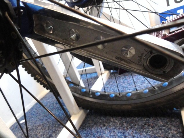

I have recently dropped down to 137 Moments to see if I can get a smoother transition between high and low gear and to minimize the tendency for the uni to overexagerate corrections while peddlng; following Napalm’s path to enlightenment…

When I first started riding with my KH/Schlumpf hub I adjusted the shift knobs as per directions, but that was when I was using my 150s on my KH24. With my small feet I had issues shifting on the fly. I could still shift successfully but it took a lot more work and changing of foot position. Kind of a headache!
Fast forward to this past June when I finally decided to try 137s on my KH24 as per Kris Holm’s advice from a couple years ago. Wow! So much smoother all around and so much easier to shift, almost too easy! So it was getting to the point that I started having a lot of accidental up-shifts. I know others have done this too, but I decided to go with asymmetrically adjusted shift knobs. Since the up shift isn’t as critical as the down shift (at least for me) I adjusted the upshift knob inwards a couple millimeters more than the downshift knob. Now much better, a bit tougher to upshift, but not really all that, at least I don’t have all the accidental upshifts.

Btw, I just got back from a muni ride on the 26 guni running 135 Moments. It was a game changer for me, not only do I have far less bobble when shifting up and down, but shifts are esier to reach and stability/climbing remains as good as it was with the 150’s.
