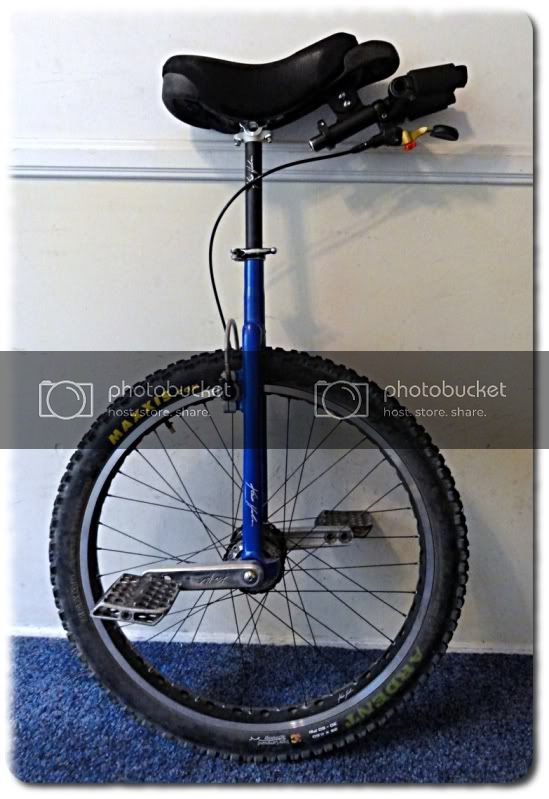

I’ve had my new 26er GUni for a couple months now, and must say that I really like it a lot. I got shifting down faster than expected, and it has pretty much replaced my 24 and 29er for all-purpose MUni riding. I still use the 24 for the really technical trails, and even though the GUni can handle it, I don’t want to over stress the hub beyond its limits.
One thing I noticed immediately was the extra weight from the hub! In fact, at 19.3 pounds, my G26er weighs more than my 36er, with the handle and aerobars! This weight does include a short T-handle (same as Kris’s setup) but the hub is where all the extra rotational weight is coming from. Having said that, I have mostly gotten used to it, but when I pick up my KH 29er, it feels light a s a feather by comparison!
I’ve ridden my GUni at several trails and lately I seem to be doing most of my riding in high gear! I really like the feel of it now, whereas in the beginning it felt really strange and I would feel a kind of “rocking/bobbing” motion with each revolution. Now it’s fun riding over a variety of terrain, and to try staying in high gear as much as possible.
