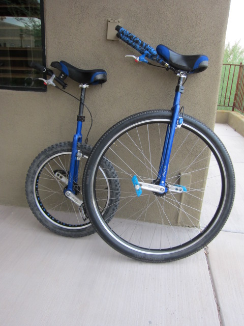

My 36 geared wheelset just arrived today! All put together and thankfully no issues with frame clearance. Took a short test ride out front and things went pretty smoothly. Between my experience riding the 24 guni and lots of riding the 36 with 110s, I think I should be able to get the hang of the 36 guni pretty quick. Off tomorrow for a longer ride.
BTW, I have found that one should always reserve judgement on a new uni set-up until one has spent sufficient time riding the new set-up. New configurations tend to always feel wrong at first.
Though I have had my guni for a little over a year, I am really just a few months into riding it. I have no trouble with the 1.5 ratio. It took a long time for me to be able to say that. My low gear is a little too low for climbing on the street, though it makes getting to the top of the hill pretty easy. Shifting to high is not usually a problem. Shifting to low poses a timing problem I have yet to figure out. I wait until I really have to shift and usually it’s too late. I can’t shift when I’m already climbing, but I don’t want to go so slow too early. I’m thinking a 29 would be better for me. I was hoping to get a new, small value torque wrench for my birthday but it didn’t happen. I’m ready to try a dirt tire on an easy trail (I think :astonished: ). I hope that will push me to improve geared riding faster. I just don’t want it to take another year :roll_eyes: . I have to leave the 137 cranks on for shifting but as long as the trails aren’t too bumpy that shouldn’t be a big deal.

Had my first real ride on the 36 guni (w/ 150s) this morning. I started with a route I did 2 days ago 36 non-guni with 110s. I was ever so slightly faster with the guni. However, I see real potential for bumping up the average speed on a ride 1.5 to 2.0 mph. My top cruising speed with effort with 110s unguni is about 13 mph. With a similar effort on the same terrain, I was cruising at 14.5 to 15 mph. Over the whole 10 miles, I averaged 12.5mph. There is definetly room for improvement there. I had a one mile section of trail that is almost imperceptibly down hill with no wind, and I averaged 14.5mph with a top speed of 16.5mph. The level of control between the 2 set-ups is very similar. The longer cranks and lower cadence seem to offset the higher gear ratio in terms of control. To achieve speed the guni demands higher pedal pressure, where the 110 unguni requires high cadence. Cadence is definetly the limiting factor on the unguni. I can only crank so fast for so long. Higher speeds can be attained on the guni with a comfortable cadence with a little bit more effort.
BTW, did I say this thing is awesome :slight_smile:
Second ride on the 36 guni this morning. Rode from home to the Farmers market. Started with a little XC muni on a trail down a wash (passed a kid on a mtn bike), arrived at the paved bike path and kicked it into high. Good stuff.
