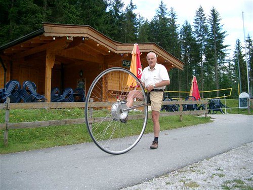

Riding my geared 36er in high gear makes it feel like a “virtual” 56.25 inch wheel (Schlumpf ratio is 1.5625). I have always had to “imagine” (to try and get my brain to “talk” to my legs) that I was pushing a 56" wheel. Now I have an actual picture of what that would look like. See QU-AX FaceBook page for more pictures.
wow!
Great!
Who is that man?
Where to buy such a monster uni? It’s not listed on the Qu-Ax internet page.

Is that the correct math? I always thought it was like a 54" wheel. I’ve ridden a 56" wheel before. It’s very different from riding a geared-up 36" wheel, but at least the 56" fits into the car. :slight_smile:
That “Qu-Ax” 56" wheel is a beauty. I especially love the clever use of those rubber bumpers on the ends of the pedals. Big wheels are very susceptible to pedal (and crank, and potentially axle) damage in drops. When a wheel that size falls over, it’s quite an impact on the crankset!
My old roommate had built a set of handmade big wheels, Tom Miller style. He had a 40", 50" and 56". Adding my 45" filled in the gap. Those were great novelty cycles for road riding, but not comfortable, not light, and the big one was not good for hills. Limited to 140mm cranks due to leg length, it was scary riding down even little hills! :astonished:
