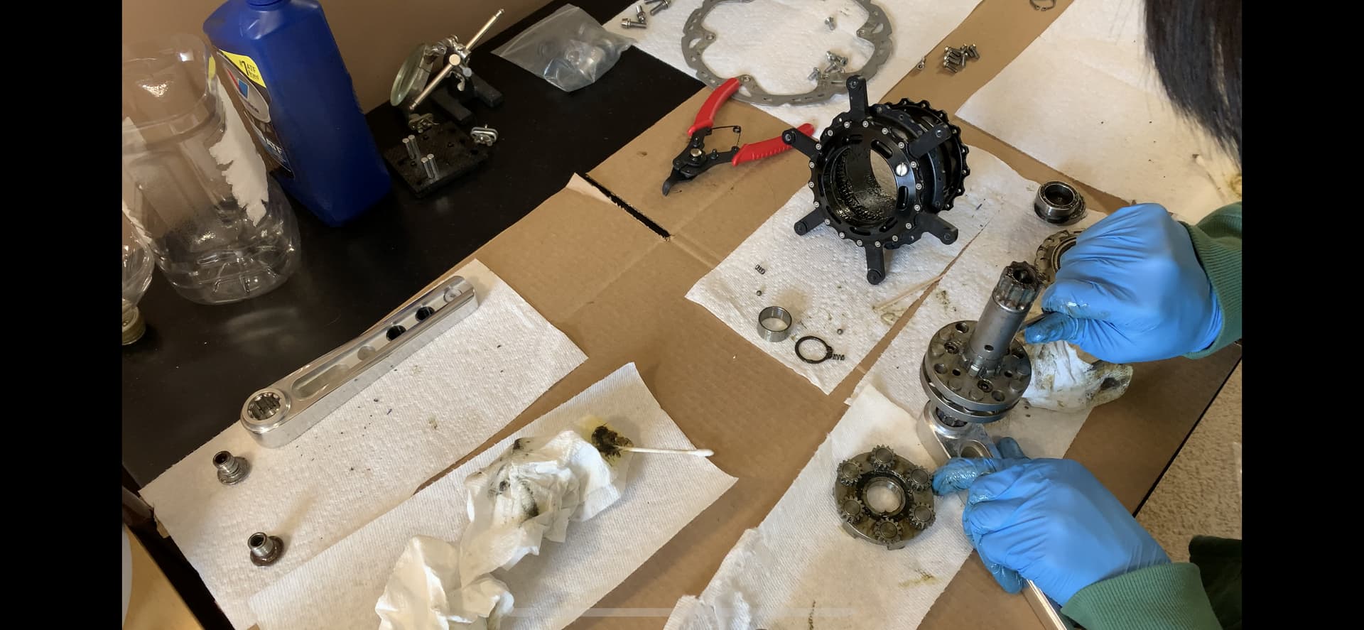

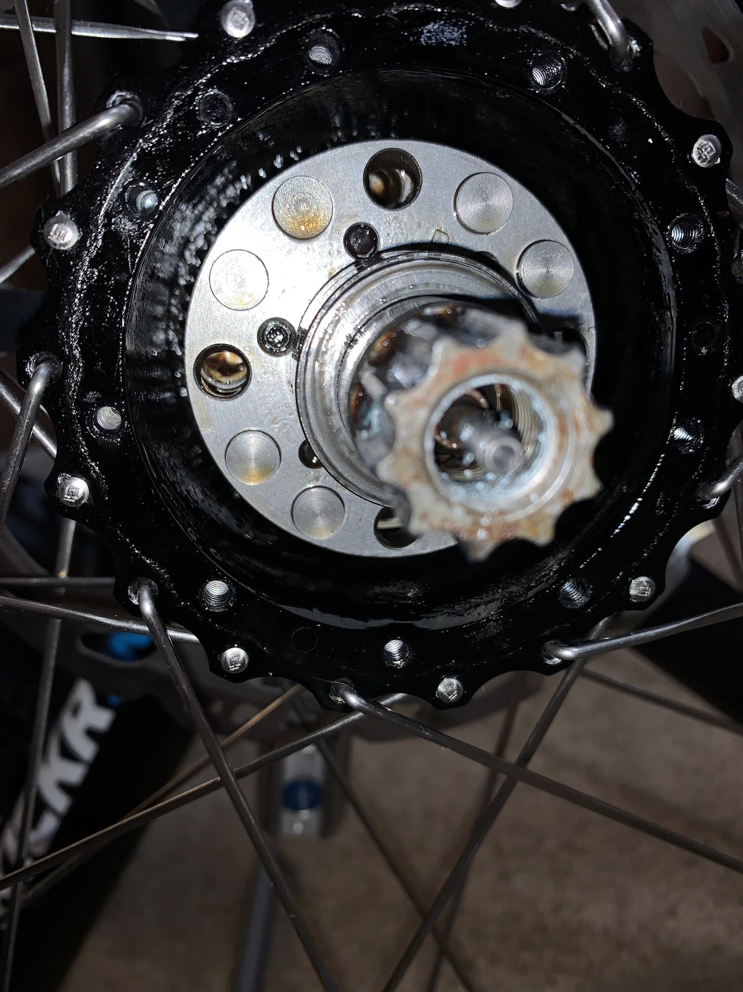

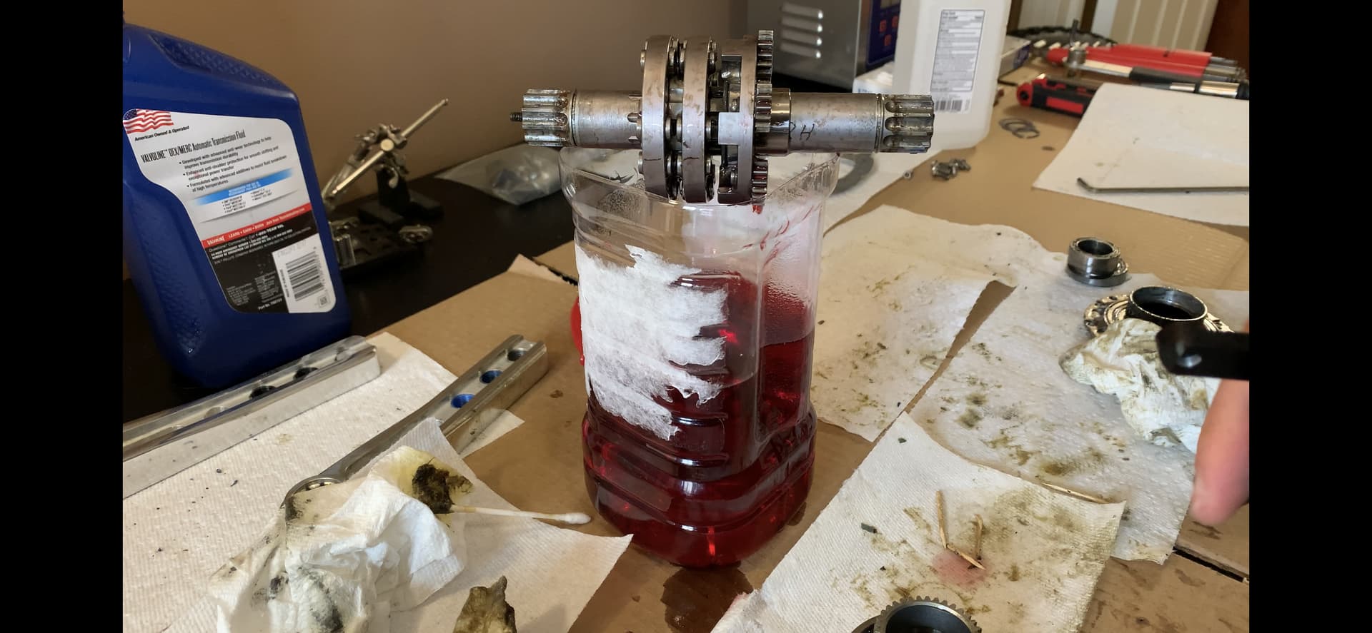

Trying to take apart a hub to do a complete clean and try an ATF oil bath.
Based on the How It’s Made Video,
I unscrewed the 9 T20 screws on the right side, but nothing happened.

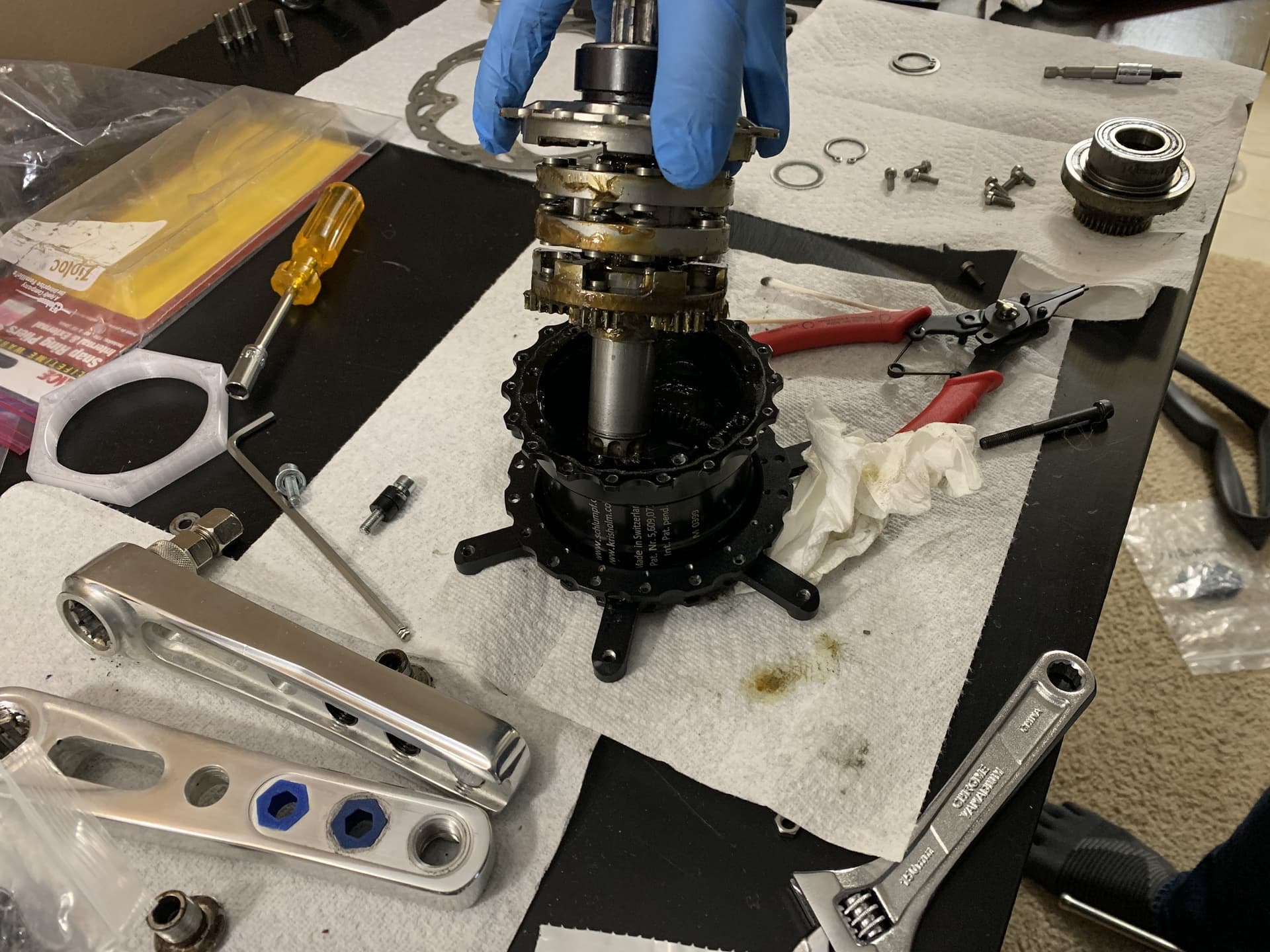

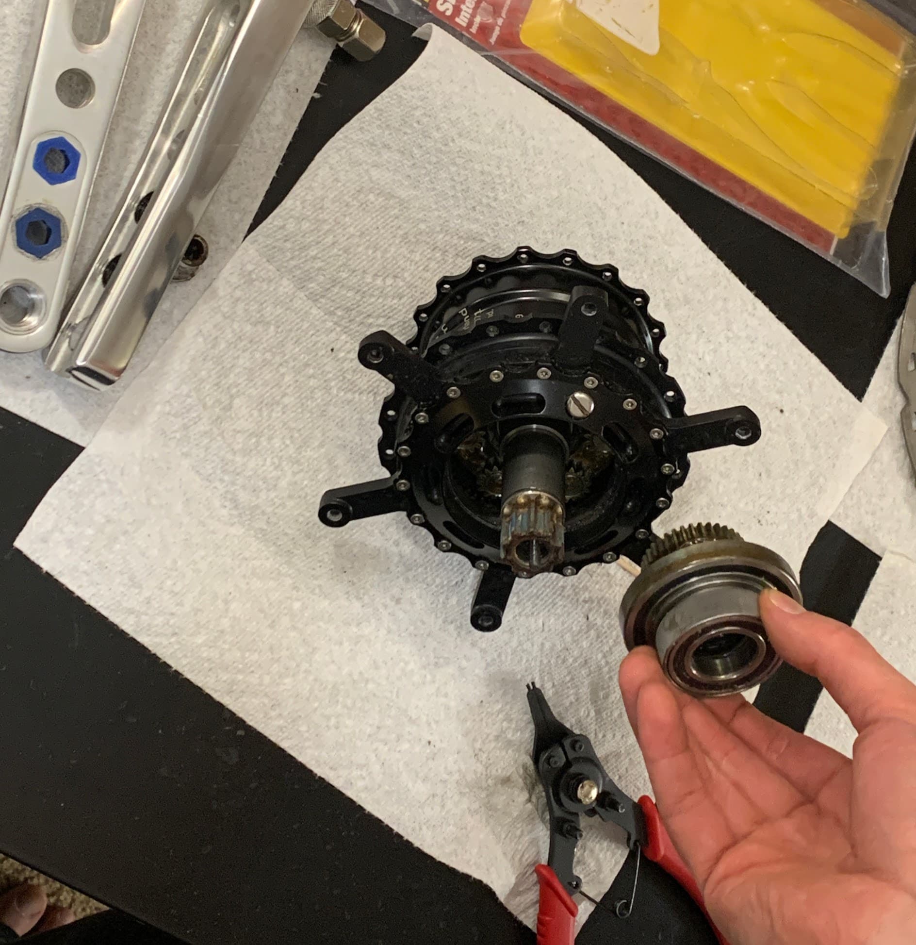

I thought the left side and sun gear would be stuck as it was pressed in, but next I took out the two snaprings near the clamped frame bearings.
After I took out the two snap rings, and the sun gear + bearing came out. The large bearing was a super loose fit in the hub body.
The right-side plate and rest of the mechanism still seems stuck. I’m afriad to use too much force.

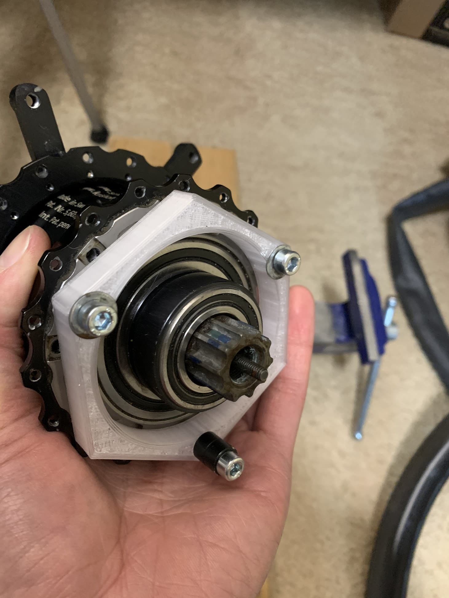

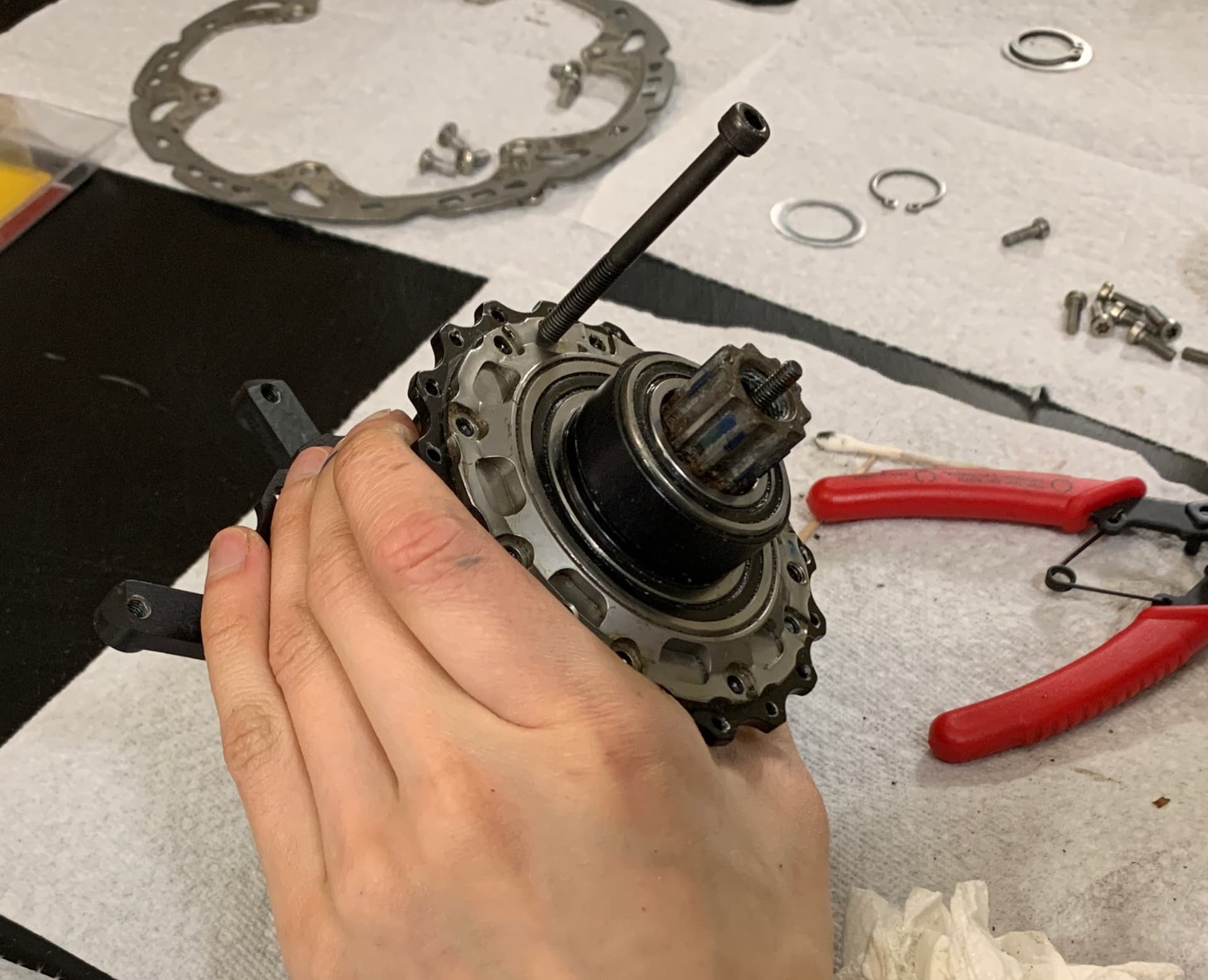

I noticed three M5 threaded holes on the right-side plate. Are those supposed to be used to pull the plate off?
Update:
I made a plastic piece for me to grab onto the right plate. My thought was three holes for the M5 screws to go through, and I could clamp the plastic part in a vise and pull.
But, I accidentall tightened the M5 bolts “too much” and heard small sound. It still felt stuck though.
Putting it in the vice, I couldn’t get it out as the plastic piece didnt have enough friction and was too weak to be clamped hard.
I became impatient and continued tightening the M5 screws more. It popped the plate off!
The whole Schlumpf Hub is a slide-fit assembly, it’s normal that everything is ‘‘loose’’. ATF will just leak out and contaminate your brake pretty quick, as well as throw oil on your spokes and around your wheel. The oil/grease Schlumpf uses is a NLGI 00 grade, which is kinda similar to yogurt. It’s hard to find but I managed to order some at my local car parts store.
The 3 M5 holes on the grey part are meant to use as a puller, you put 3 bolts in and equaly tighten them until the thing pops out.
It’s a fun puzzle, take your time, there’s 2 hidden ball bearing and springs in there. You dont want to lose them!

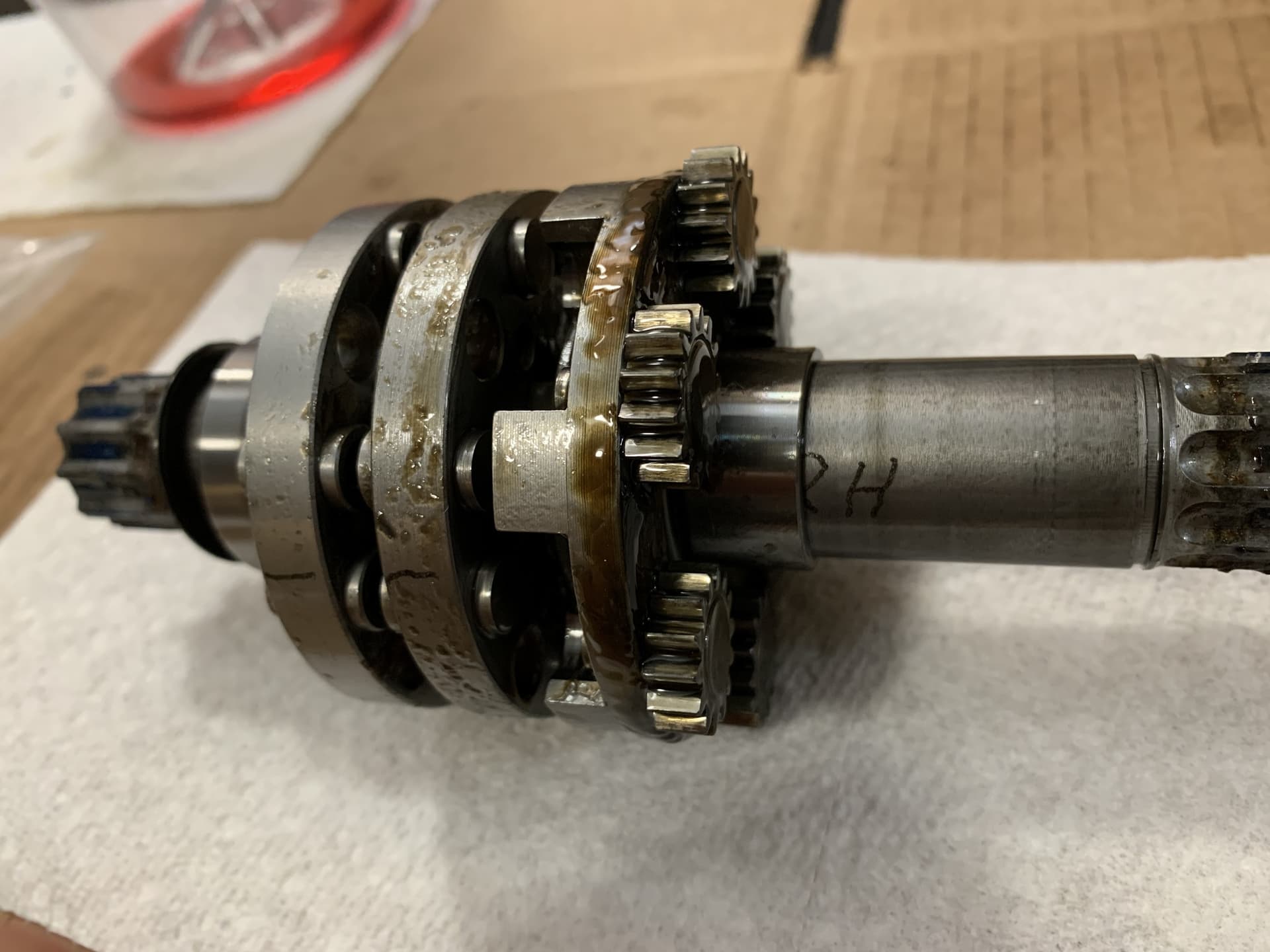

Do you know if the clutch halves with springs, 3 pins, and 3 bolts, are a press fit? The three bolts were super tight. After getting those off, the two halves were still really stuck..

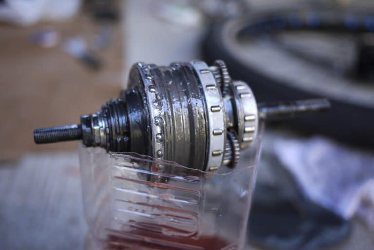

Shimano Alfine hubs which people take out to dip come out with all the gears (sun+planet+ring) in one piece.
For our Schulmpfs, the “indexing” of the gear teeth are lost. Given the gear teeth count aren’t relatively prime (66t/14t/36t), it’ll more likely than not go in differently than it came out. No idea if this is a real concern; I’ve heard of “breaking in” parts; wonder if this is similar.
With just the hub in my hand, I can feel a rought spot when turning the axle in high gear. It’s definitely the gears meshing as all the bearing were smooth when I took it apart. Mine only has 500 miles, and it always had a rough spot. I’m just not sure if it’s worse or the same, and just needs breaking in.

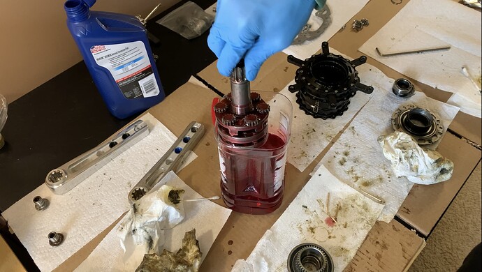

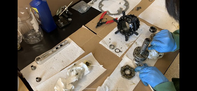

Pictures of the bath:
I would never use ATF in a Schlumpf as it’s not a lubricant. In a gearbox, the ATF is not used in the part with all the cogs, it’s used in the part with the hydraulic clutch system.
It is, tremec even uses ATF in some manual transmissions.

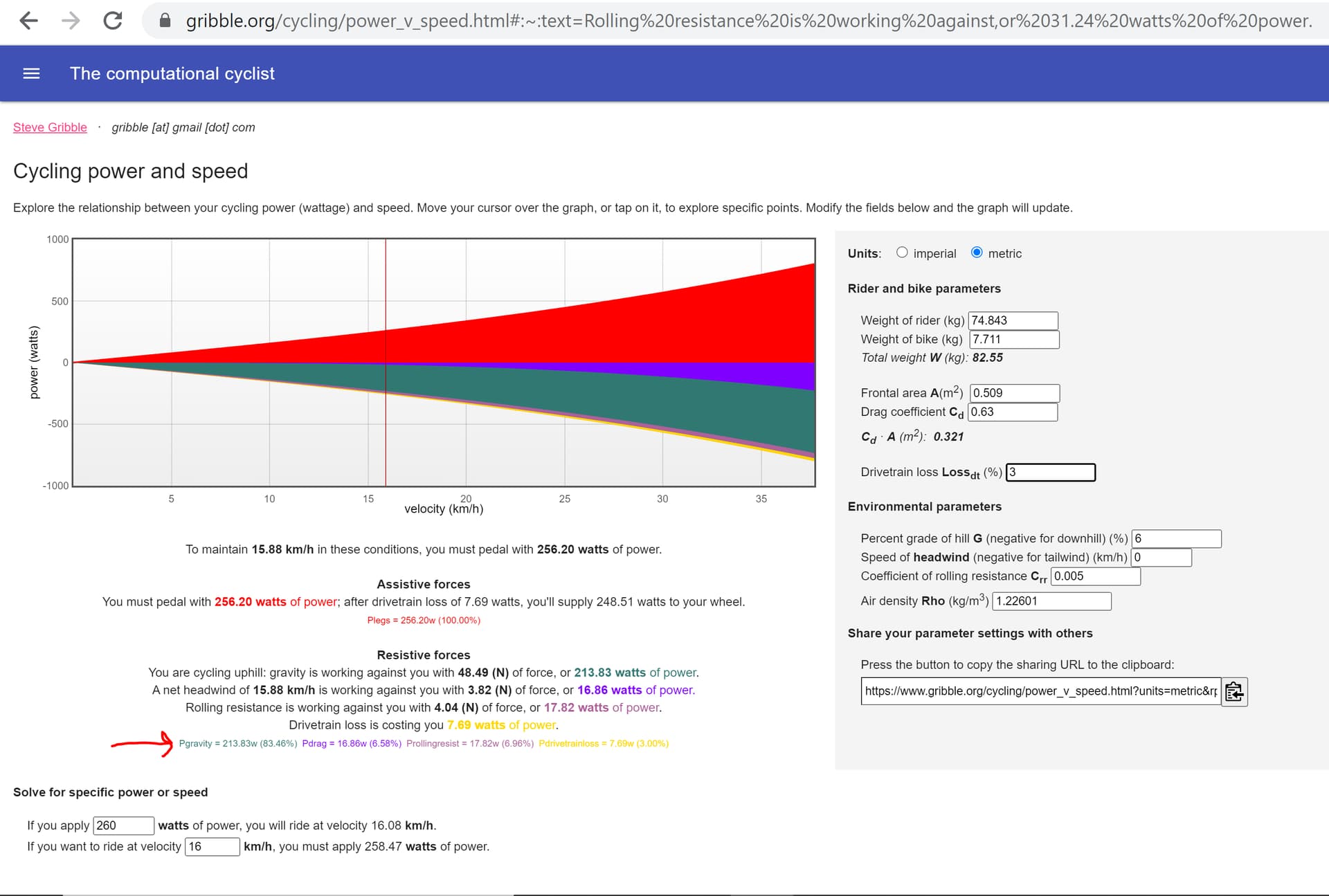

Power and speed are not linear, if you are in high gear on a Schlumpf, you can’t neglect air resistance..
Do you know if the clutch halves with springs, 3 pins, and 3 bolts, are a press fit? The three bolts were super tight. After getting those off, the two halves were still really stuck…
Use a large flat head screw driver and slowly pry it. Do a little on each side so it comes off evenly.
I’m assuming you’ve helped service a lot of them! Have you noticed them being rougher after taking apart?

I’m confident you’ll loose all your oil in just a couple rides. Even new hubs with the Schlumpf grease leak a little because of the slide-fit assembly.
Agree that it is a lubricant, but also definitely not our normal schlumpf grease. Risking it with this schlumpf but will also carefully inspect after a few rides. I have a syringe of grease left, so can abort this experiment anytime.
Power and speed are not linear, if you are in high gear on a Schlumpf, you can’t neglect air resistance…
True sometimes. But I’m mostly interested for my G700C for hill climbs. 6% grade, 16km/h, ~80rpm, on a 700C/650B. In this case, aero is less than 10%, and gravity is the main component and thus approximately linear. (One could argue that an ungeared 36 is better in this scenario…)
Of course, for G36ers spinning 100+rpm at 30kph+, aero and balance/skills would be a lot more important. I definitely wouldn’t consider this experiment for G36 speedsters.

I definitely was not up to par on cleaning, as you might be able to tell from my pictures. Dried up loctite, lint from paper towels, dog hair, kind of was all over the place… I assembled it for now, but I’ll take it apart again in a few rides to double check anyways.

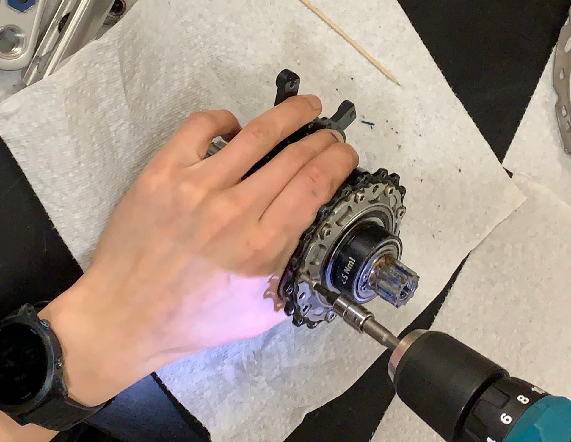

Another question hopefully Jacob you could help with. Do you have a torque value you use for the 9 side plate bolts? I asked Florian, and he says he doesn’t have specific value for them and just do them up reasonably.
Those 9 bolts + the 3 clutch bolts were both superrrr tight to undo. The 3 clutch bolts, I just tightened them about as tight as they were to undo by hand(maybe 7nm?). However, the 9 M4 side plate bolts started to feel like they were “soft”. Even if I turn them more, torque doesn’t seem to increase. I checked and they are at about 4.5nm. I’d say that is reasonable, but just doesn’t match how hard it was to undo them.
I dont remember what torque I put them at. The 3 inside ones are really tight. The 9 outside ones dont need so much.
I asked Florian, and he said he has no spec for the outside ones, and to just do them up reasonably tight.

Also, an update on ATF soak:
It has been almost 2 months since my ATF soak.
I have about 6 hours of riding on the guni. Over 3/4 of the distance in high gear.
Took it apart, and there still seems to be lubrication everywhere. But a lot of it seems like leftover grease. It steadily leaked over the first month. The last month has a lot less leakage. I’ve always left the wheel upright, to decrease amount of leakage.
If i really wanted to try ATF, I guess I should clean out all the grease. I’m a bit lazy..so going to see if soaking it in ATF overnight will soften and dissolve the grease this time.
