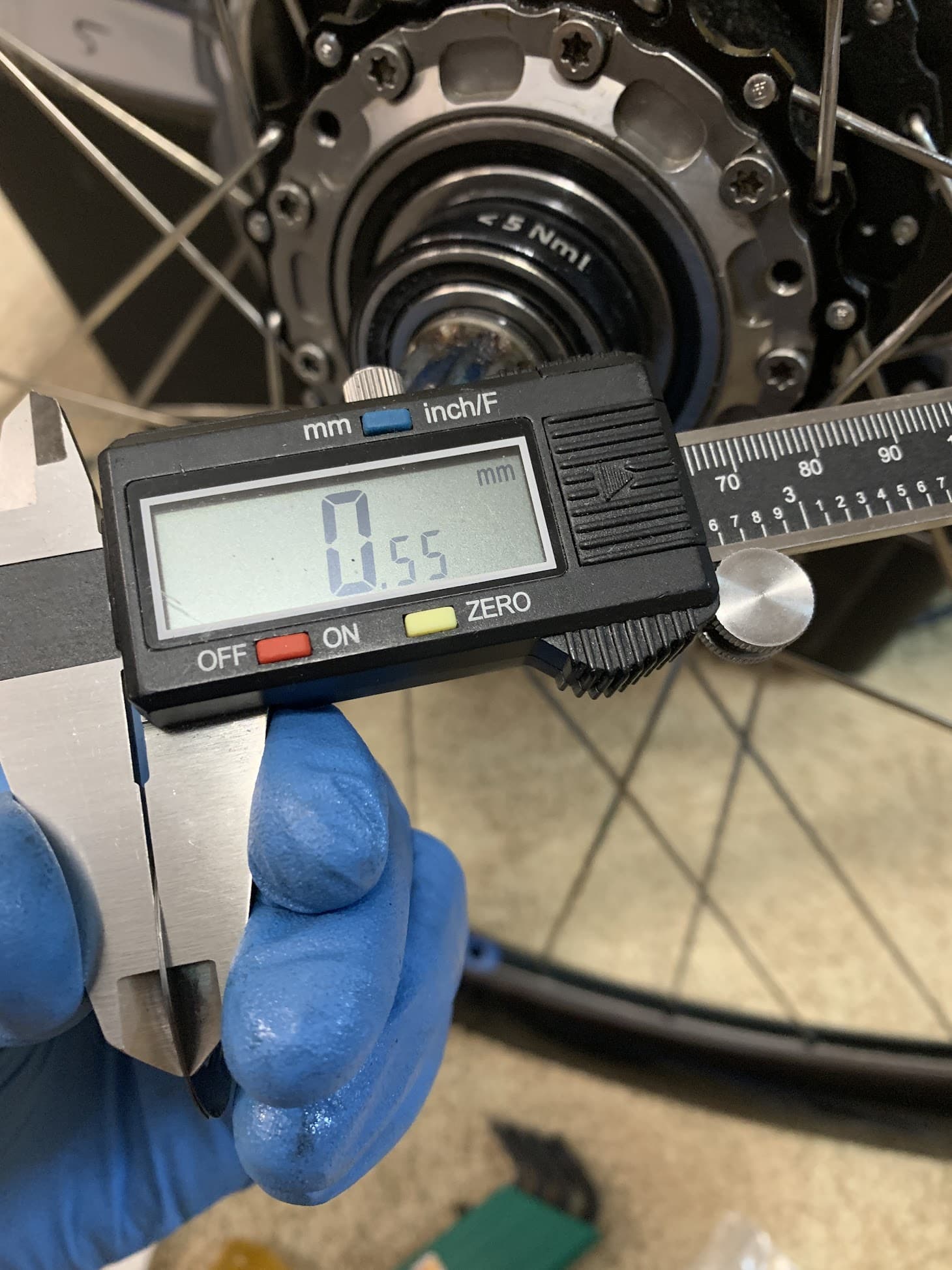

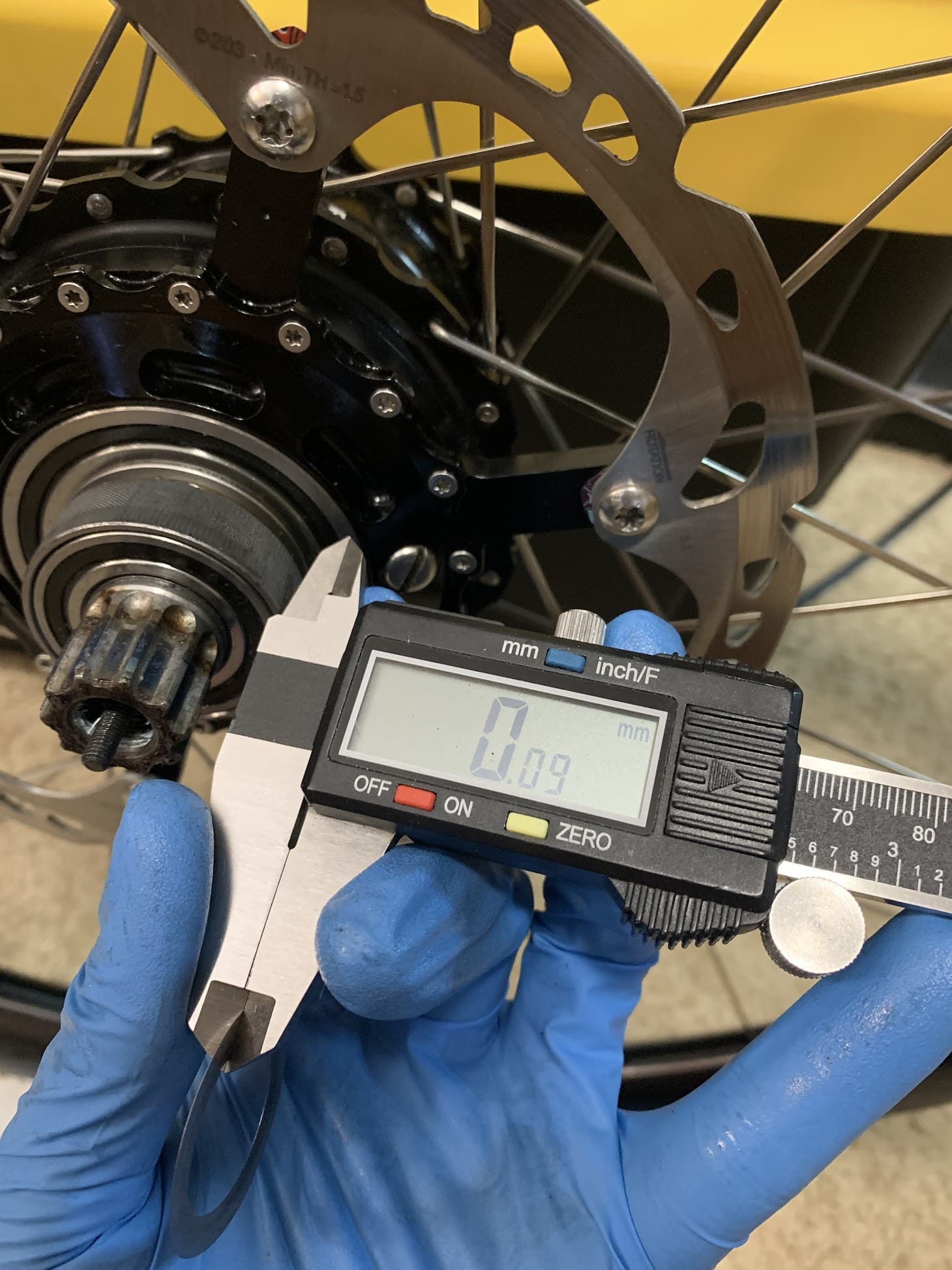

Does someone know how many of the thin shims are needed for <M399 models between the bearing and snapring?
Under the snap ring on the left side, I have one 0.10mm shim.
On the right side, I thought there were 2 when I disassembled it in the past.
However, I just found that I have 4… 3 are 0.1mm, and one is 0.2mm. I’m not sure if there were always 4 and they had just stuck together, or if I messed up somewhere.
With 0.1mm shim on the right side, I can noticeably move the axle left and right.
With 0.2mm, I can still move the axle a tiny bit
With 0.3mm, it feels like there is zero movement
With 0.4mm, it feels like there is zero movement. maybe a bit less than 0.3mm
With 0.5mm, same as 0.4mm.
Behind the frame bearings, there are 2 thicker 0.5mm shims for both left and right. Those I think I have correct.

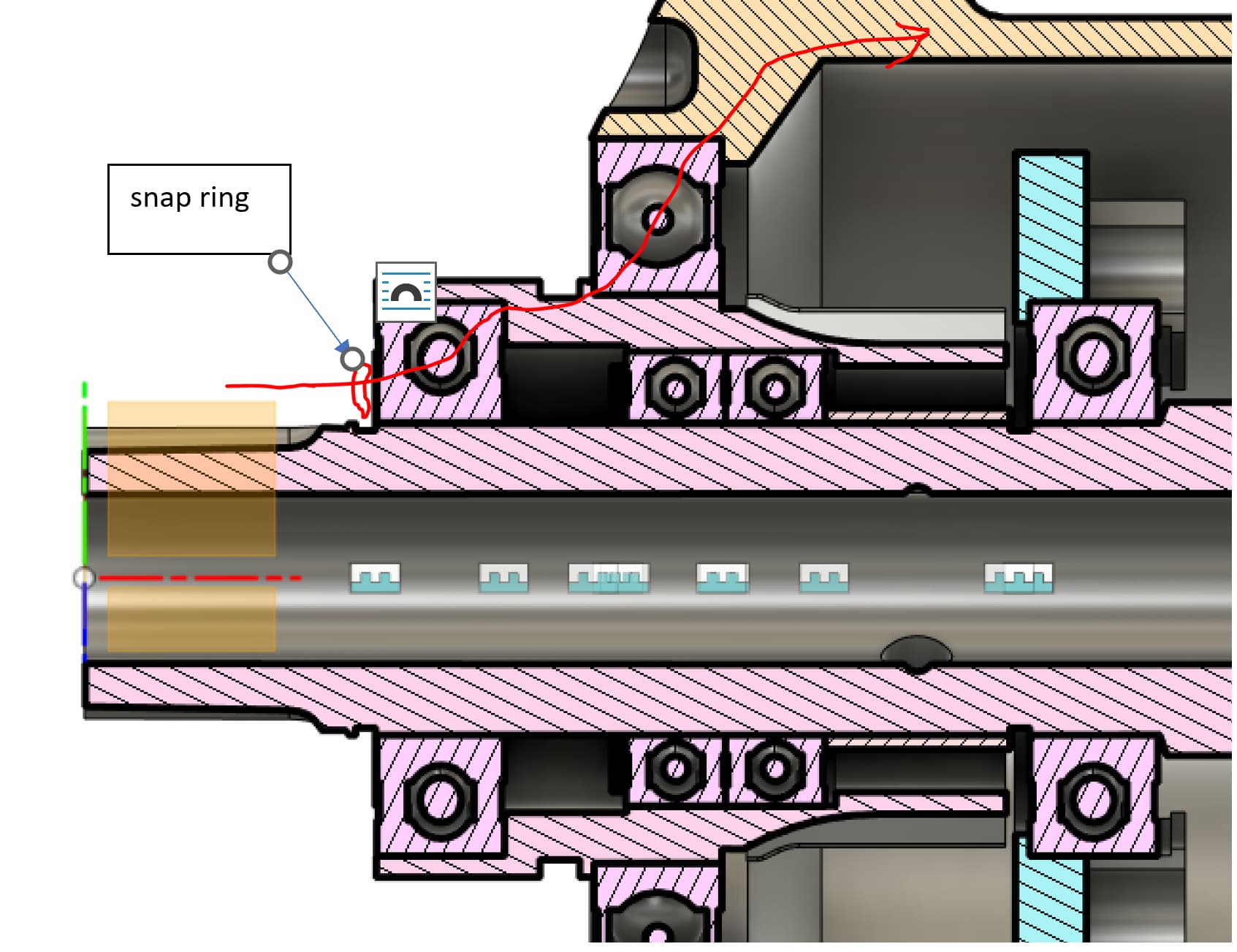

I think the snap rings and shims just “preload” the frame bearing + large hub bearing, keeping the hub shell/axle/sun gear from sliding left and right?
Cross section image showing left side sideload path through snapring, 0.1mm shim, 42mm bearing, sun gear, 62mm bearing, hub shell.
I’m pretty sure, that te actual amount of shimming is determined by the tolerances of the other components and thus is individual for each hub.

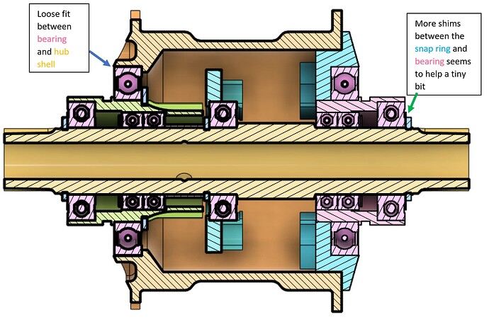

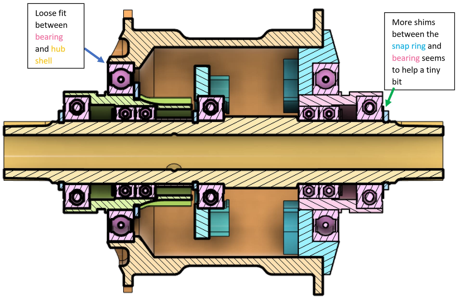

I just noticed that I have significant lateral rotational play.( I’m not sure what the correct term would be for this). Not the crank rotational play I normally hear about.
When I hold the frame, I can wobble the wheel side to side. I can feel movement between the hub sheel and the frame.
Less shims makes it a tiny bit worse, but even with all the shims, there is still this play. I also don’t think I can add anymore, as it is difficult to get the snap ring to fit into the groove as it is.
I’m assuming it is movement of the large hub bearings?
I noticed the large bearing around the sun gear fits very loosely into the hub sheel Is hits normal?

Diagram of where I am referring to.

If i rememember it right, Florian used to glue in bearings when they had play. I think he used Loctite 638 or 641 for this. To shim it for a nice press fit, the gap will be too small at the moment.
Perhaps counterintuitively under-tensioned spokes are at risk of breaking due to fatigue – see my comment in the post linked below and the accompanying video.
Do you mean to first try loctite? And that shim is too thick?
The radial movement I see is very small. It’s hard to tell how much it is. You could try fitting foil or something like it but it will be pretty hard to install if even possible. The Loctite bearing glue is especially developed for loose bearing seats and fills gaps up to 0.25 mm. So it might work. But I have no idea how long it may last. You should definitely check out how to remove the adhessive if it fails.
I had one of the first M8xx batch and there was an issue with a loose bearing seat. Florian glued the bearing i just as described. Unfortunately it did not last too log and in the end, Florian had to replace the part with one that had a tighter seat.
A good alternative (but expensive) would be to repair / recondition the bearing seat, may it be with hard chrome plating, plasma coating or whatever.
