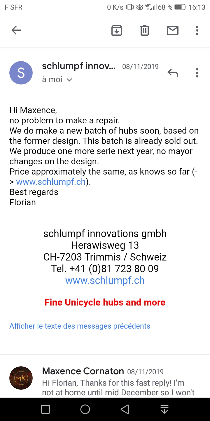

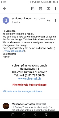

Hubs are still produced, a few at a time. Florian told me a year ago there should be new series soon.

You should probably try to send it back to Florian Schlumpf so I can fix it. If you’re in the USA, you can send it to @jaco_flans (Canada) ![]()
I am in the US so I will try contacting @jaco_flans - thanks!

As @Maxence said, I do complete maintenance on them. I’ve replied to your message on Facebook @Bruce_Dawson!
