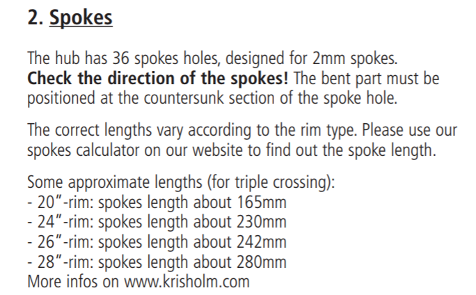

I have now built the Schlumpf/29 Dominator2 wheel I was writing about earlier. My concern now is whether lacing the wheel with the trailing spokes running on the outside of the flange will affect the hub. You can see the whole discussion from post #7 in the wheelbuilding thread I started in the articles/tutorials section (Wheelbuilding - experience of a novice who didn't want to read a book). What have other Schlumpf owners done? Thoghts on the subject?

I looked for a Schlumpf tech doc on lacing (I was looking to see if asked for a specific lacing pattern, such as Rohloff’s 2x) but I didn’t see any information. The only info was to put the spoke head in the recessed side of the flange hole and the spoke lengths recommended were for 3x lacing. I think this would be more important than trailing/leading spokes. (If you go look around at a whole bunch of bicycle wheels, you will see lots of different patterns of trailing and leading spokes on either side of the bike and they all work reasonably well, albeit, there might be a “best” way, esp. with disc brakes.) If it were a bigger issue, it would be a safety concern with riding your front wheel “backwards” on a regular bicycle, but mechanics are more worried about what side the quick-release is on instead of the direction of pulling spokes on the wheel.
It looks like I got this wrong. I need a few days break from this project now. I also struggled quite a bit with the disc brake. Thanks for the info.
No - if you’ve got the spoke head on the non-recessed side you’ve got it right - that advice is wrong (and the quoted advice from Schlumpf directly contradicts it - you put the head on the non-recessed side so that the bend is on the recessed side).
Though I thought the design had changed so that both sides are now countersunk, or do you have an old hub?
I bought my Schlumpf hub in 2011. It is number 0477 - I don’t know which version that is. I looked at it yesterday and it was hard to tell with the spokes in place. I’ll take a picture later, maybe someone here can tell if it is right or wrong.

I think it’s at least the second revision, the sturdy ones with more bearings than the first couple of series. I also think it’s a version where the spoke holes have a recessed area drilled on both sides of the hub. A photo will indeed clarify.

Here are pictures of my hub. Looks like I didn’t get the spokes in the same way as it was before(?). The spoke holes seems to be countersunk on both side of the flange. I’m not 100% sure.

I got the valve hole right, and unless someone can see from the pictures that it is done wrong, I’ll keep it as it is.
Looks fine.
