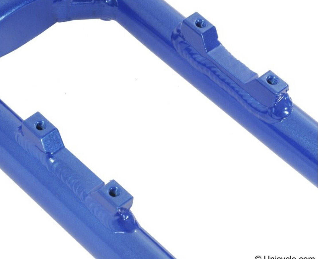

Just so you’re 100% sure. Your frame will need sometimes that looks like this for Magura and your rim will basically need to be a Dominator2/Stealth Nimbus rim so there’s somewhere for the brake to land its pads.

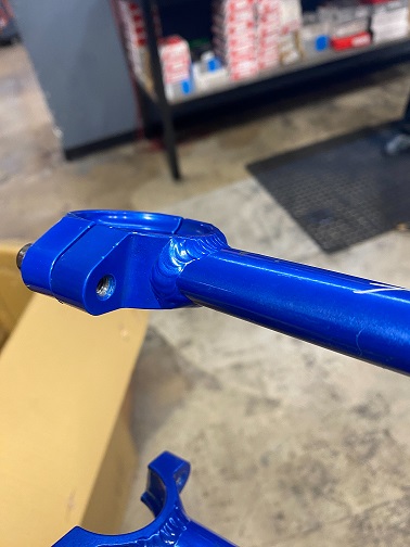

Sadly that looks like it only has the routing for brake hose.
Does it have two tabs for disc brakes on the left and right?
I am guessing it is the new version - so it would be ready for an inboard disc which what the BrakeFast system sets up.
Ya, I had a feeling it wasn’t that. Yes, 2 tabs for disk. This is from the shipment that Unicycle.com got in December, so it would be the new version.
