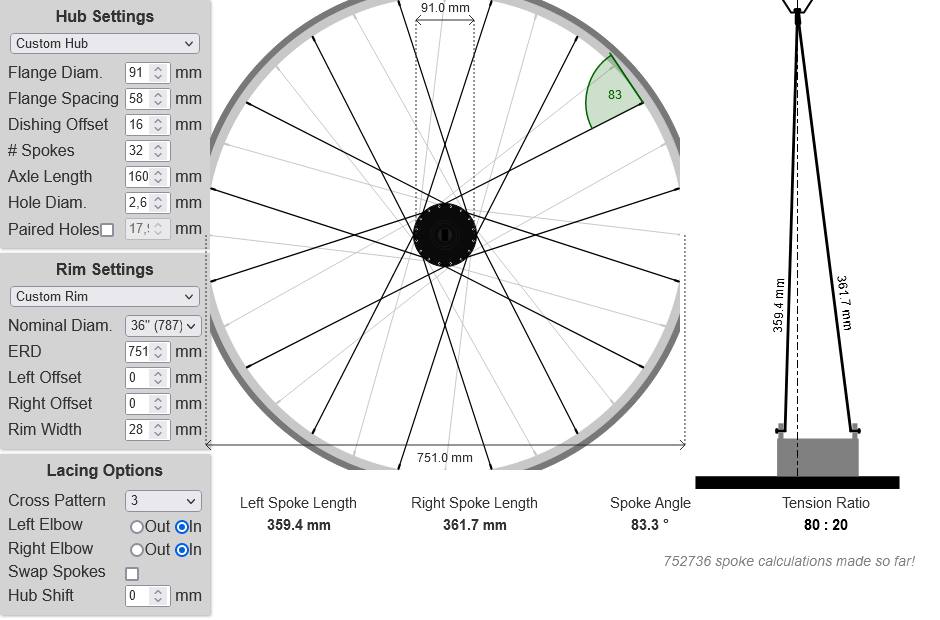

Has anyone already calculated how long should the spokes be for the Braus rim/100mm 2022 Schlumpf hub setup?
Here’s what I find, but I’d like a double check:
The values I used come from:
  • UDC UK Spoke Length Calculator: flange diameter, spoke hole diameter, rim ERD, rim width;
  • Schlumpf’s 2022 hub handbook: flange spacing (C), dishing offset (I guess it’s D), axle length (A, but does not matter).
The numbers seem fine as they are a little bigger than those for the BrakeFast setup - ~2mm longer - but I’m not expert.
I got similar numbers. I have 359mm and 361mm spokes in the mail.
Thanks! My local Unicycle shop seems to have thois size. My wheel will be easy to build, then. The hard part for me will be to drill my frame. I’m afraid of doing it wrong :fearful:
I think the Dishing Offset should be about 8mm rather then 16mm. At least that is the difference (from this drawing) I get from the center of the flanges to the center of the bearings.
