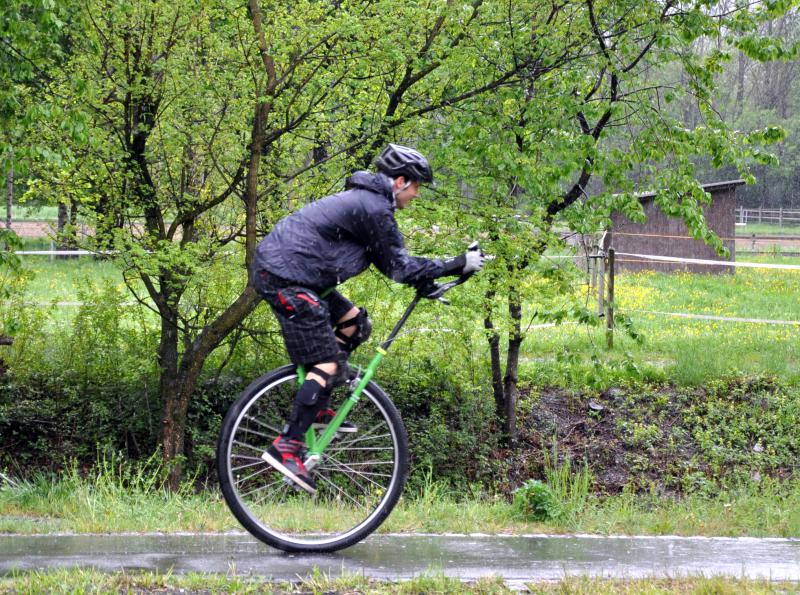

your handlebars are looking high up not a real race looking
But therefor i have to see it with the wheel.
and on my v-setup the body position is a little on the low side so have to adjust it some more.
sander – how has your frame been? is it working out well?

In looking at your frame, I noticed the bearing will not be parallel to the ground, but instead, tilted forward, in line with the KH36 frame it was attached to originally. Is your 29er like this, too? Has it presented any problems?
Perhaps ideally, the bearing should be parallel to the ground, perpendicular with the imaginary line through the center of the “V”, if they ever become mass-produced. (Hint, hint, Kris?)
Edit: What’s the mass of that beast?
Why do you think it would matter? The bearing doesn’t really have a “top” - we just fit them randomly into the bearing holders after all, they should be completely radially symmetrical in all directions. I suppose the weight would not be held centrally by the bearing holder, but I can’t see that as a problem (when it’s done up it’s pretty much a complete circle anyway).
Or did you mean it purely aesthetically?
Rob
at the 29" it’s the same, no problem so far. it’s also in different angles, it depens how i ride (more upright or not), the same for the hight of the handlebar…
In Turtle’s case, it seems fine, because he’s got plenty of miles on his V-Guni 29.
A geared-36" wheel will likely exert more force on the frame/bearing setup. I think the frame/bearing-holder could be affected in a non-straight-down set up, though I’ve no idea whether the affect is greater than a negligible one.
There would be different properties between a purely downward force, (which wouldn’t put any pressure toward forcing the bearing holders open) and Turtle’s setup, which looks like it would be putting some force into popping them open at the “top” side.
Consider the extreme case, with bearings mounted right/left instead of up/down. Wouldn’t there be a fair amount of force wanting to open up the bearing halves? Would there be any deformation of the aluminum bearing holders? Would there be some affect on the hub bearing? Maybe even my hypothetical case would be plenty strong and never be a problem. Most likely, as in Turtle’s case, where there’s much less than in the left/right scenario, it’s not an issue.
[/uneducated hypothesis]

Yes its working very good;)
The new riding position is way bether than the ‘‘traditional’’ position of riding a unicycle.
Alsow a big inprovement is that you can ride with a bicycle seat wich is way bether for road riding.
I’am now looking if i can make a new frame with a different angle because this one is a little on the big side, and its heavy because its made from sollid aluminium.
I’am currently working at a bicycle company so there is a chance that i can make a prototype. working on the development floor.
alsow the new sturmey archer 3 speed fixed hub will be availibe within a couple of weeks for this company we already orderd one.
