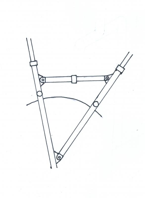

I understand your points. Adjustability does not necessarily mean a lack of rigidity (although it usually means a price to pay in weight / bulk). I’m also not sure how much actual force can be put into a handlebar on a uni, as the force will naturally require something to react against without totally throwing the COG.
Pinned / bushed joints would allow the front unit to be dismantled just by pulling safety pins. Seat and handlebar stem adjustment, combined with link adjustment, would allow changing reach easily. The link may also be capable of absorbing some of the energy of a crash. without permanent damage.
As you point out, though, once the ideal is obtained (which may take some time, as it takes a while (for me, anyway) to adjust the brain to a new position.

I see your point. The joint in the middle of your near-horizontal tube would be as rigid as the seat post clamp that we all take for granted. The four hinge points (the bottom one in the picture is really one on each side) would need to be rigid too, though. It’s easy enough to have them without play in the drawing plane, but you would also want to minimise lateral flex of your frame when you push hard on the pedals.
But hey, try it out by all means!

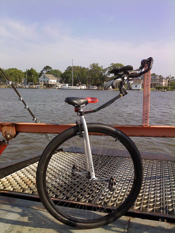

Hi All;
My exploration setup:
Improvised a mast out of a bike rack. Used as a front extension to mount aerobars, and as a seat post clamp. This allow me to lower my seat to a minimum ( I’m 5’ 5" short). Aerobars for riding and handle bars for mounting. I added recently an adjustable stem extension to try different lengths and heights on my aerobars.
After several experiments and considerations, and reviewing few threads about frames and positions, I’ve come to the conclusion that this is a lot more about the position than all the hardware variables together.
True, as KH stated on his post, no matter what the configuration is, your CG will reach some point near by the wheel axe anyway for balance. I little frontward when speeding up, a little backward when slowing down. That’s pure physics applied on the unicycling riding nature.
Lower positions gave me backaches and made little “wheel to aerobar misalignment” or side gusty wind hard to compensate while riding.
A more “T-Rex” position, yes as the dinosaur, gave me better comfort on long rides. Therefore I’m baptizing my contraption as the"T-Rex_Unicycle", following the logic of those baptizing “jirafe Unicycle” the one allowing you ride high to the tree top.
If you look my picture videos, my position is not too different than the one on the pictures for the green V frame, but my forearms again, are a lot closer to the T-Rex arm position. More aerodynamic, and definitely out of the way in case UPD.
I’ve also keep mounting handles to help me to get started.
I will be looking for seats optional to my current road bike seat. The one I have its OK, but is the first one I’ve tried and I’m willing to try a few more.
I will post a video next…

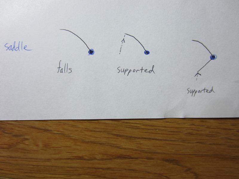

If I have a soft noddle, and i want it to be supported at an angle(left scribble in my picture) it would fall. If it was a hard noodle, it would still fall/rotate around the saddle. Since the CG of the noddle is on the left side of the pivot point, it needs to be supported somehow.
Given that unicycles have a much higher cadence to go fast and less pushing on the pedals, compared to bikes(maybe different for geared unicycles?) , we need to have handlebars to support bent over upper body mass if our saddle support point is behind the hub/wheel contact point. This is in conflict with good biking posture.
