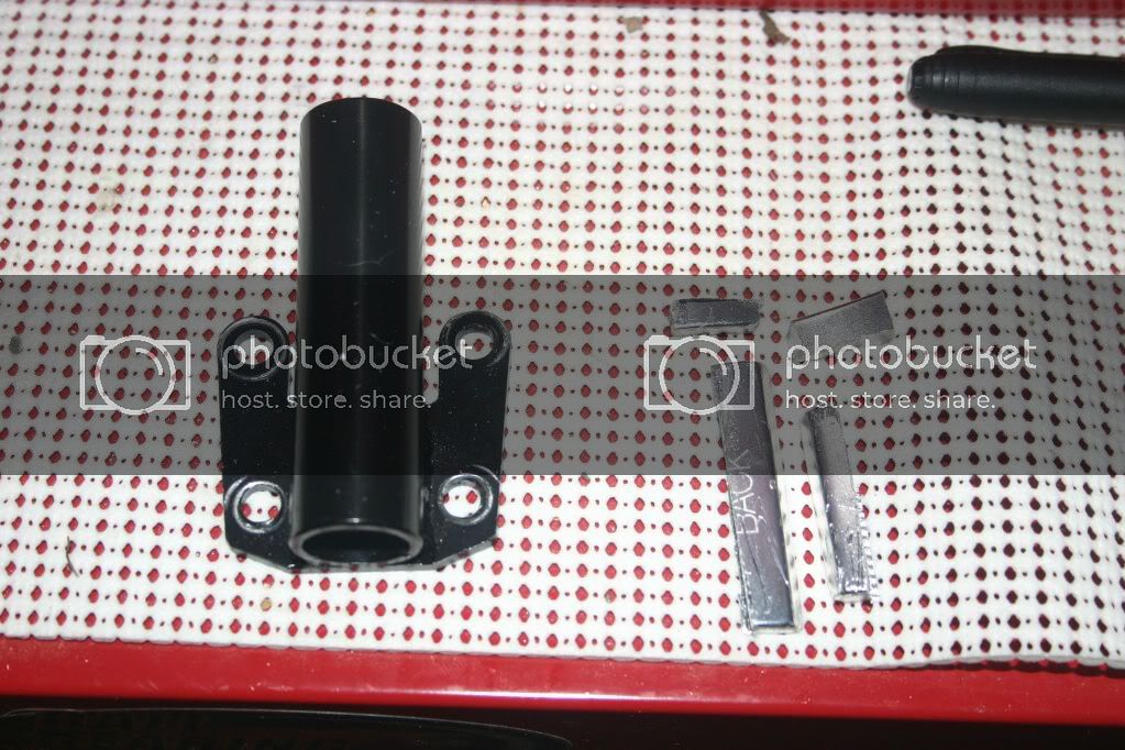

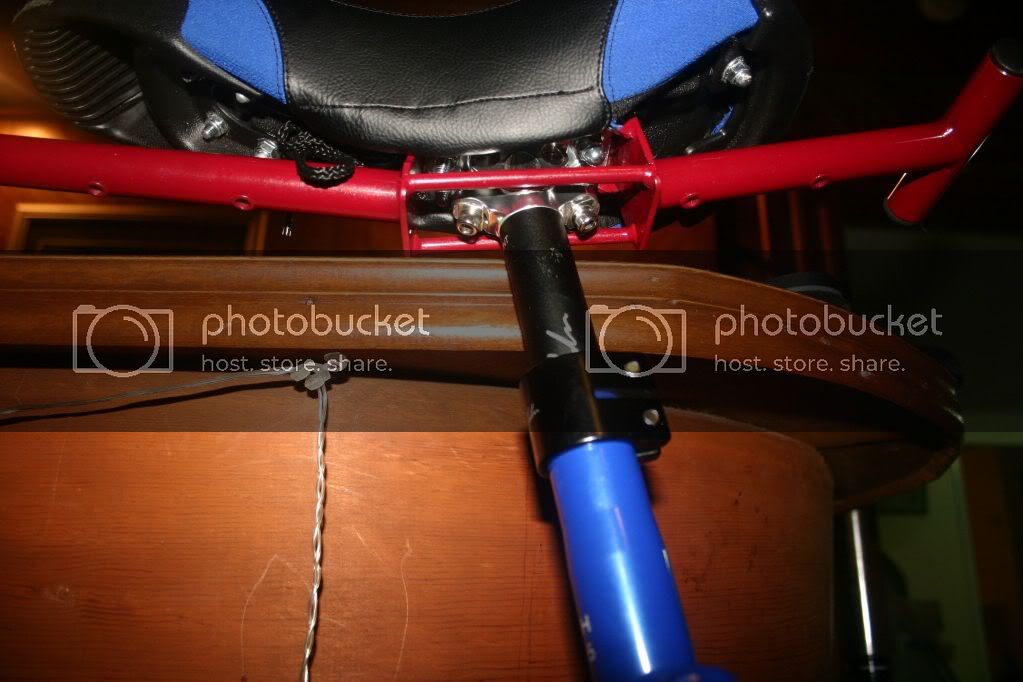

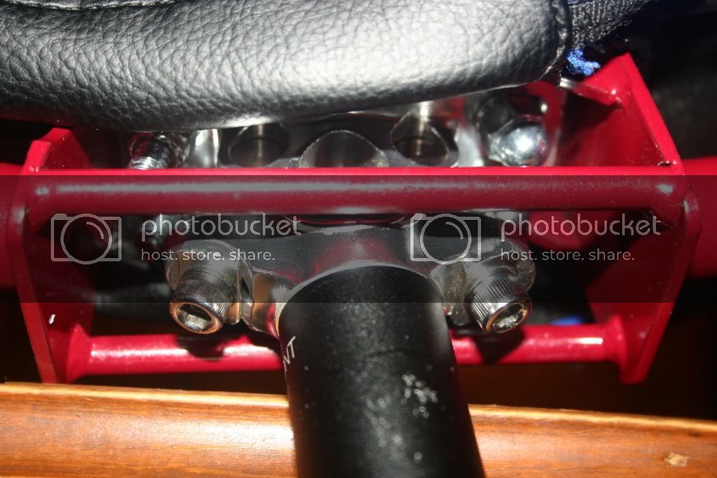

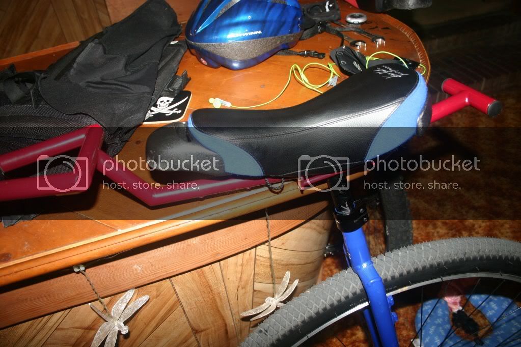

KH/T7 Mod
Got a T7 last week and decided to try to adapt it to my KH36 with an 08 seat. It’s $12 + shipping for a KH rail post, but only $0.44 for 4 new 1/4" X 20 carriage bolts. Add that to 20 minutes worth of measuring with some verniers and 4 Sawzall cuts and it all works beautifully.
My original plan was just to lop off the bottom rails on the T7 and slide the KH base in, but I abandoned that idea as soon as I actually saw the handle in real life.
Stuff that had to come off:
