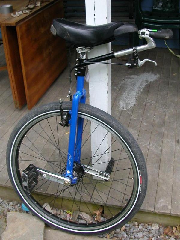

Here’s a snapshot of my KH29 guni road handlebar setup. The handles don’t stick out far enough for a real tuck, but otherwise, they provide very comfy hand positions. The brake is a bit of a reach, but not too bad.
The pieces are (left-to-right), a Tandem stoker stem, a long-neck handlebar stem, a short piece of handlebar, and two bar ends.
