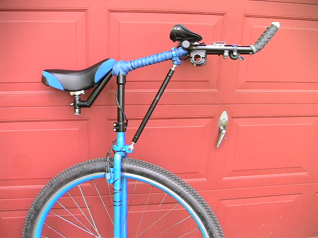

At Brycer: where is your brake lever? I just don’t see it anywhere :thinking:
HS22/HS33 brake
Its described and shown here in this thread:
Certainly not rocket science to make one of these up, you just have to get the right parts.
